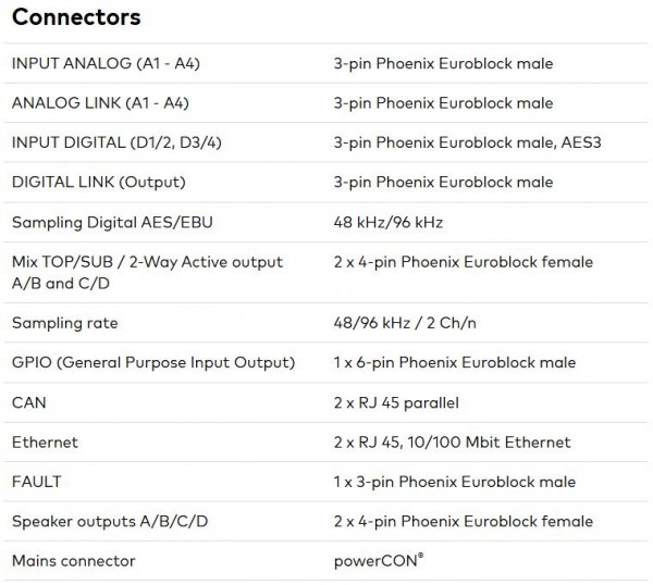

    주요사양 Installation specific four channel amplifier

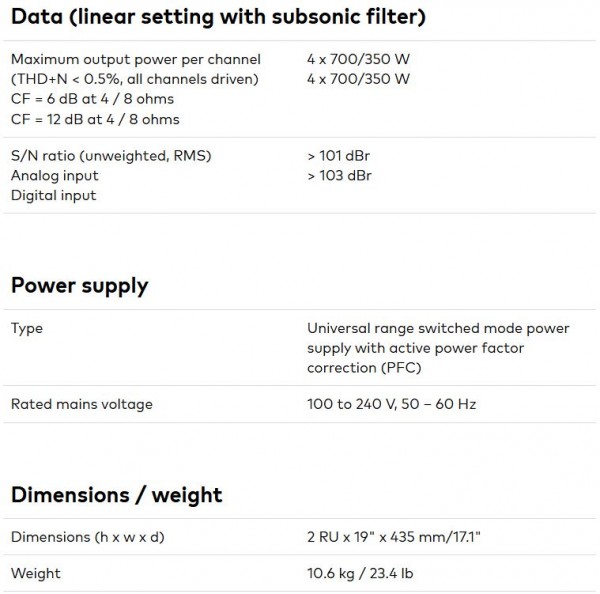

    주요사양 Maximum output power 4 x 700 W into 4 Ω
    주요사양 All current d&b loudspeaker setups except A-Series, J-Series, SL-Series, V-Series, M2, B22-SUB
    주요사양 5 freely assignable GPIOs (General Purpose Input Output) + General fault

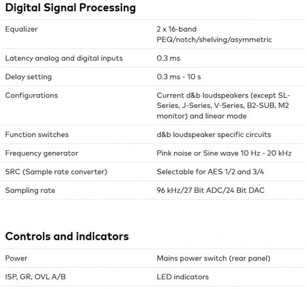

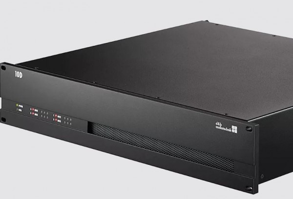

    The 2 RU, four channel 10D amplifier is designed for permanent integration with applications that require lower Sound Pressure Level (SPL) capabilities. This device contains extended input management functionalities with separate Input Gain control for each input channel, General Purpose Inputs/Outputs (GPIO) and a General Fault connector. Enhanced system status monitoring functions such as Input and Load monitoring ensure suitability in an emergency situation. The 10D shares the same Digital Signal Processing platform as the latest generation of four channel d&b amplifiers, providing configurations for smaller d&b loudspeakers as well as a linear mode. For larger applications comprising the A-Series, J-Series, SL-Series, V-Series, the M2 monitor, the B22-SUB and systems which require a higher SPL output, the 30D installation specific amplifier is required. The DSP integrated within the 10D incorporates comprehensive loudspeaker management, switchable filtering functions as well as user definable equalization and delay capabilities. This includes two 16-band equalizers, providing optional parametric, asymmetric, shelving or notch filtering and up to 10 s (= 3440 m/11286 ft) signal delay, all of which can be applied independently to each channel. The 10D is accessible via the d&b Remote network, either via Ethernet using the Open Control Architecture protocol (OCA) or CAN-Bus using RJ45 connectors. The 10D is controlled using the integrated web interface, which enables access via a browser, or using the d&b R1 Remote control software. The device itself contains LEDs to display power, input, data and mute status. The LoadMatch function integrated within the 10D amplifier electrically compensates for the properties of loudspeaker cable used. The 10D incorporates Class D amplifiers utilizing a power supply with active Power Factor Correction (PFC) suitable for mains voltages 100 V/127 V, 50 – 60 Hz and 208 V/240 V, 50 - 60 Hz and maintains a stable output when used with weak or unstable mains supplies. Input and output connectors are all Euroblock sockets.

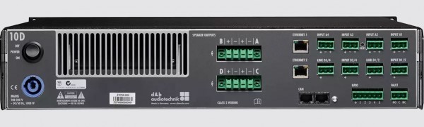

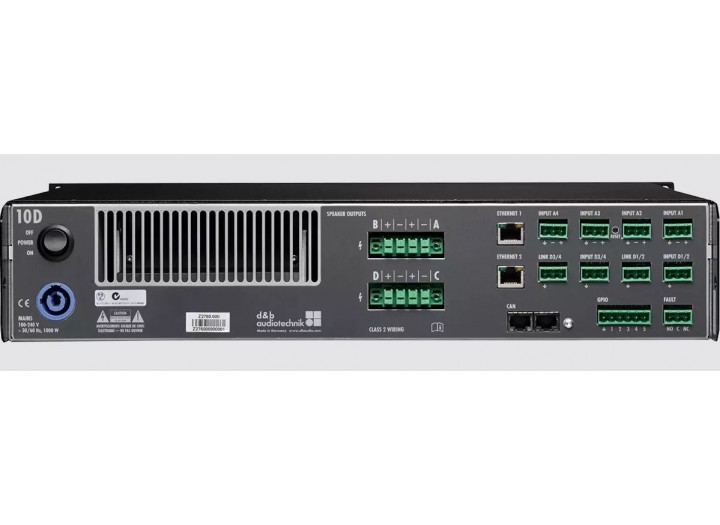

    The 10D and 30D amplifiers provide four analog inputs, four digital AES/EBU channels through two inputs as well as separate analog and digital links, all on Euroblock connectors. The digital input pairs contain independent Sample Rate Converters. Each input features a separate input gain, meaning sources with various output levels can be used without requiring an external mixing device. All eight individual inputs can be used simultaneously, then summed and routed to any of the four outputs.

    The d&b installation amplifiers incorporate separate Euroblock connectors for General Purpose Input / Output (GPIO) and a fault contact. The GPIO connector offers five pins providing additional digital control lines which can be configured to be either an input or output. This enables the use of external devices to control and detect certain functionalities within the 10D and 30D amplifiers. The GPIOs can be configured to Power the device, mute individual or all channels, change the AmpPreset or to check the Mains Voltage, Power or individual channel status. The separate fault contact allows a general device error to be remotely indicated.
