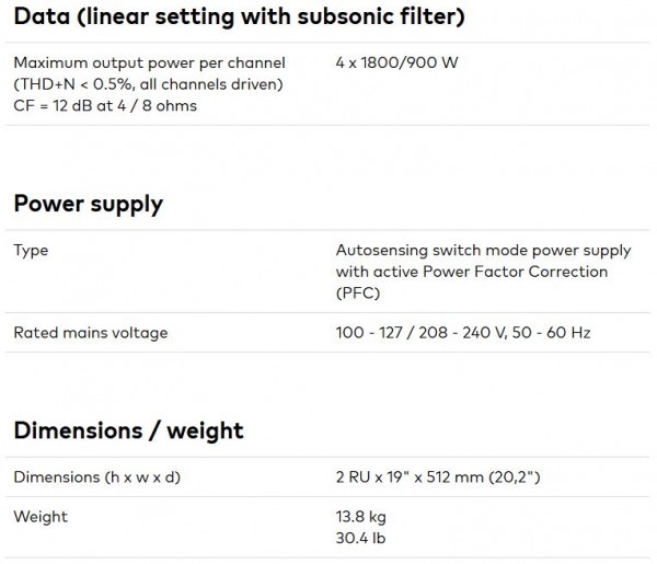

| 주요사양 | Maximum output power 4 x 1800/900 W into 4/8 Ω |
| 주요사양 | Maximum output voltage/current 120 Vpeak / 35 Apeak |

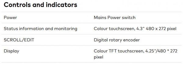

| 주요사양 | Operating and Monitoring display, colour TFT touchscreen, 4.3" / 480 x 272 pixel |

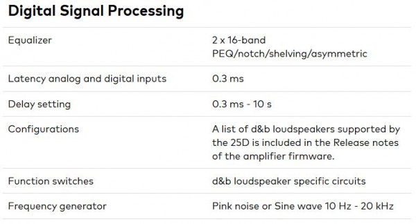

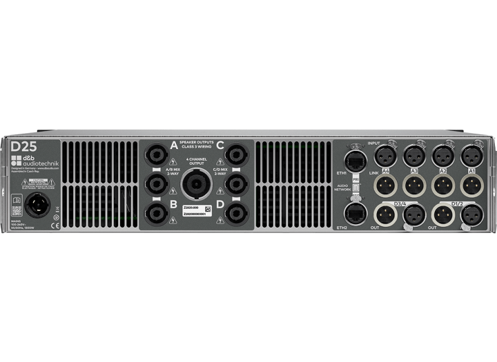

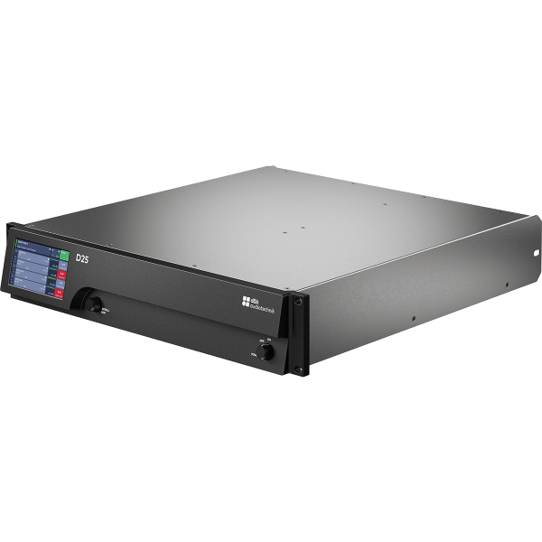

The 2 RU D25 amplifier provides power output optimized for smaller high-efficiency d&b mobile systems, while offering the same full DSP feature set as our high-output amplifiers.
A list of d&b loudspeakers supported by the D25 is included in the Release notes of the amplifier firmware.
The D25 has a dynamic range of 112 dB (unweighted) and incorporates comprehensive loudspeaker management, switchable filtering functions as well as user definable equalization and delay capabilities.
Onboard enhanced energy saving features, power efficiency and Automatic Wake up enable you to save on resources and meet environmental responsibility requirements.

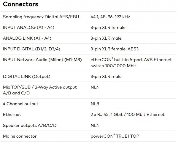

The D25 incorporates up to 16 input channels with eight Milan audio inputs, four analogue inputs, and four AES3 channels.
The D25 utilizes a switch mode power supply with automatic mains range selection and active Power Factor Correction (PFC) to produce a clean current draw and ensure stable and efficient performance under adverse mains conditions.
Access to the d&b Remote network is via Ethernet using the Open Control Architecture protocol (AES70 / OCA). The D25 is controlled using the integrated web interface, which enables access via a browser, or using the d&b R1 Remote control software.
For applicable d&b loudspeakers, d&b LoadMatch enables the D25 amplifier to preserve tonal balance when cable lengths of up to 70 m (230 ft) are used.
