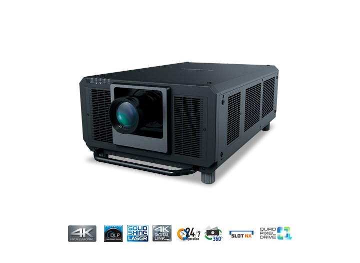

    LASER PROJECTOR 3 DLP Laser Projector
    Model PT-RQ32K
    주요사양 5120 x 3200 (WHXGA) Resolution
    주요사양 20000 Contrast Ratio
    주요사양 27000 ANSI Lumens

    LENSOptional powered zoom/focus lenses
    Light sourceLaser Diode Laser class 1

    InstallationCeiling/floor, front /rear, free 360-degree installation

    Terminals | Expansion Slotx 2 (SLOT 1, SLOT 2), SLOT NX(Compatible with Optional Board)
    Power cord length3.0 m (9 ft 10 in) ft
    Cabinet materialsProcessed metal parts, Molded plastic
    Dimensions (W x H x D)700 x 418*6x1,250 mm
    (27-9/16 x 16-15/32 x 49-7/32 inches) (with protrusion parts)
    700 x 373*7x1,070 mm
    (27-9/16 x 14-11/16 x 42-1/8 inches) (without protrusion parts)
    Weight*883 kg (183 lbs)

    DLP™ chip | Panel size22.9mm (0.9 inches) diagonal (16:10 aspect ratio)
    DLP™ chip | Display methodDLP™ chip x 3 (R, G, B), DLP™ projection system
    DLP™ chip | Pixels4,096,000 (2560 x1600) x3, total of 12,288,000 pixels
    Brightness27,000 lumens (center)
    Technology3-chip DLP Laser
