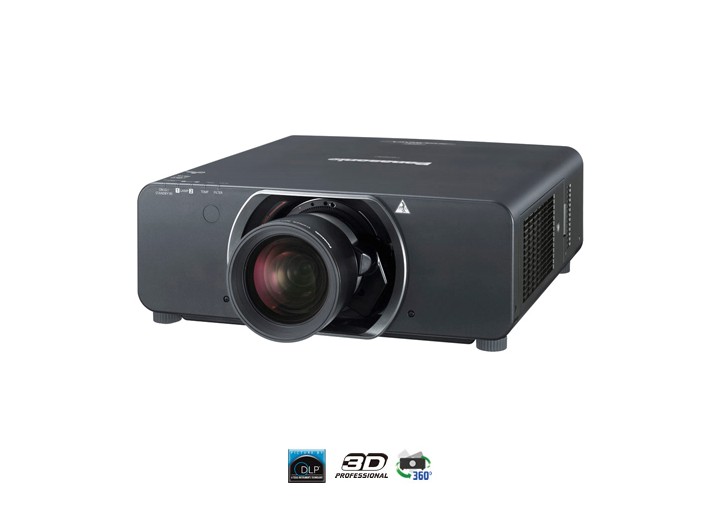

    DLP PROJECTOR 3CHIP DLP Projector
    Model PT-DZ13KE
    주요사양 Active 3D projection capability
    주요사양 Optional upgrade kit (ET-UK20) featuring new Geometry Manager Pro for specially shaped screens is available
    주요사양 A compact body with 12,000 lm* of brightness and high picture quality.
    주요사양 A maximum 2,500-hour lamp replacement cycle and a low power consumption of 1,000 W supports the total cost of ownership
