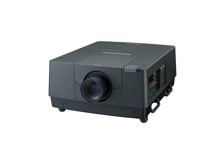

    LCD PROJECTOR 3LCD Projector
    model PT-EX16KE
    주요사양 Excellent system expandability
    주요사양 Pure Colour Control – for superb colour reproduction, and rich overall colour expression
    주요사양 Multi-Screen Support – for seamless connection to multiple screens
    주요사양 16,000 lumens brightness – for sharp, crisp, large-screen projection in XGA resolution
    주요사양 High reliability for long-term use
