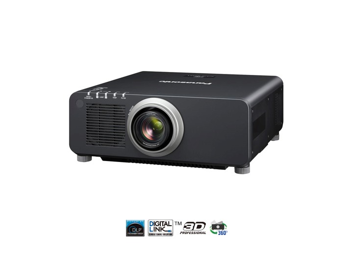

    DLP PROJECTOR 1CHIP DLP Projector
    model PT-DW830E
    주요사양 Filter-less dust-resistant optical engine
    주요사양 8,500lm brightness
    주요사양 WXGA (1,280 x 800) resolution
    주요사양 Excellent image quality with new dynamic RGB booster and vivid colour control
