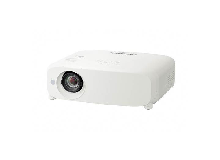

    LCD PROJECTOR 3LCD Projector
    Model PT-VW530
    주요사양 Digital LINK makes ceiling installation simple and inexpensive
    주요사양 Project onto Curved Surfaces
    주요사양 Lamp and filter replacement extended to 7,000 hours
    주요사양 Distortion-Free Vertical Lens shift
    Power supplyAC 100–240 V, 50/60 Hz (other countries)
    Power consumption362 W
    Standby power consumptionStandby Mode (Eco)*10.4 W
    Standby Mode (Normal)8W
    LCD panelPanel Size0.59 inches (1.50 cm) (16:10 aspect ratio)
    Display MethodTransparent LCD panel (× 3, R/G/B)
    Pixels1,024,000 (1,280 × 800) × 3, total of 3,072,000 pixels
    Lens1.6x manual zoom (throw ratio: 1.2–1.9:1), manual focus F 1.60–1.90, f 15.31–24.64 mm
    Lamp270 W UHM lamp × 1
    Screen size (diagonal)30–300 inches
    Brightness*25,000 lm (ANSI) (input signal: PC, lamp power: Normal, picture mode: Dynamic)
    Center-to-corner uniformity*285%
    Contrast*210,000:1 (all white/all black) (input signal: PC, lamp power: Normal, picture mode: Dynamic, Iris: on)
    Resolution1,280 × 800 pixels (Input signals that exceed this resolution will be converted to 1,280 × 800 pixels.)
    Scanning frequencyHDMI525i (480i)*3, 625i (576i)*3, 525p (480p), 625p (576p), 750 (720)/60p, 750 (720)/50p, 1125 (1080)/24p, 1125 (1080)/24sF, 1125 (1080)/25p, 1125 (1080)/30p, 1125 (1080)/60p, 1125 (1080)/50p, 1125 (1080)/60i, 1125 (1080)/50i
    Displayable resolution: VGA to WUXGA (non-interlace), Dot clock frequency: 25 MHz to 162 MHz
    RGB (analog)fH: 15 kHz – 91 kHz, fV: 24 Hz – 100 Hz, dot clock: 162 MHz or lower
    YPBPR(YCBCR)fH: 15.73 kHz, fV: 59.94 Hz [525i (480i)]
    fH: 15.63 kHz, fV: 50 Hz [625i (576i)]
    fH: 31.47 kHz, fV: 59.94 Hz [525p (480p)]
    fH: 31.25 kHz, fV: 50 Hz [625p (576p)]
    fH: 45.00 kHz, fV: 60 Hz [750 (720)/60p]
    fH: 37.50 kHz, fV: 50 Hz [750 (720)/50p]
    fH: 33.75 kHz, fV: 60 Hz [1125 (1080)/60i]
    fH: 28.13 kHz, fV: 50 Hz [1125 (1080)/50i]
    fH: 28.13 kHz, fV: 25 Hz [1125 (1080)/25p]
    fH: 27.00 kHz, fV: 24 Hz [1125 (1080)/24p]
    fH: 27.00 kHz, fV: 48 Hz [1125 (1080)/24sF]
    fH: 33.75 kHz, fV: 30 Hz [1125 (1080)/30p]
    fH: 67.50 kHz, fV: 60 Hz [1125 (1080)/60p]
    fH: 56.25 kHz, fV: 50 Hz [1125 (1080)/50p]
    Video/S-VideofH: 15.73 kHz/15.63 kHz, fV: 59.94 Hz/50 Hz (NTSC/NTSC4.43/PAL/PAL60/PAL-N/PAL-M/SECAM)
    Optical axis shiftVertical 0–+48% from center of screen (manual), U/D ratio on top end: 49:1
    Keystone correction rangeVertical: maximum ±35° (auto/manual, input: WXGA),
    Horizontal: maximum ±35° (manual, input: WXGA)
    InstallationFront ceiling / Front desk / Rear ceiling / Rear desk
    TerminalsHDMI IN: HDMI 19-pin × 2 (Deep Color, compatible with HDCP), audio signal: Linear PCM [sampling frequency: 48 kHz/44.1 kHz/32 kHz]
    COMPUTER IN 1: D-sub 15-pin (female) x 1 (RGB/Y • PB (CB) • PR (CR)/S-Video)
    COMPUTER IN 2/MONITOR OUT: D-sub 15-pin (female) x 1 (RGB/Y • PB (CB) • PR (CR) (input/output switching))
    VIDEO IN: Pin jack x 1
    AUDIO IN 1: M3 jack (L/R) x 1
    AUDIO IN 2: M3 jack (L/R) x 1, compatible with MIC input
    AUDIO IN 3: Pin jack (L/R) x 1
    AUDIO OUT: M3 jack (L/R) x 1 (monitor out: variable)
    SERIAL IN: D-sub 9-pin (female) x 1 for external control (RS-232C compliant)
    LAN: RJ-45 × 1 for network connection, 10Base-T/ 100Base-TX, compatible with PJLink™
    Built-in speaker4.0 cm round shape × 1, output power: 10 W (monaural)
    Operating noise*237 dB (lamp power: Normal), 29 dB (lamp power: Eco)
    Dimensions (W × H × D)389 × 125*5
    × 332 mm (15-5/16 × 4-29/32*5 × 13-1/16 in)
    Weight*4Approximately 4.8 kg (10.6 lbs)
    Operating environmentOperating temperature: 0 °C–40 °C (32 °F–104 °F)*6
    (altitude: less than 1200 m), 0 °C–30 °C (32 °F–86 °F) (altitude: 1200 m–2,700 m) Operating humidity: 20 %–80 % (no condensation)
    Supplied accessoriesWireless remote control unit × 1, Power cord with power cord holder x 1 (x 2 for UK and Asia), Software CD-ROM × 1 (Operating instructions, Multi Projector Monitoring and Control Software, Logo Transfer Software, Wireless Manager ME 6.2 software [PT-VZ575N/VW535N/VX605N only]), Batteries (AAA type × 2), RGB cable, Lens cap x 1
