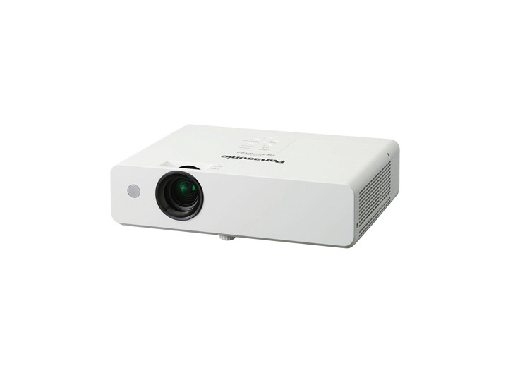

    LCD PROJECTOR 3LCD Projector
    Model PT-LB423
    주요사양 Quiet 28 dB Operation for Distraction - free Viewing
    주요사양 16,000 contrast ratio
    주요사양 LCD, 4100 lumens, XGA
    주요사양 Lamp and filter replacement cycle of up to 10,000 hours(Reduces TCO)
    ModelPT-LB423
    Power supplyAC 100-240 V, 3.5 A, 50 Hz/60 Hz
    Power consumption300 W (6 W when Standby mode set to Normal, 0.5 W when Standby mode set to Eco*¹)
    LCD PanelDisplay methodTransparent LCD panel (× 3, R/G/B)
    Drive methodActive matrix method
    Panel size15.0 mm (0.59 inches) diagonal (16:10 aspect ratio)
    Pixels1,024,000 (1280 × 800) pixels
    LensManual zoom (1.2×), Manual focus lens F=1.6–1.76, f=19.16–23.02 mm, Throw Ratio: 1.48–1.78:1
    Screen size0.76–7.62 m (30–300 inches) diagonally, 16:10 aspect ratio
    Resolution1280 × 800 pixels*³
    Brightness*² (Lamp power: Normal)4,100 lm
    Lamp 230 W × 1 lamp
    Lamp replacement cycle*⁴Normal: 5,000 hours, Eco1: 6,000 hours, Eco2: 10,000 hours
    Center-to-corner uniformity*²80%
    Contrast*²16,000:1 (all white/all black, Iris: On, Image mode: Dynamic, Lamp control: Normal)
    Scanning frequencyHDMI IN525i (480i)*⁵, 625i (576i)*⁵, 525p (480p), 625p (576p), 750 (720)/60p, 750 (720)/50p, 1125 (1080)/60i,1125 (1080)/50i, 1125 (1080)/60p, 1125 (1080)/50p, 1125 (1080)/24p, 1125 (1080)/25p, 1125 (1080)/24sF, 1125 (1080)/30p VGA size (640 dots × 480 dots)–WUXGA (1,920 dots × 1,200 dots), dot clock: 25 MHz–162 MHz
    RGBfH: 15–91 kHz, fV: 24–85 Hz, dot clock: 162 MHz or lower
    Video/S-VideofH: 15.73 kHz, fV: 59.94 Hz [NTSC/NTSC4.43/PAL-M/PAL60], fH: 15.63 kHz, fV: 50 Hz [PAL/SECAM/PAL-N]
    Keystone correction rangeVertical± 30 ° (Auto, Manual)
    Horizontal± 15 ° (Manual)
    TerminalsHDMI INHDMI 19-pin × 1 HDCP compatible, Deep Color compatible, Audio signal: Linear PCM (sampling frequencies: 48 kHz, 44.1 kHz, 32 kHz)
    COMPUTER 1 IND-sub HD 15-pin (female) × 1 [RGB/S-Video/YPB(CB)PR(CR)]
    COMPUTER 2 IND-sub HD 15-pin (female) × 1 [RGB]
    MONITOR OUTD-sub HD 15-pin (female) × 1 [RGB/Monitor output]
    VIDEO INPin jack × 1
    AUDIO IN 1M3 (L,R) × 1
    AUDIO IN 2Pin jack × 2 (L,R)
    AUDIO OUTM3 (L,R) × 1 (variable)
    LANRJ-45 × 1 for network connections, 10Base-T/100Base-TX, PJLink™ (Class 1) compatible
    SERIAL IND-Sub 9-pin (female) × 1 for external control (RS-232C compatible)
    USB-Type AMemory Viewer/Wireless Module (DC 5 V, MAX 500 mA)
    USB-Type BUSB Display
    Built-in speaker10 W mono
    Operation noise*²Normal: 37 dB, Eco1: 33 dB, Eco2: 28 dB
    Cabinet materialsMolded plastic (PC)
    Dimensions (W × H × D)335 mm × 96 mm*⁶ × 252 mm (13 3/16˝ x 3 25/32˝ *⁶ x 9 29/32˝ )
    WeightApprox. 2.9 kg (6.4 lbs)
    Operating environmentOperating temperature: 5–40 °C (41–104 °F ) [Altitude: below 1,400 m (4,593 ft ), High Land Mode: OFF]; 5–35 °C (41–95 °F ) [Altitude: 1,400–2,700 m (4,593–8,858 ft ), High Land Mode: On1]; 5–30 °C (41–86 °F ) [Altitude: 2,700–3,000 m (8,858–9,843 ft ), High Land Mode: On2], Operating humidity: 20–80 % (no condensation)
    Supplied accessoriesWireless remote control unit, Power cord (Number and size of cords depends on region), CD-ROM (Instruction manual, Multi Monitoring & Control Software*⁷ ), Instruction manual (Basic guide), Batteries for remote control (R03/LR03/AAA type battery × 2), RGB signal cable
    Note:*¹ When Standby Mode is set to Eco, network functions such as power on over LAN will not operate. Additionally, only certain commands can be received for external control using the serial terminal.
    *²Measurement, measuring conditions, and method of notation all comply with ISO/IEC 21118: 2012 international standards.
    *³ Input signals that exceed supported resolution will be converted.
    *⁴ The value for the recommended lamp replacement cycle is the maximum value, at which luminance will become 50 %. Usage environment affects the lamp replacement cycle.
    *⁵ Pixel-repetition signal (dot clock frequency 27.0 MHz) only.
    *⁶ With legs at shortest position.
    *⁷ Not supplied with PT-LB303.
