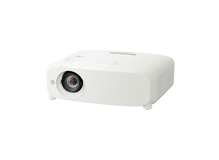

LCD PROJECTOR 3LCD Projector
Model | PT-VX610 |
제조사 | 파나소닉(Panasonic) |
주요사양 | Increased contrast ratio gives even sharper images |
주요사양 | Easier to connect wirelessly |
주요사양 | Flexible wired installation |
주요사양 | Portable projectors with increased brightness |
주요사양 | Filter lasts twice as long |
