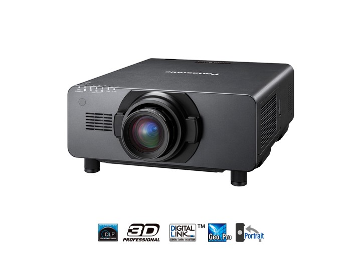

    DLP PROJECTOR 3CHIP DLP Projector
    Model PT-DZ21K2
    주요사양 1920x1200 WUXGA Resolution
    주요사양 2 cm DLP (3) Display Type
    주요사양 20,000 ANSI Lumens
    주요사양 10,000 Contrast
    DLP™ chipPanel size24.4 mm (0.96 inches) diagonal
    (16:10 aspect ratio)
    Display methodDLP™ chip x 3, DLP™ projection system
    Pixels2,304,000 (1,920 x 1,200) x 3,
    total of 6,912,000 pixels
    Refresh Rate120 Hz
    LampNormalUHM lamp x 4 (432 W), replacement cycle of up to 3,000 hours*3
    PortraitUHM lamp x 4 (432 W), replacement cycle of up to 700 hours
    Brightness20,000 lm (four-lamp)
    Contrast ratio10,000:1 (full on/full off, in Dynamic iris mode 3)
    Resolution1,920 x 1,200 pixels
    LensOptional powered zoom and fixed-focus lenses
    Screen size (diagonal)1.78-25.4 m (70-1,000 in),
    1.78-7.62 m (70-300 in)
    with the ET-D75LE50,
    3.05-15.24 m (120-600 in)
    with the ET-D75LE90,
    1.78-15.24 m (70-600 in)
    with the ET-D75LE8,
    16:10 aspect ratio
    Center-to-corner uniformity90 %
    Optical axis shiftVertical ±55 % (±44 % with the ET-D75LE6,
    +73 - +78 % with the ET-D75LE90) (powered
    Horizontal±20 % (±15 % with the ET-D75LE6,
    ±6 % with the ET-D75LE90) (powered)
    Scanning frequencySDISD-SDISMPTE ST 259 compliant, [YCBCR 4:2:2 10-bit] 480i, 576i
    HD-SDISMPTE ST 292 compliant,
    [YPBPR 4:2:2 10-bit] 720/50p, 720/60p, 1035/60i, 1080/50i,
    1080/60i, 1080/25p, 1080/24p, 1080/24sF, 1080/30p
    3G-SDISMPTE ST 424 compliant,
    [YPBPR 4:2:2 10-bit] 1080/50p, 1080/60p,
    [RGB 4:4:4 12-bit /10-bit] 1080/50i, 1080/60i, 1080/25p,
    Dual-link HD-SDISMPTE ST 372 compliant,
    1080/24p, 1080/24sF, 1080/30p,
    [X´Y´Z´ 4:4:4 12-bit] 2048 x 1080/24p, 2048 x 1080/24sF
    Dual-link
    3G-SDI
    SMPTE ST 425 compliant,
    [YPBPR 4:4:4 12-bit / 10-bit] 1080/60p, 1080/50p, 2048 x 1080/60p,
    2048 x 1080/50p, 2048 x 1080/48p,
    [RGB 4:4:4 12-bit/10-bit] 1080/60p, 1080/50p, 2048 x 1080/60p, 2048 x 1080/50p, 2048 x 1080/48p
    HDMI/DVI-D/
    DIGITAL LINK
    480p, 576p, 720/60p, 720/50p, 1080/60i, 1080/50i, 1080/24p, 1080/24sF,
    1080/25p, 1080/30p, 1080/60p, 1080/50p, VGA (640 x 480)-WUXGA*6 (1920 x 1200),
    compatible with non-interlaced signals only, dot clock: 25-162 MHz
    DVI-D/HDMI
    simultaneous
    input
    1920 x 1200p, 1920 x 1080p, 1400 x 1050p, 1366 x 768p, 120 Hz/100 Hz
    RGBfH: 15-100 kHz, fV: 24-120 Hz, dot clock: 13.5-162 MHz
    YPBPR (YCBCR)fH: 15.75 kHz, fV: 60 Hz [480i (525i)]
    fH: 15.63 kHz, fV: 50 Hz [576i (625i)]
    fH: 45.00 kHz, fV: 60 Hz [720 (750)/60p]
    fH: 33.75 kHz, fV: 60 Hz [1035 (1125)/60i
    fH: 28.13 kHz, fV: 50 Hz [1080 (1125)/50i]
    fH: 27.00 kHz, fV: 24 Hz [1080 (1125)/24p]
    fH: 33.75 kHz, fV: 30 Hz [1080 (1125)/30p]
    fH: 56.25 kHz, fV: 50 Hz [1080 (1125)/50p]
    fH: 31.50 kHz, fV: 60 Hz [480p (525p)]
    fH: 31.25 kHz, fV: 50 Hz [576p (625p)]
    fH: 37.50 kHz, fV: 50 Hz [720 (750)/50p]
    fH: 33.75 kHz, fV: 60 Hz [1080 (1125)/60i]
    fH: 28.13 kHz, fV: 25 Hz [1080 (1125)/25p]
    fH: 27.00 kHz, fV: 48 Hz [1080 (1125)/24sF]
    fH: 67.50 kHz, fV: 60 Hz [1080 (1125)/60p]
    Video/YCfH: 15.75 kHz, fV: 60 Hz [NTSC/NTSC4.43/PAL-M/PAL60],
    TerminalsSDI INBNC x 2 (3G/HD/SD-SDI)
    DVI-D INDVI-D 24-pin x 1 (DVI 1.0 compliant, compatible with HDCP,
    compatible with single link only)
    HDMI INHDMI 19-pin x 1 (Deep Color, compatible with HDCP)
    RGB 1 INBNC x 5 (RGB/YPBPR/YCBCR/YC x 1)
    RGB 2 IND-Sub HD 15-pin (female) x 1 (RGB/YPBPR/YCBCR x 1)
    3D SYNC IN/OUTBNC x 1 (3D timing signal)
    3D SYNC OUTBNC x 1 (3D timing signal)
    SERIAL IND-sub 9-pin (female) x 1 for external control (RS-232C compliant)
    SERIAL OUTD-sub 9-pin (male) x 1 for link control
    REMOTE 1 INM3 x 1 for wired remote control
    REMOTE 1 OUTM3 x 1 for link control (for wired remote control)
    REMOTE 2 IND-sub 9-pin (female) x 1 for external control (parallel)
    LAN / Digital LinkRJ-45 x 1 (for network, DIGITAL LINK connection, 100Base-TX,
    compatible with Art-Net, PJLink™ (class 1), Deep Color, HDCP)
    Keystone correction rangeVertical: ±40°*6, horizontal: ±15°
    InstallationCeiling/floor, front/rear, portrait
    Power supply200-240 V AC, 50/60 Hz
    Power consumption2,060 W (0.3 W with STANDBY MODE set to ECO,*1
    4 W with STANDBY MODE set to NORMAL.)
    Dimensions (W x H x D)620 x 255 x 730 mm (24-13/32 x 10-1/32 x 28-3/4 in)
    (optional lens, legs and lens cover not included)
    WeightApprox. 41 kg (90.4 lbs) (optional lens not included)
    Operation noise46 dB
    Operating temperature0-45°C (32-113°F)
    Operating humidity10- 80 % (no condensation)
    Applicable softwareLogo Transfer Software, Multi Monitoring & Control Software, Early Warning Software,
    Geometry Manager Pro (ET-UK20 Upgrade Kit and ET-CUK10*11 Auto Screen Adjustment Kit)
    Supplied accessoriesPower cord with secure lock, wireless/wired remote control unit, batteries (R6/AA type x 2)
    software CD-ROM (Logo Transfer Software, Multi Monitoring & Control Software) (x 1)
