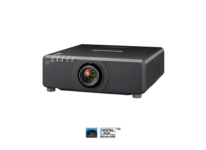

    DLP PROJECTOR 1CHIP DLP Projector
    Model PT-DZ780BK
    주요사양 1920x1200 WUXGA Resolution
    주요사양 Powered, 1.41
    주요사양 Horizontal & Vertical Digital Keystone
    주요사양 7,000 ANSI Lumens
    주요사양 3,000 Contrast
    Power supply100-240 V AC, 9.0-4.0 A, 50/60 Hz
    Power consumption*1790 W (810 VA)
    (0.3 W when STANDBY MODE set to ECO*1, 3 W when STANDBY MODE set to NORMAL)
    DLP™ chipPanel size17.0 mm (0.67 in) diagonal (16:10 aspect ratio)
    Display methodDLP™ chip x 1, DLP™ projection system
    Pixels2,304,000 (1,920 x 1,200) pixels
    LensPowered zoom (throw ratio 1.7-2.4:1), powered focus F 1.7-1.9, f 25.6-35.7 mm
    Lamp310 W UHM lamp x 2
