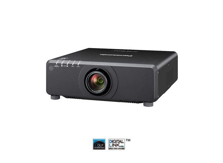

    DLP PROJECTOR 1CHIP DLP Proector
    Model PT-DX820BK
    주요사양 1024x768 XGA Resolution
    주요사양 Powered, 1.41
    주요사양 Horizontal & Vertical Digital Keystone
    주요사양 8,200 ANSI Lumens
    주요사양 2,400 Contrast
    Power supply100-240 V AC, 9.0-4.0 A, 50/60 Hz
    Power consumption*1790 W (810 VA)
    (0.3 W when STANDBY MODE set to ECO*1, 3 W when STANDBY MODE set to NORMAL)
    DLP™ chipPanel size17.8 mm (0.7 in) diagonal (4:3 aspect ratio)
    Display methodDLP™ chip x 1, DLP™ projection system
    Pixels786,432 (1,024 x 768) pixels
    LensPT-DX820Powered zoom (throw ratio 1.8-2.5:1), powered focus F 1.7-1.9, f 25.6-35.7 mm
    PT-DX820LOptional powered zoom/focus lenses and fixed-focus lens
    Lamp310 W UHM lamp x 2
    Screen size (diagonal)1.27–15.24 m (50-600 in),
    1.27-5.08 m (50-200 in) with the ET-DLE055,
    2.54-8.89 m (100-350 in) with the ET-DLE030,
    4:3 aspect ratio
    Brightness*28,200 lm (dual-lamp, LAMP MODE: NORMAL)
    Center-to-corner uniformity*290 %
    Contrast*22,400:1 (full on/full off)
    Resolution1,024 x 768 pixels (Input signals that exceed this resolution will be converted to 1,024 x 768 pixels.)
    Scanning
    frequency
    3G-SDI-
    HD-SDI-
    SD-SDI-
    HDMI*3/DVI-DfH: 15-100 kHz, fV: 24-120 Hz, dot clock: 25-162 MHz
    RGBfH: 15-100 kHz, fV: 24-120 Hz, dot clock: 20-162 MHz
    YPBPR (YCBCR)fH: 15.75 kHz, fV: 60 Hz [480i (525i)]
    fH: 15.63 kHz, fV: 50 Hz [576i (625i)]
    fH: 45.00 kHz, fV: 60 Hz [720 (750)/60p]
    fH: 33.75 kHz, fV: 60 Hz [1035 (1125)/60i]
    fH: 28.13 kHz, fV: 50 Hz [1080 (1125)/50i]
    fH: 27.00 kHz, fV: 24 Hz [1080 (1125)/24p]
    fH: 33.75 kHz, fV: 30 Hz [1080 (1125)/30p]
    fH: 56.25 kHz, fV: 50 Hz [1080 (1125)/50p]fH: 31.50 kHz, fV: 60 Hz [480p (525p)]
    fH: 31.25 kHz, fV: 50 Hz [576p (625p)]
    fH: 37.50 kHz, fV: 50 Hz [720 (750)/50p]
    fH: 33.75 kHz, fV: 60 Hz [1080 (1125)/60i]
    fH: 28.13 kHz, fV: 25 Hz [1080 (1125)/25p]
    fH: 27.00 kHz, fV: 48 Hz [1080 (1125)/24sF]
    fH: 67.50 kHz, fV: 60 Hz [1080 (1125)/60p]
    Video/YCfH: 15.75 kHz, fV: 60 Hz [NTSC/NTSC4.43/PAL-M/PAL60],
    Optical axis shift*4Vertical+50%, -13% from center of screen (powered)*5
    Horizontal+30%, -10% (+28%, -10% with the ET-DLE085) from center of screen (powered)
    Keystone correction range-
    TerminalsSDI IN-
    HDMI INHDMI 19-pin x 1 (Deep Color, compatible with HDCP)
    DVI-D INDVI-D 24-pin x 1 (DVI 1.0 compliant, compatible with HDCP, compatible with single link only)
    RGB 1 INBNC x 5 (RGB/YPBPR/YCBCR/YC/Video x 1)
    RGB 2 IND-Sub HD 15-pin (female) x 1 (RGB/YPBPR/YCBCR x 1)
    SERIAL IND-sub 9-pin (female) x 1 for external control (RS-232C compliant)
    SERIAL OUTD-sub 9-pin (male) x 1 for link control (RS-232C compliant)
    REMOTE 1 INM3 x 1 for wired remote control
    REMOTE 1 OUTM3 x 1 for link control (for wired remote control)
    REMOTE 2 IND-sub 9-pin (female) x 1 for external control (parallel)
    LAN / DIGITAL LINKRJ-45 x 1 (for network and DIGITAL LINK (video/network/serial control) connection,
    100Base-TX, compatible with Art-Net, compliant with PJLink™,
    USBDC OUT (5 V, 0.9 A)
    Dimensions (W x H x D)PT-DX820498 x 175*11 x 521 mm (19-19/32 x 6-7/8*11 x 20-1/2 in) (with supplied lens)
    PT-DX820L498 x 175*11 x 508 mm (19-19/32 x 6-7/8*11 x 20 in) (without lens)
    Weight*12PT-DX820 Approximately 17.8 kg (39.2 lbs) (with supplied lens)
    PT-DX820LApproximately 17.0 kg (37.5 lbs) (without lens)
    Operation noise*230 dB (dual lamp operation, lamp mode: NORMAL),
    28 dB (dual lamp operation, lamp mode: ECO)
    Operating temperature0°C-45°C [32°F-113°F]
    (less than 1,400 m [4,593 ft] above sea level),
    0°C-40°C [32°F-104°F]
    (between 1,400 m and 2,700 m [4,593 ft and 8,858 ft] above sea level)*13
    Operating humidity10-80 % (no condensation)
    Applicable softwareLogo Transfer Software, Multi Projector Monitoring & Control Software
    Supplied accessoriesPower cord with secure lock, wireless/wired remote control unit,
    batteries (R03/AAA type x 2), software CD-ROM (Logo Transfer Software,
    Multi Projector Monitoring & Control Software)
    * Product numbers vary depending on the market. The general guideline is as follows: The product number in the Americas and Taiwan is
    PT-DZ780KU/DZ780WU/DZ780LKU/DZ780LWU, PT-DW750KU/DW750WU/DW750LKU/DW750LWU, and PT-DX820KU / DX820WU / DX820LKU / DX820LWU.
    The product number in Europe, CIS, Asia (except Taiwan), Oceania, Middle East, and Africa is
    PT-DZ780KE/DZ780WE/DZ780LKE/DZ780LWE, PT-DW750KE/DW750WE/DW750LKE/DW750LWE, and PT-DX820KE / DX820WE / DX820LKE / DX820LWE.
    *1 When the STANDBY MODE is set to ECO, network functions such as power on over the LAN will not operate. Also, only certain commands can be received for external control using the serial terminal.
    *3 DIGITAL LINK input compatible signal is the same as HDMI input compatible signal.
    *4 Optical axis shift cannot be operated with the ET-DLE055, and the optical axis is fixed with the ET-DLE030.
    *5 +45 %, -13% from center of screen with the ET-DLE085.
    *6 ±22° with the ET-DLE085/DLE055.
    *7 +5° with the ET-DLE030.
    *8 Up to a total of ±55° during simultaneous horizontal and vertical correction.
    *9 ±40° with the ET-DLE150/DLE250/supplied lens.
    *10 ±15° with the ET-DLE085/DLE055.
    *11 With legs at shortest position.
    *12 Average value. May differ depending on models.
    *13 When using the projector at elevations lower than 2,700 m (8,858 ft) above sea level, and the operating environment temperature becomes 35 °C (95 °F) or higher, the light output may be reduced to protect the projector. When using the projector at elevations between 2,700 m (8,858 ft) and 4,200 m (13,780 ft), and the operating environment temperature becomes 25 °C (77 °F) or higher, the light output may be reduced to protect the projector.
    *14 Available worldwide except in the United States.
