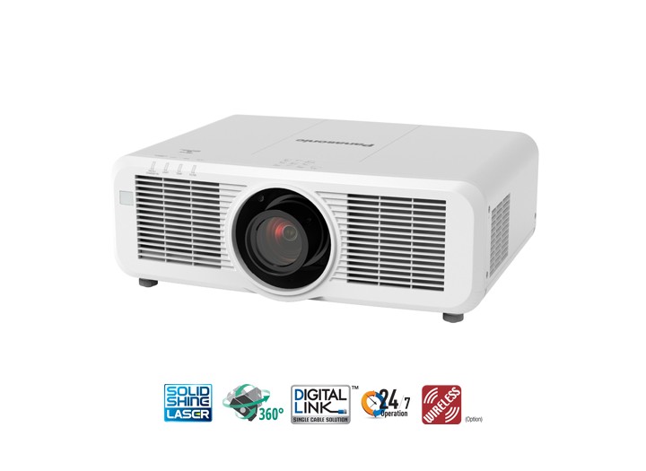

    LASER PROJECTOR 3LCD Laser Projector
    Model PT-MZ570
    주요사양 3000000 Contrast Ratio
    주요사양 Laser Light Source / LCD Display Technology
    주요사양 5500 ANSI Lumens
