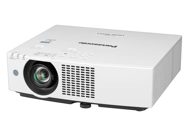

    LASER PROJECTOR 3 LCD Laser Projector
    model PT-VMZ60
    주요사양 Laser Light Source / LCD Display Technology
    주요사양 3000000 Contrast Ratio
    주요사양 6000 ANSI Lumens
    Resolution1920 x 1200 pixels
    TechnologyLaser LCD
    Light output*16 000 lumens
    LCD panel | Panel size (mm)16 mm diagonal (16:10 aspect ratio)
    LCD panel | Panel size (inch)0.64 inch diagonal (16:10 aspect ratio)
    LCD panel | Display methodTransparent LCD panel (x 3, R/G/B)
    LCD panel | Drive methodActive matrix
    LCD panel | Pixels2,304,000 (1920 x 1200) x 3, total of 6,912,000 pixels
    LENS1.6 x Manual zoom (throw ratio 1.09-1.77 :1), F = 1.60-2.12, f = 15.30-24.64 mm
    Light sourceLaser diode
    Screen size (diagonal) (mm)0.76 – 7.62 m, 16:10 aspect ratio
    Screen size (diagonal) (inch)30-300 in, 16:10 aspect ratio
    Center-to-corner uniformity*185 %
    Contrast*13,000,000:1 (all white/all black) (Input signals:PC,LIGHT POWER:NORMAL,PICTURE MODE:DYNAMIC,DAYLIGHT WIEW:OFF,DYNAMIC CONTRAST:1,AUTO POWER SAVE:OFF)
    Optical axis shift | Vertical (from center of screen)0 % – +44 % (Manual)
    Optical axis shift | Horizontal (from center of screen)– 20% – +20% (Manual)
    Keystone correction range*2Vertical: ±25°, Horizontal: ±35°
    InstallationHorizontal/Vertical, free 360-degree installation
    Terminals | HDMI 1/2 INHDMI 19-pin x 2 (Compatible with HDCP, Deep Color, 4K/30p signal input)
    Terminals | COMPUTER 1 IND-sub 15-pin (female) x 1 (RGB/YPBPR/YCBCR)
    Terminals | COMPUTER 2 IN / MONITOR OUTD-sub 15-pin (female) x 1 (RGB/YPBPR/YCBCR) (input/output switching)
    Terminals | VIDEO INPin jack x 1
    Terminals | AUDIO 1/2 INM3 stereo mini-jack x 2
    Terminals | AUDIO 3 INPin jack (L/R) x 1
    Terminals | VARIABLE AUDIO OUTM3 stereo mini-jack x 1
    Terminals | SERIAL IND-sub 9-pin x 1 for computer control (RS-232C compliant)
    Terminals | LANRJ-45 x 1 for network control, 10Base-T, 100Base-TX, compatible with PJLink™ (Class 2)
    Terminals | DIGITAL LINK/LANRJ-45 x 1 for network and DIGITAL LINK connection, HDBase-T™ compliant, 100Base-TX, compatible with PJLink™  (Class 2), HDCP, Deep Color, 4K/30p signal input
    Terminals | USB CONNECTORUSB connector (Type A) x 1 for Memory Viewer function, power supply (DC5V, maximum 2A*3), optional wireless module AJ-WM50
    Power supplyAC 100-240 V AC, 50/60 Hz
    Power consumptionTBD
    Built-in Speaker10 W (monaural)
    Operating noise*1NORMAL: 38dB, QUIET: 27dB
    FilterIncluded
    Filter cleaning cycle: 20,000 hours  (0.08 mg/m3 of particulate matter), 10,000 hours (0.15 mg/m3 of particulate matter)
    Dimensions (W x H x D) (mm)399 x 115 x 348 mm (Not including protruding parts)399 x 133 x 348 mm (With feet at shortest position)
    Dimensions (W x H x D) (inch)15 23/32 x 4 17/32 x 13 11/16 inch (Not including protruding parts)15 23/32 x 5 1/4 x 13 11/16 inch (With feet at shortest position)
    Weight (kg)*4Less than 7.2 kg
    Weight (lbs.)*4Less than 15.87 lbs.
    Operating environment (℃/M)Operating temperature: 0 °C- 45 °C, operating humidity: 20 %-80 % (no condensation)
    Operating environment (°F/Feet)Operating temperature: 32 °F -113 °F, operating humidity: 20 %-80 % (no condensation)
    Applicable software/applicationLogo Transfer Software, Multi Monitoring & Control Software, Presenter Light for Windows®, Wireless Projector Apps for iOS/Android™
