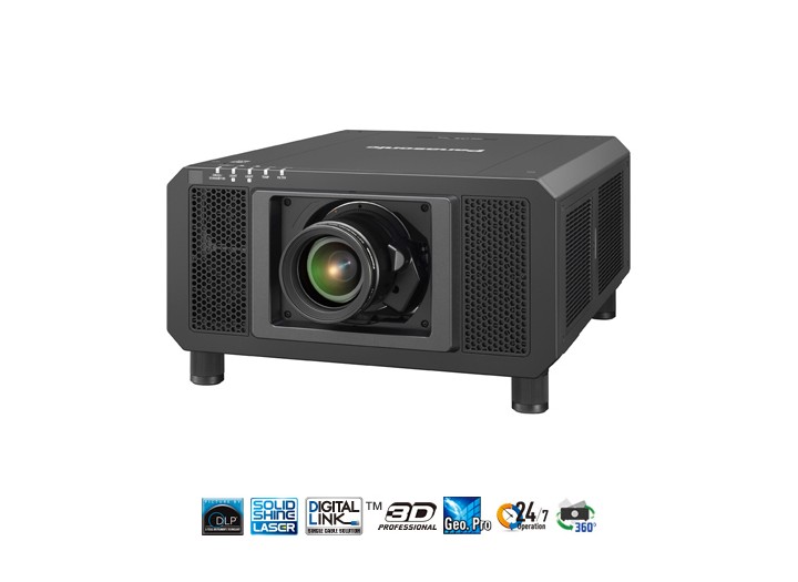

    LASER PROJECTOR 3 DLP Laser Projector
    Model PT-RS11K
    주요사양 1400 x 1050 (SXGA+) Resolution
    주요사양 20000 Contrast Ratio
    주요사양 12000 ANSI Lumens
    PRODUCT SPECIFICATIONS
    Brightness12,000 lumens
    Resolution1,400 x 1,050 pixels (Input signals that exceed this resolution will be converted to 1,400 x 1,050 pixels.)
    Lamp3-Chip DLP Laser
    Power supplyAC 100-240 V 50/60 Hz
    Power consumption1,200 W (1,280 VA) (0.3 W with STANDBY MODE set to ECO. 4 W with STANDBY MODE set to NORMAL.),
    Average power consumption
    NORMAL: 800W ECO: 680W LONG LIFE1: 620W LONG LIFE 2: 590W
    LONG LIFE 3: 550W
    *Operating Temperature: 25 °C (77 °F), Altitude: 700m (22 ft 12 in),
    ICE627087: 2008 Broadcast contents,
    Picture mode: Dynamic, Dynamic Contrast3
    BTU valueMax 4,096 BTU
    DLP™ chip | Panel size24.1 mm (0.95 inches) diagonal (4:3 aspect ratio)
    DLP™ chip | Display methodDLP™ chip x 3 (R, G, B), DLP™ projection system
    DLP™ chip | Pixels1,470,000 (1,400 x 1,050) x 3, total of 4,410,000 pixels
    LENSOptional powered zoom/focus lenses
    Light sourceLaser Diode (Laser class: Class 1)
    * Temperature: 35°C (95°F), Altitude 700m (22ft 12in), Dust: 0.15mg/m³
    43,800 hours at constant luminance (Longlife1)
    61,320 hours at constant luminance (Longlife2)
    87,600 hours at constant luminance (Longlife3)
    Screen size1.78-25.4 m (70-1,000 inches) (4:3 aspect ratio)
    1.78-15.24 m (70-600 inches) with the ET-D75LE8 (4:3 aspect ratio)
    3.05-15.24 m (120-600 inches) with the ET-D75LE90 (4:3 aspect ratio)
    Contrast20,000:1 (full on/full off, in Dynamic Contrast 3 mode)
    Scanning frequency | SDISD-SDI signal (YCBCR 4:2:2 10-bit):
    SMPTE ST 259 compliant: 525i(480i), 625i(576i)
    Single-link HD-SDI signal (YPBPR 4:2:2 10-bit):
    SMPTE ST 292 compliant: 750(720)/60p, 750(720)/50p, 1125(1035)/60i,
    1125(1080)/60i, 1125(1080)/50i, 1125(1080)/25p, 1125(1080)/24p,
    1125(1080)/24sF, 1125(1080)/30p
    Dual-link HD-SDI signal (RGB 4:4:4 12-bit/10-bit):
    SMPTE ST 372 compliant: 1125(1080)/60i, 1125(1080)/50i,
    1125(1080)/25p, 1125(1080)/24p, 1125(1080)/24sF, 1125(1080)/30p
    Dual-link HD-SDI signal (X Y Z 4:4:4 12-bit):
    SMPTE ST 372 compliant: 2048 x 1080/24p, 2048 x 1080/24sF,
    3G-SDI signal (YPBPR 4:2:2 10-bit):
    SMPTE ST 424 compliant: 1125(1080)/60p, 1125(1080)/50p
    3G-SDI signal (RGB 4:4:4 12-bit/10-bit):
    SMPTE ST 424 compliant: 1125(1080)/60i, 1125(1080)/50i,
    Dual-link 3G-SDI signal (YPBPR 4:4:4 12-bit/10-bit):
    SMPTE ST 425 compliant: 1125(1080)/60i, 1125(1080)/50i,
    2048 x 1080/48p, 2048 x 1080/50p, 2048 x 1080/60p
    Dual-link 3G-SDI signal (RGB 4:4:4 12-bit/10-bit):
    Scanning frequency | HDMI/DVI-DHorizontal: 15 kHz-100 kHz, vertical: 24 Hz - 120 Hz,
    dot clock: 25 MHz - 162 MHz
    Scanning frequency | RGBHorizontal: 15 kHz-100 kHz, vertical: 24 Hz - 120 Hz,
    dot clock: 162 MHz or less
    Scanning frequency | YPBPR (YCBCR)525i (480i): fH 15.73 kHz; fV 59.94 Hz,
    625i (576i): fH 15.63 kHz; fV 50 Hz,
    525p (480p): fH 31.47 kHz; fV 59.94 Hz,
    1125 (1035)/60i: fH 33.75 kHz; fV 60 Hz,
    Scanning frequency | Video/Y/CfH: 15.73 kHz, fV: 59.94 Hz [NTSC/NTSC4.43/PAL-M/PAL60]
    Optical axis shift | Vertical±50% (±40% with the ET-D75LE6), (+71% with the ET-D75LE90),
    from center of screen, powered
    Optical axis shift | Horizontal±30% (±20% with the ET-D75LE6) from center of screen, powered
    NOTE: Optical axis shift function cannot be operated when used with the ET-D75LE50/ET-D75LE90.
    Keystone correction rangeVertical : ±40° (±22° with the ET-D75LE50, ±28° with the ET-D75LE6, +5° with the ET-D75LE90),
    horizontal: ±15° (0° with the ET-D75LE90)
    Terminals | SDI IN 1BNC x 2,
    (3G/HD/SD-SDI, Dual-link HD-SDI, Dual-link 3G-SDI)
    3G-SDI signal: SMPTE ST 424 compliant
    HD-SDI signal: SMPTE ST 292 compliant
    SD-SDI signal: SMPTE ST 259 compliant
    Terminals | HDMI INHDMI 19-pin x 1, Deep Color, compatible with HDCP,
    NOTE: Compatible with non-interlaced signals only.
    Terminals | DVI-D INDVI-D 24-pin x 1, DVI 1.0 compliant, HDCP compatible,
    for single link only
    Terminals | RGB 1 INBNC x 5
    B: 0.7 Vp-p, 75 ohms
    NOTE: SYNC/HD and VD terminals do not accept tri-level sync signals.
    Terminals | RGB 1 IN | Y, PB, PR (Y, CB, CR)Y: 1.0 Vp-p (including sync signal), PB/PR(CB/CR): 0.7 Vp-p, 75 ohms
    Terminals | RGB 1 IN | Video inBNC x 1, 1.0 Vp-p 75 ohms
    Y/C Y: 1.0 Vp-p (including sync signal), C: 0.286 Vp-p, 75 ohms
    Terminals | RGB 2 IN | Y, PB, PR (Y, CB, CR)Y: 1.0 Vp-p (including sync signal), PB/PR (CB/CR): 0.7 Vp-p, 75 ohms
    Terminals | 3D SYNC 1 IN/OUTBNC x 1, 1.0 Vp-p, 75 ohms
    Input: TTL, high impedance. Output: TTL, max. 10 mA
    Terminals | 3D SYNC 2 OUTBNC x 1, 1.0 Vp-p, 75 ohms, TTL, max. 10 mA
    Terminals | SERIAL IND-sub 9-pin (female) x 1 for external control (RS-232C compliant)
    Terminals | SERIAL OUTD-sub 9-pin (male) x 1 for link control
    Terminals | Remoter 1 OutM3 jack x 1 for link control
    Terminals | Remoter 2 InD-sub 9-pin x 1 for external control (parallel)
    Terminals | DIGITAL LINK/LANRJ-45 Network connection / digital link connection (video/network/serial control) compliant with PJLink™,100base-tx, Art-Net compatible
    Dimensions (W x H x D)578 x 323.5 x 740 mm
    (22-3/4 x 12-23/32 x 29-1/8 inches) (without lens)
    Weight44 kg (97.0 lbs) (without lens)
    Operating noise43 dB
    Operating temperatureNormal
    The operating temperature range is 0°C to 50°C (32 °F to 122 °F).
    (Brightness is limited at operating temperatures of 35°C (95°F) or more at altitudes from 700 m to 2,700 m (2,297 ft to 8,858 ft) above sea level,
    and at operating temperatures of 25°C (77°F) or more at altitudes from 2,700 m to 4,200 m (8,858 ft to 13,780 ft) above sea level.)
    Eco/Long life 1/2/3
    The operating temperature range is 0°C to 45°C (32 °F to 113 °F).
    (Brightness is limited at operating temperatures of 35°C (95°F) or more at altitudes up to 2,700 m (8,858 ft) above sea level. The projector cannot be used at altitudes of 2,700 m (8,858 ft) or more above sea level.)
    When the projector is used with a Smoke Cut Filter
    The operating temperature range is 0°C to 40°C (32 °F to 104 °F).
    (The projector cannot be used at altitudes of 1,400 m (4,593 ft) or more above sea level.)
    * The brightness of the light source may drop depending on the operating temperature range. The higher the temperture, the greater the drop in the brightness of the light source will be.
    Applicable software10%-80% (no condensation)
    Technology3-chip DLP Laser
