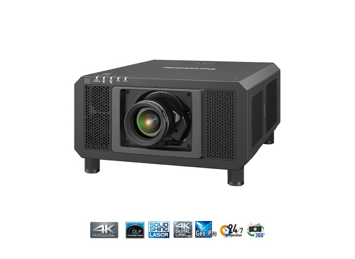

    LASER PROJECTOR 3 DLP Laser Projector
    Model PT-RQ13K
    주요사양 4096 x 2160 (4K) Resolution
    주요사양 20000 Contrast Ratio
    주요사양 10000 ANSI Lumens
    PRODUCT SPECIFICATIONS
    Brightness10,000 lumens
    Resolution5,120 x 3,200 pixels (Quad Pixel Drive: ON)
    Lamp3-Chip DLP Laser
    Power supplyAC 100-240 V, 50/60 Hz
    (Note: Brightness may decrease depending on power conditions)
    Power consumption1,270 W (0.3 W with STANDBY MODE set to ECO. 4 W with
    STANDBY MODE set to NORMAL.),
    Average power consumption
    NORMAL: 913W ECO: 782W LONG LIFE1: 531-732W
    LONG LIFE 2: 477-702W LONG LIFE 3: 423-665W
    *Operating Temperature: 25 °C (77 °F), Altitude: 700m (22 ft 12 in),
    ICE627087: 2008 Broadcast contents,
    Picture mode: Dynamic, Dynamic Contrast3
    DLP™ chip | Panel size22.9 mm (0.9 inches) diagonal (16:10 aspect ratio)
    DLP™ chip | Display methodDLP™ chip x 3 (R, G, B), DLP™ projection system
    DLP™ chip | Pixels4,096,000 (2,560 x 1,600) x 3, total of 12,288,000 pixels
    49,152,000 (12,288,000 x 4) pixels when Quad Pixel Drive set to ON
    Refresh Rate240 Hz
    LENSOptional powered zoom/focus lenses
    Light sourceLaser Diode (Laser class: Class 1)*Class 3R for North America.
    * Temperature: 35°C (95°F), Altitude 700m (22ft 12in), Dust: 0.15mg/m³
    43,800 hours at constant luminance (Longlife1)
    61,320 hours at constant luminance (Longlife2)
    87,600 hours at constant luminance (Longlife3)
    Screen size1.78-25.4 m (70-1,000 inches) (16:10 aspect ratio)
    1.78-15.24 m (70 - 600 inches) with the ET-D75LE8 (16:10 aspect ratio)
    3.05-15.24 m (120 - 600 inches) with the ET-D75LE90 (16:10 aspect ratio)
    Contrast20,000:1 (full on/full off, in Dynamic Contrast 3 mode)
    Scanning frequency | SDISD-SDI signal SMPTE ST 259 compliant (YCBCR 4:2:2 10-bit): 480i, 576i
    Single-link HD-SDI signal SMPTE ST 292 compliant(YPBPR 4:2:2 10-bit):
    720/60p, 720/50p, 1035/60i, 1080/60i, 1080/50i, 1080/25p, 1080/25sF,
    1080/24p, 1080/24sF, 1080/30p, 1080/30sF
    Single-link 3G-SDI signal SMPTE ST 424 compliant (YPBPR 4:2:2 10-bit):
    1080/60p, 1080/50p, 2048 x 1080/48p, 2048 x 1080/50p, 2048 x 1080/60p,
    (RGB 4:4:4 12-bit/10-bit, YPBPR 4:4:4 12-bit/10-bit): 1080/60i, 1080/50i,
    1080/25p, 1080/25sF, 1080/24p, 1080/24sF, 1080/30p, 1080/30sF, (RGB
    4:4:4 12-bit/10-bit, YPBPR 4:4:4 12-bit/10-bit, X'Y'Z' 4:4:4 12-bit):
    2048 x 1080/24p, 2048 x 1080/24sF, 2048 x 1080/25p, 2048 x 1080/25sF,
    2048 x 1080/30p, 2048 x 1080/30sF
    Dual-link HD-SDI signal SMPTE ST 372 compliant(YPBPR 4:2:2 10-bit):
    1080/50p, 1080/60p, (RGB 4:4:4 12-bit/10-bit, YPBPR 4:4:4 12-bit/10-bit):
    1080/60i, 1080/50i, 1080/24p, 1080/24sF, 1080/25p, 1080/25sF, 1080/30p,
    1080/30sF, 2048 x 1080/24p, 2048 x 1080/24sF, 2048 x 1080/25p,
    2048 x 1080/25sF, 2048 x 1080/30p, 2048 x 1080/30sF, (X' Y' Z' 4:4:4
    12-bit*3): 2048 x 1080/24p, 2048 x 1080/24sF, 2048 x 1080/25p,
    Dual-link 3G-SDI signal SMPTE ST 425 compliant (YPBPR 4:4:4 12-bit/10-bit):
    1080/50p, 1080/60p, 2048 x 1080/48p, 2048 x 1080/50p, 2048 x 1080/60p,
    (RGB 4:4:4 12-bit/10-bit) : 1080/50p, 1080/60p, 2048 x 1080/48p,
    2048 x 1080/50p, 2048 x 1080/60p, (YPBPR 4:2:2 10-bit): 3840 x 2160/24p,
    3840 x 2160/25p, 3840 x 2160/30p, 4096 x 2160/24p, 4096 x 2160/25p,
    4096 x 2160/30p
    Quad-link HD-SDI signal (YPBPR 4:2:2 10-bit) :
    3840 x 2160/24sF, 3840 x 2160/24p, 3840 x 2160/25sF, 3840 x 2160/25p,
    3840 x 2160/30sF, 3840 x 2160/30p, 4096 x 2160/24sF, 4096 x 2160/24p,
    4096 x 2160/25sF, 4096 x 2160/25p, 4096 x 2160/30sF, 4096 x 2160/30p
    Quad-link 3G-SDI signal SMPTE ST 425 compliant (YPBPR 4:2:2 10-bit):
    3840 x 2160/60p, 3840 x 2160/50p, 4096 x 2160/60p, 4096 x 2160/50p,
    (YPBPR 4:2:2 12-bit, YPBPR 4:4:4 10-bit/12-bit, RGB 10-bit/12-bit)
    SDI1/SDI2 Simultaneous inputs (2 x speed): 1080/60p, 1080/50p
    (1st FRAME: SDI1, 2nd FRAME: SDI2)
    SDI1/SDI2/SDI3/SDI4 Simultaneous inputs (4 x speed): 1080/60p, 1080/50p
    (1st FRAME: SDI1, 2nd FRAME: SDI2, 3rd FRAME: SDI3, 4th FRAME: SDI4)
    DIGITAL LINK: Movie signal resolution : 480i/576i - 4096 x 2160,
    Still picture signal resolution : 640 x 400 - 2560 x 1600 (non-interlace),
    Dot clock frequency: 25 MHz - 297 MHz
    Keystone correction rangeVertical: ±40° (±22° with the ET-D75LE50, ±28° with the ET-D75LE6, +5° with the ET-D75LE90), horizontal: ±15° (0° with the ET-D75LE90)
    Optical axis shift | Vertical±59% (±44% with the ET-D75LE6), (+74-84% with the ET-D75LE90),
    from center of screen, powered
    Optical axis shift | Horizontal±29% (±19% with the ET-D75LE6), (-12-16% with the ET-D75LE90),
    NOTE: Optical axis shift function cannot be operated when used with the ET-D75LE50.
    Terminals | SDI IN 1BNC x 1,
    3G/HD/SD-SDI input, Dual-link input (LINK-A) ,
    Quad-link input
    Terminals | SDI IN 2BNC x 1,
    3G/HD/SD-SDI input, Dual-link input (LINK-B) ,
    Quad-link input
    Terminals | SDI IN 3BNC x 1,
    Quad-link input
    Terminals | SDI IN 4BNC x 1,
    Quad-link input
    Terminals | Frame Sync IN/OUTBNC x 1, (frame-synchronizing timing signal)
    Terminals | Frame Sync OUTBNC x 1, (frame-synchronizing timing signal)
    Terminals | SERIAL IND-sub 9-pin (female) x 1 for external control (RS-232C compliant)
    Terminals | SERIAL OUTD-sub 9-pin (male) x 1 for link control
    Terminals | Remoter 1 In/OutM3 x 1 for link control (for wired remote control)
    Terminals | REMOTE 2 IND-sub 9-pin (female) x 1 for external control (parallel)
    Terminals | DIGITAL LINK/LANRJ-45 x 1 (for network, DIGITAL LINK connection (HDBaseT™ compatible),
    100Base-TX,compatible with Art-Net, PJLink™ (class 1), Deep Color, HDCP2.2)
    Terminals | Expansion Slotx 2 (SLOT 1,SLOT 2), SLOT NX (Compatible with Optional Board)
    Dimensions (W x H x D)578 x 323.5 x 740 mm
    (22-3/4 x 12-23/32 x 29-1/8 inches) (with projections)
    578 x 270 x 725 mm
    (22-3/4 x 10-5/8 x 28-17/32 inches) (without lens, feet or projections)
    Weight49 kg (108.0 lbs) (without lens)
    Operating noise46 dB
    Operating temperatureAmbient operating temperature: 0°C to 45°C (32 °F to 113 °F).
    Ambient operating humidity: 10% - 80% (no condensation)
    When the operating mode is set to "Normal", the operating temperature range is 0°C to 45°C (32 °F to 113 °F), and at altitudes from 1,400 m to 4,200 m
    (4,593 ft to 13,780 ft) it is 0°C to 40°C (32 °F to 104 °F).
    When the operating mode is set to "Eco", or "Long Life 1/2/3", the operating
    temperature range is 0°C to 40°C (32 °F to 104 °F).
    When the projector is used with a Smoke Cut Filter, the operating temperature range is 0°C to 35°C (32 °F to 95 °F).
    Furthermore, when the operating mode is set to "Eco", or "Long Life 1/2/3",the projector cannot be used at altitudes above 2700 m (8,858 ft). In addition,
    when the projector is used with a Smoke Cut Filter, it cannot be used at altitudes above 1,400 m (4,593 ft). The brightness of the light source may drop depending on the operating environment and the operating temperature range in order to protect the projector.
    Applicable softwareLogo Transfer Software, Multi Monitoring & Control Software,
    Early Warning Software,Geometry Manager Pro (ET-UK20 series Upgrade Kit and ET-CUK10 series Auto Screen Adjustment Kit)
    Technology3-chip DLP Laser
    <sup>(1)</sup> Measurement, measuring conditions, and method of notation all comply with ISO 21118 international standards.<br/>
    <sup>(2)</sup> Maximum physical resolution. Quad Pixel Drive: ON.<br/>
    <sup>(3)</sup> Measured at center area of projector screen. Measurement method is in compliance with ISO/IEC 21118: 2012 international standards. Value is average of all products when shipped.<br/>
    <sup>(4)</sup> With lens other than ET-D75LE95 and power supply of AC 200 V.
