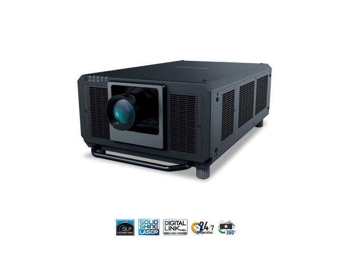

    LASER PROJECTOR 3 DLP Laser Projector
    Model PT-RS30K
    주요사양 1400 x 1050 (SXGA+) Resolution
    주요사양 20000 Contrast Ratio
    주요사양 Laser Light Source / 3 Chip DLP Display Display Technology
    주요사양 31000 ANSI Lumens
    PRODUCT SPECIFICATIONS
    Power supplyAC 100-120 V, 50/60 Hz; AC 200-240 V, 50/60 Hz
    Power consumption2,870 W (2,870 VA AC200V)
    Average power consumption
    Varies depending on operation mode setting.)
    HIGH: 2,310W NORMAL: 1,890W
    LONG LIFE 1: 1,040-1,680W
    LONG LIFE 2: 924-1,580W
    LONG LIFE 3: 794-1,460W
    *Operating Temperature: 25 °C (77 °F),
    Altitude: 700m (2,297ft), IEC627087: 2008 Broadcast contents,
    Picture mode: Standard, Dynamic contrast [2]
    0.3 W with STANDBY MODE set to ECO
    4 W with STANDBY MODE set to NORMAL
    BTU valueMax 9,806 BTU
    DLP™ chip | Panel size24.1 mm (0.95 inches) diagonal (4:3 aspect ratio)
    DLP™ chip | Display methodDLP™chip x 3 (R, G, B), DLP™projection system
    DLP™ chip | Pixels1,470,000 (1400 x1050) x3, total of 4,410,000 pixels
    LENSOptional powered zoom/focus lenses
    Light sourceLaser Diode Laser class 1
    Illumination life of setVaries depending on operation mode setting.
    Luminance life for set: 18,000 hours at half luminance (HIGH)/
    8,000 hours at 70% luminance
    20,000 hours at half luminance (NORMAL)
    43,800 hours at constant luminance (LONG LIFE 1)/
    61,320 hours at constant luminance (LONG LIFE 2)/
    87,600 hours at constant luminance (LONG LIFE 3)
    * IEC62087: 2008 Broadcast contents, Dynamic contrast [3]
    Screen size1.78-25.4 m (70-1,000 inches) (4:3 aspect ratio)
    1.78-15.24 m (70-600 inches) with the ET-D75LE8 (4:3 aspect ratio)
    3.05-15.24 m (120-600 inches) with the ET-D75LE95 (4:3 aspect ratio)
    Brightness*1Varies depending on operation mode setting.
    30,000 lm*2*4/31,000 lm*3*4 (Center) (HIGH)
    25,000 lm*2*4/26,000 lm*3*4 (Center) (NORMAL)
    12,000 lm at constant luminance (LONG LIFE 1)
    10,000 lm at constant luminance (LONG LIFE 2)
    8,000 lm at constant luminance (LONG LIFE 3)
    Center-to-corner uniformity*190%
    Contrast*120,000:1 (full on/full off, in Dynamic Contrast 3 mode)
    Resolution1400 x1050 pixels (Input signals that exceed this resolution will be
    converted to 1400 x1050 pixels.)
    Scanning frequency | Video/Y/CfH:15.73KHz fV:59.94Hz, fH:15.63KHz fV:50Hz
    Scanning frequency | RGB• Resolution: 640 x 400 pixels to 1920 x 1200 pixels
    • Dot clock frequency: 162MHz or less
    • PIAS (Panasonic Intelligent Auto Scanning)
    Scanning frequency | YPBPR (YCBCR)• Resolution: 480i/576i to 1920 x 1080 pixels
    • Dot clock frequency: 148.5MHz or less
    • The SYNC/HD and VD terminals do not support 3 value SYNC.
    Scanning frequency | DVI• Moving image signal resolution: 480i*5/576i*5 to 1920x1080
    Still image signal resolution: 640 x 400 to 1920 x 1200 (non-interlace)
    • Dot clock frequency: 25 MHz to 162 MHz
    Scanning frequency | HDMI/DIGITAL LINK• Moving image signal resolution: 480i*5/576i*5 to 1920x1080
    Scanning frequency | SDISD-SDI signal
    HD-SDI signal
    3G-SDI signal
    Optical axis shift | Vertical±50% (±40% with the ET-D75LE6), (+67-71% with the ET-D75LE95),
    from center of screen, powered
    Optical axis shift | Horizontal±30% (±20% with the ET-D75LE6), (±8% with the ET-D75LE95),
    NOTE: Optical axis shift function cannot be operated when used with the ET-D75LE50.
    InstallationCeiling/floor, front /rear, free 360-degree installation
    Terminals | RGB 1 INBNC x 5
    B: 0.7 Vp-p, 75 ohms
    Terminals | RGB 1 IN | Y, PB, PR (Y, CB, CR)Y: 1.0 Vp-p (including sync signal), PB/PR (CB/CR): 0.7 Vp-p, 75 ohms
    Terminals | RGB 1 IN | Y/CY: 1.0 Vp-p (including sync signal), C: 0.286 Vp-p, 75 ohms
    Terminals | RGB 1 IN | Video inBNC x 1, 1.0 Vp-p, 75 ohms
    Terminals | RGB 2 IN | Y, PB, PR (Y, CB, CR)Y: 1.0 Vp-p (including sync signal), PB/PR (CB/CR): 0.7 Vp-p, 75 ohms
    Terminals | DVI-D INDVI-D 24-pin x1
    Single link, DVI 1.0 compliant, HDCP compatible
    Terminals | HDMI INHDMI 19-pin x1
    HDCP compatible, Deep Color compatible
    Terminals | SDI IN 1BNC x 1
    SD-SDI signal SMPTE ST 259 compliant
    HD-SDI signal SMPTE ST 292 compliant
    3G-SDI signal SMPTE ST 424 compliant
    Dual link HD-SDI (LINK-A) signal SMPTE ST 372 compliant
    Dual link 3G-SDI (Link 1) signal SMPTE ST 425 compliant
    Terminals | SDI IN 2BNC x 1
    Dual link HD-SDI (LINK-B) signal SMPTE ST 372 compliant
    Dual link 3G-SDI (Link 2) signal SMPTE ST 425 compliant
    Terminals | DIGITAL LINKRJ-45
    HDBaseT™ compliant, HDCP compatible, Deep Color compatible
    Terminals | 3D Sync 1 In/Out / Multi Projector Sync InBNC x 1, IN : TTL Hi-z OUT : TTL max10mA
    Terminals | 3D Sync 2 Out/Multi Projector Sync OutBNC x 1, TTL max10mA
    Terminals | SERIAL IND-sub 9 pin x 1 for external control (RS-232C compliant)
    Terminals | SERIAL OUTD-sub 9 pin x 1 for link control
    Terminals | Remoter 1 InM3 stereo mini jack x 1 for wired remote control
    Terminals | Remoter 1 OutM3 stereo mini jack x 1 for link control
    Terminals | Remoter 2 InD-sub 9 pin x 1 for external control (parallel)
    Terminals | DIGITAL LINK/LANRJ-45 x 1 (for network, DIGITAL LINK connection, 100Base-TX,
    compatible with Art-Net, PJLink™ (class 1), Deep Color, HDCP)
    Terminals | DC OUT 5VUSB connector (type A) x 2 for power supply only (DC 5V, Max.900mA)
    Power cord length3.0 m (9 ft 10 in) ft
    Cabinet materialsProcessed metal parts, Molded plastic
    Dimensions (W x H x D)700 x 418*8x1,250 mm
    (27-9/16 x 16-15/32 x 49-7/32 inches) (with protrusion parts)
    700 x 373*9x1,070 mm
    (27-9/16 x 14-11/16 x 42-1/8 inches) (without protrusion parts)
    Weight*1079 kg (174.2 lbs)
    Operation noise*249 dB
    Operating temperatureVaries depending on operation mode setting.
    HIGH/NORMAL
    The operating temperature range is 0°C to 50°C (32 °F to 122 °F).
    (Less than 1,400m (4,593 ft) above sea level)
    The operating temperature range is 0°C to 45°C (32 °F to 113 °F).
    (Less than 1,400m (4,593 ft) to 4,200m (13,780 ft) above sea level)
    • If using at ambient operating temperatures of 35 °C (95 °F) or higher and at
    less than 2,700m (8,858 ft) above sea level, or at ambient operating
    temperatures of 25 °C (77 °F) or higher and between 2,700m (8,858 ft) and
    4,200m (13,780 ft) above sea level, the brightness of the light source may
    drop in order to protect the projector.
    LONG LIFE 1/2/3
    (Less than 2,700m (8,858 ft) above sea level)
    • If using at ambient operating temperatures of 35 °C (95 °F) or higher,
    the brightness of the light source may drop in order to protect the projector.
    When using a smoke cut lter (regardless of operating mode)
    0 °C to 40 °C (32 °F to 104 °F) Less than 1,400 m (4,953 ft) above sea level
    NoteFor details of the types of video signals that can be used with the projector, refer to “List of compatible signals”
    *1 When the standby mode is set to eco, network functions such as power on over the LAN network will not operate, and the serial output terminal
    cannot be used. Also, only certain commands can be received for external control using the serial terminal.
    *3 The value of the light output at the center region of the projected image is extracted based on the light output measurement method defined by
    the ISO/IEC 21118:2012 international standards.
    *4 In AC200V, When using a projection lens other than ET-D75LE95.
    *5 Pixel-Repetition signal(dot clock frequency 27.0MHz) only
    *6 Only the vertical keystone correction angle can be corrected in the direction in which the projector body moves away from the screen.
    *7 When [VERTICAL KEYSTONE] and [HORIZONTAL KEYSTONE] are used simultaneously, correction cannot be made exceeding total of 55°.
    *8 With legs at shortest position.
    *9 Without legs.
    *10 Average value. May differ depending on the actual unit.
    Brightness30,000 lm/ 31,000 lm (Center)
    Technology3-Chip DLP Laser
    Filter lifeVaries depending on operation mode setting.
    Filter life | Normal filter4,000 hours (NORMAL)/2,000 hours (HIGH)/ 20,000 hours (LONG LIFE 1/2/3)
    Filter life | Long life filter unit20,000 hours (NORMAL)/4,000 hours (HIGH)/ 40,000 hours (LONG LIFE 1/2/3)
    <sup>(1)</sup> Measurement, measuring conditions, and method of notation all comply with ISO 21118 international standards.<br/>
    <sup>(2)</sup> Maximum physical resolution. Quad Pixel Drive: ON.<br/>
    <sup>(3)</sup> Measured at center area of projector screen. Measurement method is in compliance with ISO/IEC 21118: 2012 international standards. Value is average of all products when shipped.<br/>
    <sup>(4)</sup> With lens other than ET-D75LE95 and power supply of AC 200 V.
