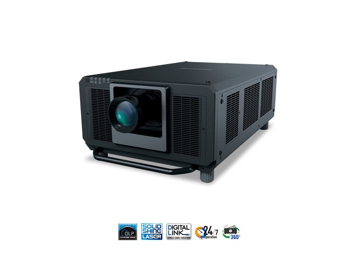

    LASER PROJECTOR 3 DLP Laser Projector
    Model PT-RZ31K
    주요사양 20000 Contrast Ratio
    주요사양 Laser Light Source / 3 Chip DLP Display Display Technology
    주요사양 31000 ANSI Lumens
