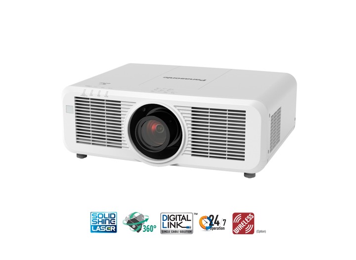

    LASER PROJECTOR 3LCD Laser Projector
    Model PT-MZ670U
    주요사양 16.1 KG's (Weight)
    주요사양 Laser Light Source / LCD Display Technology
    주요사양 6500 ANSI Lumens

    Dimensions (W x H x D)PT-MZ670
    560 x 205*4x 443mm (22-1/16 x 8-1/16*4x 17-7/16inches) (with supplied lens)
    PT-MZ670L
    560 x 205*4x 428mm (22-1/16 x 8-1/16*4x 16-27/32inches) (without lens)
    Weight*5
    PT-MZ670
    Approx. 16.9 kg (37.3 lbs) (with supplied lens)
    PT-MZ670L
    Approx. 16.1 kg (35.5 lbs) (without lens)
