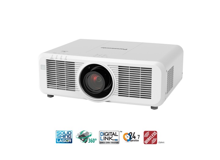

    LASER PROJECTOR 3 LCD Laser Projector
    Model PT-MW530
    주요사양 1280 x 800 (WXGA) Resolution
    주요사양 16.1 KG's (Weight)
    주요사양 Laser Light Source / LCD Display Technology
    주요사양 5500 ANSI Lumens
