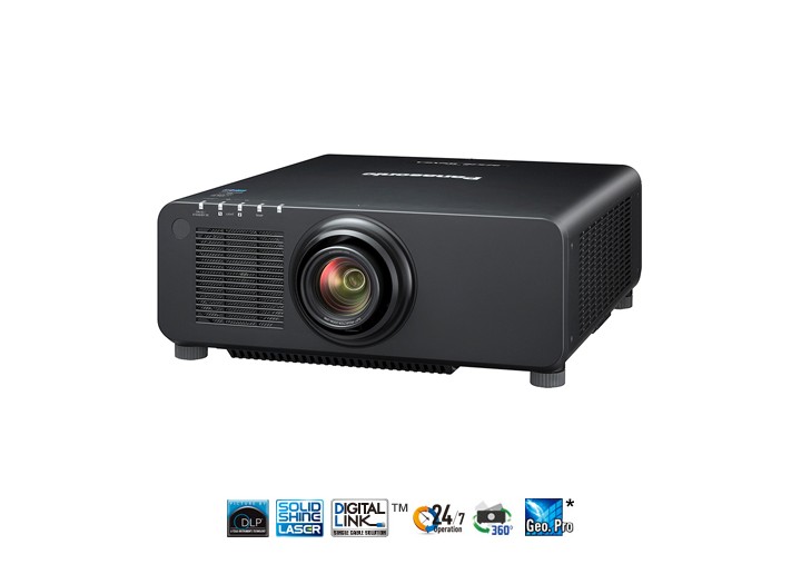

    Model PT-RZ770
    주요사양 10000 Contrast Ratio
    주요사양 7200 ANSI Lumens
    PRODUCT SPECIFICATIONS
    Power supplyAC100 - 240V 8.3A 50Hz/60Hz
    Power consumption825W
    NORMAL: 593W ECO: 508W LONG LIFE1: 333 - 477W
    LONG LIFE 2: 310 - 477W LONG LIFE 3: 286 - 477W SHUTTER: 72W
    STANDBY MODE [ECO]*1: 10.2W STANDBY MODE [NORMAL]: 3W
    STANDBY MODE (When the [QUICK STARTUP] function is enabled): Approx. 85 W
    *Operating Temperature: 25 °C (77 °F), Altitude: 700m (2,297 ft),
    ICE62087: 2008 Broadcast contents,
    Picture mode: Standard, Dynamic Contrast2
    BTU valueMax 2,815 BTU
    Lens | PT-RZ770B/WPowered zoom/focus lenses (1.7-2.4:1), F 1.7-1.9, f 25.6-35.7 mm
    Lens | PT-RZ770LB/LWOptional powered zoom/focus lenses and xed-focus lens
    Light sourceLaser Diode Laser class 1(Class3R for US models)
    * Temperature: 30°C (86°F), Altitude 700m (2,297 ft), Dust: 0.15mg/m3
    Dynamic Contrast3
    43,800 hours at constant luminance (LONG LIFE1)
    61,320 hours at constant luminance (LONG LIFE2)
    87,600 hours at constant luminance (LONG LIFE3)
    Screen size1.27- 15.24 m (50-600 inches) (16:10 aspect ratio)
    *1.27 - 5.08 m (50 - 200 inches) with the ET-DLE055 (16:10 aspect ratio)
    *2.54 - 7.62 m (100 - 350 inches) with the ET-DLE030 (16:10 aspect ratio)
    Brightness*37,200 lumens (Center)*2/ 7,000 lumens*3
    7,000 lumens (Half luminance) (NORMAL)
    5,600 lumens (Half luminance) (ECO)
    2,800 lumens (Constant luminance) (LONG LIFE1)
    2,300 lumens (Constant luminance) (LONG LIFE2)
    1,900 lumens (Constant luminance) (LONG LIFE3)
    Center-to-corner uniformity*390%
    Contrast*310,000:1 (All White/All Black) (Dynamic Contrast3)
    Scanning frequency | SDI3G-3G-SDI signal (RGB 4:4:4 12-bit/10-bit):
    SMPTE ST 424 compliant: 1125(1080)/60i, 1125(1080)/50i,
    1125(1080)/25p, 1125(1080)/24p, 1125(1080)/24sF, 1125(1080)/30p,
    [2K/24p], [2K/25p], [2K/30p]
    3G-SDI signal (YPBPR4:2:2 10-bit):
    SMPTE ST 424 compliant: 1125(1080)/60p, 1125(1080)/50p,
    [2K/48p], [2K/50p], [2K/60p]
    HD-SDI signal (YPBPR4:2:2 10-bit):
    SMPTE ST 292 compliant: 750(720)/60p, 750(720)/50p,
    1125(1080)/60i, 1125(1080)/50i, 1125(1080)/25p, 1125(1080)/24p,
    SD-SDI signal (YCBCR4:2:2 10-bit):
    SMPTE ST 259 compliant: 525i(480i), 625i(576i)3G-
    Scanning frequency | HDMI/DVI-DfH: 15- 100kHz, fV: 24 - 120Hz, dot clock: 25 - 162 MHz
    525i (480i)*4, 625i (576i)*4, 525p (480p), 625p (576p), 750 (720)/60p,
    750 (720)/50p, 1125 (1080)/60i, 1125 (1080)/50i, 1125 (1080)/25p,
    1125 (1080)/24p, 1125 (1080)/24sF, 1125 (1080)/30p, 1125 (1080)/60p,
    1125 (1080)/50p, VGA (640 x 480) - WUXGA (1920 x 1200) compatible
    with non-interlaced signals only
    Scanning frequency | RGBfH: 15- 100kHz, fV: 24 - 120Hz, dot clock: 20 - 162 MHz
    Scanning frequency | YPBPR (YCBCR)525i (480i): fH 15.73 kHz; fV 59.9 Hz,
    625i (576i): fH 15.63 kHz; fV 59.9 Hz,
    Scanning frequency | Video/S-VideofH: 15.73 kHz, fV: 59.9 Hz [NTSC/NTSC4.43/PAL-M/PAL60]
    Optical axis shiftVertical: +50%, -16%(powered),
    Horizontal: +30%, -10%(When using the ET-DLE085, +28%, -10%) (powered)
    NOTE: Optical a xis shift function cannot be operated when used with the ET-DLE055.
    using the ET-DLE030, the optical axis is fixed.
    InstallationCeiling/floor, front/rear, 360 degree free installation
    Terminals | SDI INBNC x 1,
    3G-SDI signal: SMPTE ST 424 compliant
    HD-SDI signal: SMPTE ST 292 compliant
    SD-SDI signal: SMPTE ST 259 compliant
    Terminals | HDMI INHDMI 19-pin x 1, Deep Color, compatible with HDCP
    Terminals | DVI-D INDVI-D 24-pin x 1, DVI 1.0 compliant, compatible with HDCP,
    for single link only
    Terminals | RGB 1 INBNC x 5
    B: 0.7 Vp-p, 75 ohms
    Terminals | RGB 1 IN | Y, PB, PR (Y, CB, CR)Y:1.0 Vp-p (including sync signal), PB/PR (CB/CR): 0.7 Vp-p, 75 ohms
    Terminals | RGB 1 IN | Y/CY: 1.0 Vp-p, C: 0.286 Vp-p, 75 ohms
    Terminals | RGB 1 IN | Video1.0Vp-p, 75 ohms
    Terminals | RGB 2 IN | Y, PB, PR (Y, CB, CR)Y: 1.0 Vp-p (including sync signal), PB/PR(CB/CR): 0.7 Vp-p, 75 ohms
    Terminals | SERIAL/MULTI PROJECTOR SYNC IND-sub 9-pin (female) x 1 for external control (RS-232C compliant)
    Terminals | SERIAL/MULTI PROJECTOR SYNC OUTD-sub 9-pin (male) x 1 for link control
    Terminals | Remoter 1 OutM3 jack x 1 for link control (for wired remote control)
    Terminals | Remoter 2 InD-sub 9-pin (female) x1 for external control (parallel)
    connection, 100Base-TX, compliant with PJLink™(Class 1)
    Deep Color, HDCP
    Dimensions (W x H x D) | PT-RZ770B/RZ770W498 x 200 *5 x 581mm
    (19-19/32 x 7-7/8*5 x 22-7/8in ) with supplied lens
    Dimensions (W x H x D) | PT-RZ770LB/RZ770LW498 x 200 *5 x 538 mm
    (19-19/32 x 7-7/8*5 x 21-3/16in) without lens
    Weight | PT-RZ770B/RZ770WApprox. 23.2kg (51.1lbs) with supplied lens
    Weight | PT-RZ770LB/RZ770LWApprox. 22.4kg (49.4lbs) without lens
    Operation noise36 dB
    Operating temperature0-45 °C (32-113 °F) *6
    Note*1 When the STANDBY MODE is set to Eco, network functions such as power on over the LAN will not operate.
    *2 The value of the light output at the center region of the projected image is extracted based on the light output measurement method defined by
    the ISO/IEC 21118:2012 international standards.
    *3 Measurement, measuring conditions, and method of notation all comply with ISO 21118 international standards.
    *4 Only compatible with dot clock frequency of 27 MHz (pixel repetition signal).
    *5 with legs at shortest position.
    *6 Limits the luminance when used in locations from 0m to 2,700m (0ft to 8,858ft) above sea level at ambient temperatures of 35°C (95°F) or higher,
    or from 2,700m to 4,200m (8,858ft to 13,780ft) above sea level at ambient temperatures of 25°C (77°F) or higher.
    Brightness7,200 lumens (Center)/ 7,000 lumens
    ResolutionWUXGA 1,920 x 1,200 pixels
    Technology1-Chip DLP Laser
    LCD panel | Display methodDLP™ chip x 1, DLP™ system
    LCD panel | Panel size17.0 mm (0.67 in) diagonal (16:10 aspect ratio)
    LCD panel | Pixels2,304,000 (1920 x 1200) x 3, total of 6,912,000 pixels
