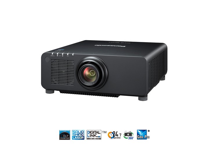

    Model PT-RZ970
    주요사양 10000 Contrast Ratio
    주요사양 10000 ANSI Lumens

    Lens | PT-RZ970B/WPowered zoom/focus lenses (1.7-2.4:1), F 1.7-1.9, f 25.6-35.7 mm
    Lens | PT-RZ970LB/LWOptional powered zoom/focus lenses and xed-focus lens
    Light sourceLaser Diode Laser class 1(Class3R for US models)

    Dimensions (W x H x D)PT-RZ970B/RZ970W:
    498 x 200*5 x 581mm
    (19-19/32 x 7-7/8*5 x 22-7/8in ) with supplied lens
    PT-RZ970LB/RZ970LW:
    498 x 200*5 x 538 mm
    (19-19/32 x 7-7/8*5 x 21-3/16in) without lens
    WeightPT-RZ970B/RZ970W:
    Approx. 23.2kg (51.1lbs) with supplied lens
    PT-RZ970LB/RZ970LW:
    Approx. 22.4kg (49.4lbs) without lens

    Technology1-Chip DLP Laser
    DLP™ chip | Panel size17.0 mm (0.67 in) diagonal (16:10 aspect ratio)
    DLP™ chip | Display methodDLP™ chip × 1, DLP™ system
    DLP™ chip | Pixels2,304,000 (1920 × 1200) × 1, total of 1,024,000 pixels
