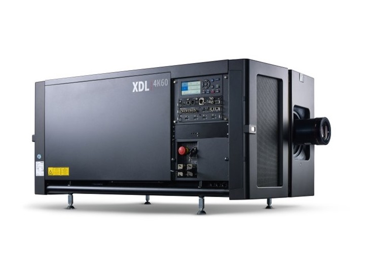

    LASER PROJECTOR 3-Chip 4K Laser Projector
    Model XDL-4K30
    제조사 바코(Barco)
    주요사양 20,000 hrs* Light source lifetime
    주요사양 최고 120Hz의 신호 유연성 제공
    주요사양 30,000루멘, 4K, 3-칩 DLP RGB 레이저 프로젝터
    주요사양 4,096 x 2,160 Resolution
    사양
    Projector typeNative 4K 3-chip DLP digital projector up to 120 Hz
    Technology1.38" DMD™ x3
    Resolution4,096 x 2,160
    Brightness
    Up to 28,000 center lumens using HC lenses / Up to 30,000 center lumens using HB lenses
    29,700 ansi lumen
    33,400 ISO lumen
    Native contrast ratio2,800:1 (typical using HC lenses) / 500:1 ANSI contrast (typical) | 2,000:1 (typical using HB lenses) / 450:1 ANSI contrast (typical)
    Prime lensesHC: 1.13-1.72; 1.35-1.86; 1.46-2.10; 1.65-2.60; 2.00-3.35 / HB : XLD 0.8; 1:0 ; 1.45-1.8; 1.8-2.4; 2.2-3.0; 2.8-5.5; 5.5-8.5
    Optical lens shiftVertical up to +/-100%, depending on lens
    Horizontal up to +/- 32%, depending on lens
    Motorized zoom and focus with memory
    Motorized lens shift with memory
    Light sourceDirect coupled RGB lasers 6P
    Light source lifetime20,000 hrs*
    Color correctionP7
    Optical dowserStandard
    OrientationTilt 45° up and 30° downwards | Rotation – 20 degrees / +90 degrees (=Portrait)
    Sealed DLP™ corestandard
    InputsSlot 1 :Dual HDBt; HDMI 2.0 (HDCP 2.2); DP 1.2 (HDCP 1.3); Quad 3G/12G SDI / BarcoLink | Slot 2: Quad DP1.2
    Input resolutions
    From NTSC up to 4K (4,096 x 2,160) 120 Hz
    refresh rates:
    24hz to 120hz 4K/4KUHD (4096 x 2160/ 3860 x 2160)
    Picture-in-pictureTwo sources simultaneously
    CLO (constant light output)Standard
    ScenergiXHorizontal and vertical edge blending, Direct adjust OSD + toolset
    Image processingEmbedded warp & blend engine
    Keystone correctionYes
    Integrated web serverYes
    Software toolsProjector Toolset
    ControlXLR wired + IR, RS232, Wifi (opt), GSM (opt)
    Network connection10/100 base-T, RJ-45 connection, Wifi (optional)
    Dimensions (WxLxH)Projector: 744 x 1,445 x 706 mm / 29.3 x 56.9 x 27.8 inches (with feet, no lens) one chillers, with the following dimensions: 701 x 701 x 800 mm / 27.6 x 27.6 x 31.5 inches
    WeightProjector: 200kg (~440lb) / Chiller: ~115kg (~250lb)
    Cooling liquid hose length2.5-5-10m (8.2-16.4-32.8ft)
    Power requirementsProjector: 200-240/346-415V 50-60Hz 16A 3W+N+PE (Y connection) / Power cord size range: 4 sq mm to 6 sq mm, 10AWG to 8AWG /Circuit breaker range: 25A to 40A | 200-240V 3W+PE 28A 50-60Hz (/\- connection) / Power cord size: 6 sq mm, 8AWG / Circuit breaker: 40A
    Chillers: 230/400V 3W+N+PE 16A, 2.5 sq mm (Y connection) or 208V / 3W+PE (/\- connection) / Max. 16A per phase
    Ambient temperature10-35°C (95°F) Max. (projector and chillers)
    Operational humidity5-80% (non condens)
    Power consumptionProjector @ full laser power: 3.5 kW (2D or Polarization 3D) / 2.0 kW (Barco Laser3D - 6P)
    Chillers @ full laser power: 2.0 kW (2D or Polarization 3D) / 1.6 kW (Barco Laser3D - 6P)
    3D systemsColor3D (Barco Laser3D): Native 6-primary color-3D system. Only requires color filter glasses / Active glasses systems / Polarization recuperation systems
    Safety classClass 1, RG3
    CertificationsCE; ETL/UL/FCC
