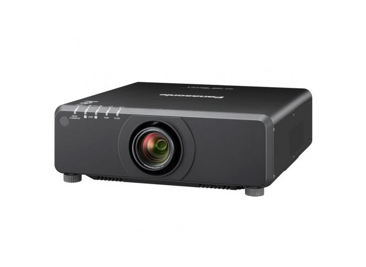

    DLP PROJECTOR 1 DLP Projector PT-DW750BK
    Model PT-DW750
    주요사양 1-Chip DLP, 7000 lumens, WXGA
    주요사양 Dual lamp system with up to 6000 hours lamp life (in eco mode). Lamp relay mode enabes 24/7 operation
    주요사양 Dust-resistant optical engine allows filter-less design
    주요사양 Multi-screen support including edge blending and colour matching function
    Power supply100-240 V AC, 9.0-4.0 A, 50/60 Hz
    DLP™ chip | Panel sizemm (0.65 in) diagonal (16:10 aspect ratio)
    DLP™ chip | Display methodDLP™ chip x 1, DLP™ system
    DLP™ chip | Pixels1,024,000 (1,280 x 800) x 1, total of 1,024,000 pixels
    LENSPT-DW750W/DW750B
    Powered zoom/focus lenses (1.7-2.4:1), F 1.7-1.9, f 25.6-35.7 mm
    PT-DW750LW/DW750LB
    Optional powered zoom/focus lenses and fixed-focus lens
    Lamp310 W UHM lamps (x 2)
    Screen size1.27-15.24 m (50- 600 inches)
    *1.27 - 5.08 m (50 - 200 inches) with the ET-DLE055 (16:10 aspect ratio)
    *2.54 - 8.89 m (100 - 350 inches) with the ET-DLE030 (16:10 aspect ratio)
    Brightness7,000 lumens (dual lamp, LAMP MODE: NORMAL)
    Contrast3,000:1 (full on/full off, in dynamic iris 3 mode)
    Resolution1,280 x 800 pixels
    Scanning frequency | HDMI/DVI-DfH: 15-100 kHz, fV: 24-120 Hz, dot clock: 25-162 MHz
    Scanning frequency | RGBfH: 15-100 kHz, fV: 24-120 Hz, dot clock: 20-162 MHz
    Scanning frequency | YPBPR (YCBCR)525i (480i): fH 15.75 kHz; fV 60 Hz,
    625i (576i): fH 15.63 kHz; fV 50 Hz,
    1125 (1035)/60i: fH 33.75 kHz; fV 60 Hz,
    Optical axis shiftVertical: -16% - +60% (powered),
    horizontal: -10% - +30% (powered)
    (-10% - +28% with the ET-DLE085/DLE105)
    NOTE: Optical axis shift function cannot be operated when used with the ET-DLE055.
    If using the ET-DLE030, the optical axis is fixed.
    Keystone correction rangeVertical ±40°, horizontal: ±15°
    (Vertical: ±22° with the ET-DLE055/DLE085/DLE105),
    (Vertical: ±5° with the ET-DLE030)
    Curved correction (Geometric adjustment)
    4 corner correction
    Terminals | HDMI INHDMI 19-pin x 1, Deep Color, compatible with HDCP
    Terminals | DVI-D INDVI-D 24-pin x 1, DVI 1.0 compliant, HDCP compatible,
    for single link only
    Terminals | RGB 1 INBNC x 5
    B: 0.7 Vp-p, 75 ohms
    NOTE: SYNC/HD and VD terminals do not accept tri-level sync signals.
    Terminals | RGB 1 IN | Y, PB, PR (Y, CB, CR)Y: 1.0 Vp-p (including sync signal), PB/PR (CB/CR): 0.7 Vp-p, 75 ohms
    Terminals | RGB 1 IN | Video signal1.0 Vp-p, 75 ohms
    Terminals | RGB 2 IN | Y, PB, PR (Y, CB, CR)Y: 1.0 Vp-p (including sync signal), PB/PR (CB/CR): 0.7 Vp-p, 75 ohms
    Terminals | SERIAL IND-sub 9-pin (female) x 1 for external control (RS-232C compliant)
    Terminals | SERIAL OUTD-sub 9-pin (male) x 1 for link control (RS-232C compliant)
    Terminals | Remoter 1 OutM3 jack x 1 for link control
    Terminals | Remoter 2 InD-sub 9-pin (female) x 1 for external control (parallel)
    connection, 100Base-TX, compatible with Art-Net, compliant with
    PJLink™ (class 1), Deep Color, compatible with HDCP,
    Terminals | USBDC OUT (5V/0.9A)
    (PT-DW750W/DW750LW : White)
    (PT-DW750B/DW750LB : Black)
    Dimensions (W x H x D)498 x 175 x 521 mm
    (19-19/32 x 6-7/8 x 20-1/2 inches) (with supplied lens)
    498 x 175 x 508 mm
    (19-19/32 x 6-7/8 x 20 inches) (without lens, with lens cover)
    498 x 175 x 498 mm
    (19-19/32 x 6-7/8 x 19-19/32 inches) (without lens and lens cover)
    WeightApprox. 17.8 kg (39.2 lbs) (with supplied lens)
    Approx. 17.0 kg (37.5 lbs) (without lens)
    Operating noise30 dB (dual lamp operation, LAMP MODE: NORMAL),
    28 dB (dual lamp operation, LAMP MODE: ECO)
    Operating temperature0-45 °C (32-113 °F)
    Technology1-Chip DLP
    Scanning frequency | Video/S-VideofH: 15.75 kHz, fV: 60 Hz [NTSC/NTSC4.43/PAL-M/PAL60]
    NoteWeights and dimensions shown are approximate. Specifications and appearance are subject to change without notice.
    *1 When the STANDBY MODE is set to ECO, network functions such as power on over the LAN network will not operate, and the serial output terminal
    cannot be used. Also, only certain commands can be received for external control using the serial terminal.
    *3 With legs at shortest position.
    *4 Average value. May differ depending on models.
    *5 The operating temperature range is 0 °C to 40 °C (32 °F to 104 °F) when the fan control is set to High Altitude mode (for altitudes from 1,400 m
    to 2,700 m (4,593 ft to 8,858 ft) above sea level). Also, if the ambient temperature exceeds 40 °C (104 °F) (35 °C (95 °F) in High Altitude mode)
    when the projector is being used with Lamp Select set to Dual and Lamp Power set to High, the light output may be reduced approximately
    20% to protect the projector.
    Terminals | RGB 1 IN | S-Video signalY: 1.0 Vp-p, C: 0.286 Vp-p, 75 ohms
    Power consumption790 W (810 VA) (0.3 W with STANDBY MODE set to ECO, 3 W with
    STANDBY MODE set to NORMAL)
    max. 2,696 BTU (without light output: 2,601 BTU)
