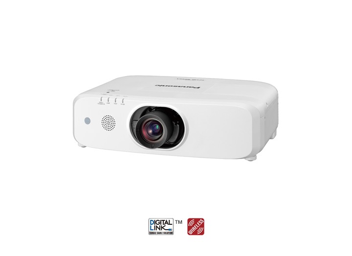

    LCD PROJECTOR 3LCD Projector PT-EW650
    Model PT-EW650
    주요사양 LCD, 5800 lumens, WXGA
    주요사양 High brightness in compact and lightweight body
    주요사양 Dust resistant cabinet and up to 15 000 hours maintenance free Eco Filter
    주요사양 Powered with lens-shift and a wide range of optional lenses
    주요사양 10,000
    Power supplyAC100 - 240V 5.3 - 2.1A 50Hz/60Hz
    Power consumption461W
    Power consumption | Standby Mode (Eco)0.5W, 0.3W (Taiwan)
    Power consumption | Standby Mode (Normal)12W
    Power consumption | Standby Mode (Normal and Audio monitor out)30W
    BTU valueMax 1,573BTU
    LCD panel | Panel size16.3 mm (0.64 in) diagonal (16:10 aspect ratio)
    LCD panel | Display methodTransparent LCD panel (x 3, R/G/B)
    LCD panel | Drive methodActive matrix
    LCD panel | Pixels1,024,000 (1,280 x 800) x 3, total of 3,072,000 pixels
    LENSPowered zoom (throw ratio 1.22-2.26:1),
    powered focus, F 1.6-2.2, f 17.1-31.7 mm
    Lamp320 W UHM lamp
    Lamp replacement cycle
    4,000 hours (lamp power: Normal), 5,000 hours (lamp power: Eco)
    This is the maximum value when the lamp is turned on for 2 hours
    and off for 0.25 hours.
    Screen size1.02- 10.16 m (40-400 inches) (16:10 aspect ratio)
    Brightness5,800 lumens
    (Lamp power: Normal, Dynamic mode, Iris off, Daylight View:off, Auto Power Save:off)
    Contrast10,000:1
    (Lamp power: Normal, Dynamic mode, Iris on, Daylight View:off, Auto Power Save:off)
    Resolution1,280 x 800 pixels (WXGA)
    Scanning frequency | HDMI/DIGITAL LINKfH: 15- 90kHz, fV: 24 - 100Hz, dot clock: 25 - 162 MHz
    Scanning frequency | RGBfH: 15- 90kHz, fV: 24 - 100Hz, dot clock: 162 MHz or lower
    Scanning frequency | YPBPR (YCBCR)525i (480i): fH15.73 kHz; fV59.94 Hz,
    625i (576i): fH15.63 kHz; fV50 Hz,
    525p (480p): fH31.47 kHz; fV60 Hz,
    625p (576p): fH31.25 kHz; fV50 Hz,
    750 (720)/60p: fH45.00 kHz; fV60 Hz,
    750 (720)/50p: fH37.50 kHz; fV50 Hz,
    1125 (1080)/60i: fH33.75 kHz; fV60 Hz,
    1125 (1080)/50i: fH28.13 kHz; fV50 Hz,
    1125 (1080)/25p: fH28.13 kHz; fV25 Hz,
    1125 (1080)/24p: fH27.00 kHz; fV24 Hz,
    1125 (1080)/24sF: fH27.00 kHz; fV48 Hz,
    1125 (1080)/30p: fH33.75 kHz; fV30 Hz,
    1125 (1080)/60p: fH67.50 kHz; fV60 Hz,
    1125 (1080)/50p: fH56.25 kHz; fV50 Hz
    Scanning frequency | Video/S-VideofH: 15.75 kHz, fV: 59.94 Hz [NTSC/NTSC4.43/PAL-M/PAL60]
    Keystone correction rangeVertical ±35°, horizontal ±35°
    Optical axis shiftVertical: ±60% (powered) Horizontal: ±30% (powered )
    InstallationCeiling/ oor, front/rear
    Speaker4.0 cm (1-9/16 in) (monaural) x 1
    Terminals | HDMI In 1/HDMI In 2 | HDMI 19-Pin x2Deep Color, compatible with HDCP,
    Audio signal: linear PCM
    (sampling frequencies: 48 kHz, 44.1 kHz, 32 kHz)
    Terminals | DIGITAL LINK INRJ-45 x 1 (HDBaseT™ compatible), Deep Color, compatible with HDCP,
    Audio signal: linear PCM (sampling frequencies: 48 kHz, 44.1 kHz, 32 kHz)
    Terminals | RGB 1 INBNC x 5
    Terminals | RGB 1 IN | R, G, B0.7 Vp-p, 75 ohms, (G: 1.0 Vp-p, 75 ohms for sync on G)
    H D/VD, SYNC: TTL, high impedance,
    positive/negative automatic
    Terminals | RGB 1 IN | Y, PB, PR (Y, CB, CR)Y: 1.0 Vp-p (including sync signal),
    PBPR(CBCR): 0.7 Vp-p, 75 ohms
    Terminals | RGB 1 IN | Y/CY: 1.0 Vp-p (including sync signal), C: 0.286 Vp-p, 75 ohms
    Terminals | RGB 2 IN | R, G, B0.7 Vp-p, 75 ohms, (G: 1.0 Vp-p, 75 ohms for sync on G)
    NOTE: SYNC/HD and VD terminals do not accept tri-level sync signals.
    Terminals | RGB 2 IN | Y, PB, PR (Y, CB, CR)Y: 1.0 Vp-p (including sync signal),
    Terminals | VIDEO INPin jack x 1, 1.0 Vp-p, 75 ohms
    Terminals | MONITOR OUTD-sub HD 15-pin (female) x 1
    Terminals | MONITOR OUT | R, G, B0.7 Vp-p, 75 ohms, (G: 1.0 Vp-p, 75 ohms for sync on G)
    Terminals | MONITOR OUT | Y, PB, PRY: 1.0 Vp-p (including sync signal), PBPR: 0.7 Vp-p, 75 ohms
    Terminals | AUDIO IN 1/AUDIO IN 2M3 x 2, 0.5 Vrms, input impedance: 22 kilohms or more
    Terminals | AUDIO IN 3Pin jack(L, R) x 1, 0.5 Vrms, input impedance: 22 kilohms or more
    Terminals | VARIABLE AUDIO OUTM3 x 1 (monitor out, stereo)
    0-2.0 Vrms, variable, output impedance: 2.2 kilohms or less
    Terminals | SERIAL IND-sub 9 p x 1, for external control (RS-232C compliant)
    Terminals | Remoter 1 InD-sub 9-pin (female) x1, for external control (parallel)
    Terminals | Remoter 2 InM3 jack x 1 for wired remote control
    Terminals | LANRJ-45 x 1 for network connection 10Base-T/100Base-TX,
    compatible with Art-Net, PJLink™(Class 1)
    Terminals | WIRELESSUSB Type A x 1, for wireless projection with optional dongle (ET-WML100)
    Terminals | DC OUTUSB Type A x 1, for power supply (DC5 V, max 900 mA)
    Power cord length3.0 m (9 ft10 in)
    Dimensions (W x H x D)498 x 145 x 398.3mm
    (19-19/32 x 5-11/16*3 x 15-11/16 in ) with supplied lens
    WeightApprox. 8.4kg (18.5lbs)
    Operating noise29 dB (Silent), 35 dB (Normal/Eco)
    Operating environment | Operating temperature0-45 °C (32-113 °F)
    Operating environment | Operating humidity20%-80% (no condensation)
    TechnologyLCD
