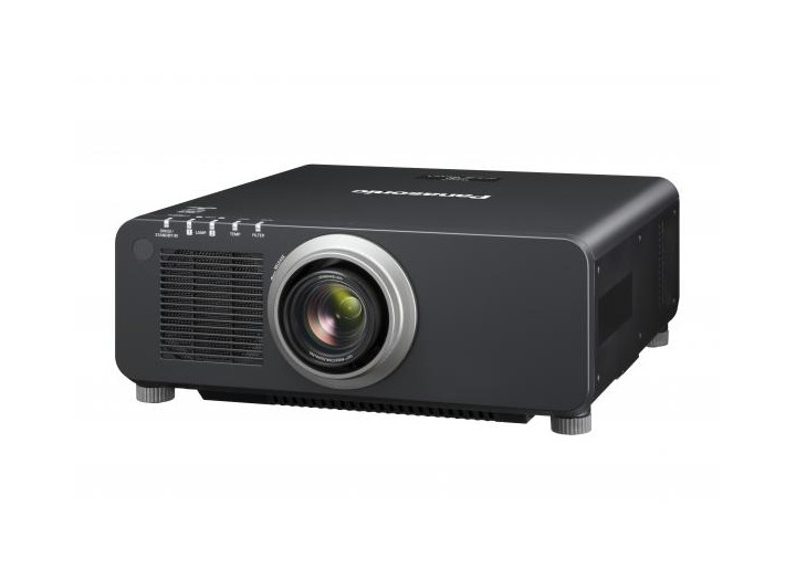

    DLP PROJECTOR 1 DLP Projector PT-DZ870E
    Model PT-DZ870
    주요사양 1-Chip DLP, 8500 lumens, WUXGA
    주요사양 Excellent image quality thanks to the dynamic RGB Booster and Vivid Colour Control
    주요사양 Dual lamp system with lamp relay mode enables 24/7 operation
    주요사양 Eco filter enables up to 12000 hours of air filter replacement cycle
    주요사양 10,000 contrast ratio
    Power supply120-240 V AC, 10-5.2 A, 50/60 Hz
    Power Consumption (120-240V AC, 50/60Hz)1,030 W (1,060 VA) (0.3 W with STANDBY MODE set to ECO, 3 W with STANDBY MODE set to NORMAL)
    DLP™ chip Panel size17.0 mm (0.67 in) diagonal (16:10 aspect ratio)
    DLP™ chip Display methodDLP™ chip x 1, DLP™ system
    DLP™ chip Pixels2,304,000 (1,920 x 1,200) x 1, total of 2,304,000 pixels
    Lens PT-DZ870K/DZ870WPowered zoom/focus lenses (1.7-2.4:1), F 1.7-1.9, f 25.6-35.7 mm
    Lens PT-DZ870LK/DZ870LWOptional powered zoom/focus lenses and fixed-focus lens
    Lamp420 W UHM lamps (x 2)
    Screen size1.27 -15.24 m (50-600 inches) (1.27-5.08 m (50-200 inches) with the ET-DLE055 (16:10 aspect ratio)) (2.54-8.89 m (100-350 inches) with the ET-DLE030 (16:10 aspect ratio))
    Brightness8,500 lumens (dual lamp, LAMP MODE: NORMAL)
    Contrast10,000:1 (full on/full off, in dynamic iris 3 mode)
    Resolution1,920 x 1,200 pixels
    Scanning Frequency (SDI)3G-SDI signal (RGB 4:4:4 12-bit/10-bit): SMPTE ST 424 compliant: 1125(1080)/60i, 1125(1080)/50i, 1125(1080)/25p, 1125(1080)/24p, 1125(1080)/24sF, 1125(1080)/30p; 3G-SDI signal (YPBPR 4:2:2 10-bit): SMPTE ST 424 compliant: 1125(1080)/60p, 1125(1080)/50p; HD-SDI signal (YPBPR 4:2:2 10-bit): SMPTE ST 292 compliant: 750(720)/60p, 50(720)/50p, 1125(1035)/60i, 1125(1080)/60i, 1125(1080)/50i, 1125(1080)/25p, 1125(1080)/24p, 1125(1080)/24sF, 1125(1080)/30p; SD-SDI signal (YCBCR 4:2:2 10-bit): SMPTE ST 259 compliant: 525i(480i), 625i(576i)
    Scanning Frequency (HDMI/DVI-D)fH: 15-100 kHz, fV: 24-120 Hz, dot clock: 25-162 MHz
    Scanning Frequency (RGB)fH: 15-100 kHz, fV: 24-120 Hz, dot clock: 162 MHz or lower
    Scanning frequency YPBPR (YCBCR)525i(480i): fH 15.75 kHz; fV 60 Hz, 625i(576i): fH 15.63 kHz; fV 50 Hz, 525p (480p): fH 31.50 kHz; fV 60 Hz, 625p(576p): fH 31.25 kHz; fV 50 Hz, 750 (720)/60p: fH 45.00 kHz; fV 60 Hz, 750(720)/50p: fH 37.50 kHz; fV 50 Hz, 1125(1035)/60i: fH 33.75 kHz; fV 60 Hz, 1125(1080)/60i: fH 33.75 kHz; fV 60 Hz, 1125(1080)/50i: fH 28.13 kHz; fV 50 Hz, 1125(1080)/25p: fH 28.13 kHz; fV 25 Hz, 1125(1080)/24p: fH 27.00 kHz; fV 24 Hz, 1125(1080)/24sF: fH 27.00 kHz; fV 48 Hz, 1125(1080)/30p: fH 33.75 kHz; fV 30 Hz, 1125(1080)/60p: fH 67.50 kHz; fV 60 Hz, 1125(1080)/50p: fH 56.25 kHz; fV 50 Hz
    Scanning Frequency (Video/Svideo)fH: 15.75 kHz, fV: 60 Hz [NTSC/NTSC4.43/PALM/PAL60]; fH: 15.63 kHz, fV: 50 Hz [PAL/PALN/SECAM]
    Optical axis shiftVertical: +50% (powered), horizontal: ±10% (powered); NOTE: Optical If using the ET-DLE030, the optical axis is fixed. axis shift function cannot be operated when used with the ET-DLE055.
    Keystone correction rangeVertical ±40°(vertical ±30° with the ET-DLE055/DLE085/DLE105, vertical +5° with the ET-DLE030); When using only the KEYSTONE correction of the Geometric Adjustment function: Vertical ±40°, horizontal ±15°(vertical ±30° and horizontal ±15° with the ET-DLE055/DLE085/DLE105); When using the optional upgrade kit ET-UK20: Vertical ±45° and horizontal ±40°(vertical ±22° and horizontal ±15° with the ET-DLE055/DLE085/DLE105, vertical +5° with the ET-DLE030); When using both the KEYSTONE and CURVED corrections of the Geometric Adjustment function: Vertical ±20°, horizontal ±15°(vertical ±8° and horizontal ±8° with the ET-DLE055/DLE085/DLE105)
    Terminals SDI INBNC x 1, 3G-SDI signal: SMPTE ST 424 compliant; HD-SDI signal: SMPTE ST 292 compliant; SD-SDI signal: SMPTE ST 259 compliant
    Terminals HDMI INHDMI 19-pin x 1, Deep Color, compatible with HDCP, 525i(480i), 625i(576i), 525p(480p), 625p(576p), 750(720)/60p, 750(720)/50p, 1125(1080)/60i, 1125(1080)/50i, 1125(1080)/25p, 1125(1080)/24p, 1125(1080)/24sF, 1125(1080)/30p, 1125(1080)/60p, 1125(1080)/50p; VGA(640 x 480) - WUXGA(1,920 x 1,200), dot clock: 25 MHz-162 MHz; NOTE: Compatible with non-interlaced signals only
    Terminals DVI-D INDVI-D 24-pin x 1, DVI 1.0 compliant, HDCP compatible, for single link only; 525i(480i), 625i(576i), 525p(480p), 625p(576p), 750(720)/60p, 750(720)/50p, 1125(1080)/60i, 1125(1080)/50i, 1125(1080)/25p, 1125(1080)/24p, 1125(1080)/24sF, 1125(1080)/30p, 1125(1080)/60p, 1125(1080)/50p; VGA(640 x 480) - WUXGA(1,920 x 1,200), dot clock: 25 MHz -162 MHz; NOTE: Compatible with non-interlaced signals only.
    Terminals RGB 1 INBNC x 5
    Terminals RGB 1 IN R, G, BR: 0.7 Vp-p, 75 ohms; G: 0.7 Vp-p (G: 1.0 Vp-p for sync on G), 75 ohms; B: 0.7 Vp-p, 75 ohms; HD, VD/SYNC: TTL, high impedance, positive/negative automatic; NOTE: SYNC/HD and VD terminals do not accept tri-level sync signals.
    Terminals RGB 1 IN Y, PB, PR (Y, CB, CR)Y: 1.0 Vp-p (including sync signal), PB/PR (CB/CR): 0.7 Vp-p, 75 ohms
    Terminals RGB 1 IN S-Video signalY: 1.0 Vp-p, C: 0.286 Vp-p, 75 ohms
    Terminals RGB 2 IND-sub HD 15-pin (female) x 1
    Terminals RGB 2 IN R, G, BR: 0.7 Vp-p, 75 ohms; G: 0.7 Vp-p (G: 1.0 Vp-p for sync on G), 75 ohms; B: 0.7 Vp-p, 75 ohms; HD, VD/SYNC: TTL, high impedance, positive/negative automatic; NOTE: SYNC/HD and VD terminals do not accept tri-level sync signals
    Terminals RGB 2 IN Y, PB, PR (Y, CB, CR)Y: 1.0 Vp-p (including sync signal), PB/PR (CB/CR): 0.7 Vp-p, 75 ohms
    Terminals 3D SYNC 1 IN/OUTBNC x 1, 1.0 Vp-p, 75 ohms; Input: TTL, high impedance. Output: TTL, max. 10 mA
    Terminals 3D SYNC 2 OUTBNC x 1, 1.0 Vp-p, 75 ohms, TTL, max. 10 mA
    Terminals VIDEO INBNC x 1, 1.0 Vp-p, 75 ohms
    Terminals SERIAL IND-sub 9-pin (female) x 1 for external control (RS-232C compliant)
    Terminals SERIAL OUTD-sub 9-pin (male) x 1 for link control (RS-232C compliant)
    Terminals Remoter 1 InM3 jack x 1 for wired remote control
    Terminals Remoter 1 OutM3 jack x 1 for link control
    Terminals Remoter 2 InD-sub 9-pin (female) x 1 for external control (parallel)
    Terminals LAN/DIGITAL LINKRJ-45 x 1 for network and DIGITAL LINK (video/network/serial control) connection, 100Base-TX, compatible with Art-Net, compliant with PJLink™ (class 1), Deep Color, compatible with HDCP, 525i(480i), 625i(576i), 525p(480p), 625p(576p), 750(720)/60p, 750(720)/50p, 1125(1080)/60i, 1125(1080)/50i, 1125(1080)/25p, 1125(1080)/24p, 1125(1080)/24sF, 1125(1080)/30p, 1125(1080)/60p, 1125(1080)/50p, VGA(640 x 480) - WUXGA(1,920 x 1,200), dot clock: 25 MHz - 162 MHz; NOTE: Compatible with non-interlaced signals only.
    Dimensions (W x H x D) PT-DZ870K/DZ870W498 x 200 x 556 mm (19-19/32 x 7-7/8 x 21-7/8 inches) (with supplied lens)
    Dimensions (W x H x D) PT-DZ870LK/DZ870LW498 x 200 x 513 mm (19-19/32 × 7-7/8 × 20-3/16 inches) (without lens)
    Weight PT-DZ870K/DZ870WApprox. 18.3 kg (40.3 lbs) (with supplied lens)
    Weight PT-DZ870LK/DZ870LWApprox. 17.6 kg (38.8 lbs) (without lens)
    Operation noise40 dB (dual lamp operation, LAMP MODE: NORMAL), 35 dB (dual lamp operation, LAMP MODE: ECO)
    Operating temperature0 ℃ - 45 ℃ (32℉ - 113 ℉)
    Operating humidity10% - 80% (no condensation)
    Technology1-Chip DLP
