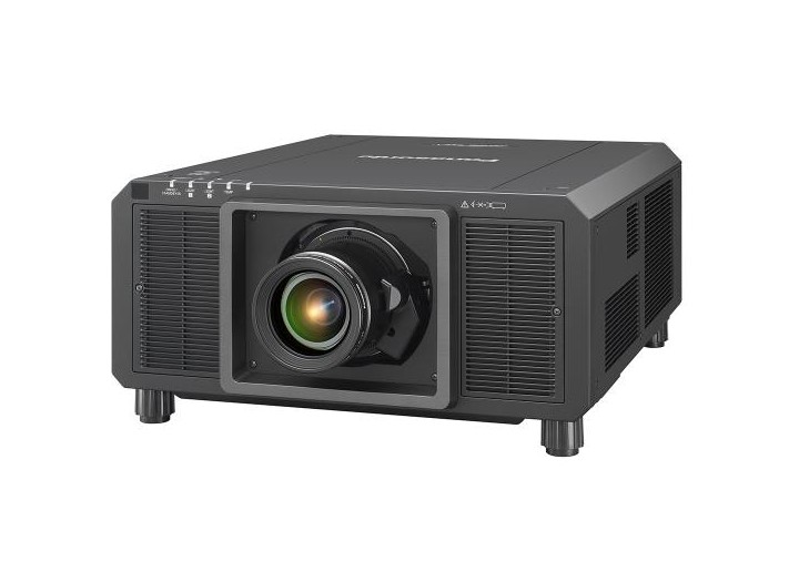

    LASER PROJECTOR 3 DLP Laser Projector PT-RQ22KU
    Model PT-RQ22KU
    주요사양 Laser 3-chip DLP, 21,000 center lumens, 4K+
    주요사양 Lamp-free laser projection with dust resistant liquid cooling system with 20,000 hours of free maintenance
    주요사양 5K pixel performance with a quad pixel drive system on a WQXGA chipse
    주요사양 240Hz high frame rate for superb and sharp motion pictures and a 20,000
    주요사양 Geometric Manager Pro, colour matching and multiple screens edge blending, Exchangeable lens, 24/7 operation, geometric adjustment, 360° flexible installation
    Brightness21,000 lm (Center)*2 / 20,000 lm*3
    Resolution4K+ (5120 x 3200) (Quad Pixel Drive: ON)
    TechnologyLaser 3-chip DLP
    DLP™ chip | Panel size (mm)22.9 mm diagonal (16:10 aspect ratio)
    DLP™ chip | Panel size (inch)0.9 inch diagonal (16:10 aspect ratio)
    DLP™ chip | Display methodDLP™ chip x 3, DLP™ projection system
    DLP™ chip | Pixels49,152,000 (12,288,000 x 4) pixels when Quad Pixel Drive set to ON, 4,096,000 (2560 x 1600) x 3, total of 12,288,000 pixels when Quad Pixel Drive set to OFF
    Refresh Rate240 Hz*1
    LENSOptional (no lens included with this model)
    Light sourceLaser diodes (Laser class: Class 1) (Class 3R for US models), Light source life: 20,000 hours (NORMAL mode, brightness decreases to approx. 50 %)
    Screen size (diagonal) (mm)1.78-25.4 m with 16:10 aspect ratio
    1.78-15.24 m with the ET-D75LE8 / ET-D3LET80, 16:10 aspect ratio
    3.05-15.24 m with the ET-D75LE95, 16:10 aspect ratio
    Screen size (diagonal) (inch)70-1,000 inch with 16:10 aspect ratio
    70-600 inch with the ET-D75LE8 / ET-D3LET80, 16:10 aspect ratio
    120-600 inch with the ET-D75LE95, 16:10 aspect ratio
    Center-to-corner uniformity*390 %
    Contrast*320,000:1 (Full On/Full Off, Dynamic Contrast Mode: 3)
    Optical axis shift*5 | Vertical (from center of screen)±59 % (±56 % with ET-D75LE6 / ET-D3LEW60, +69 % - +84 % with ET-D75LE95) (powered)
    Optical axis shift*5 | Horizontal (from center of screen)±29 % (±19 % with ET-D75LE6 / ET-D3LEW60, ±21 % with ET-D75LE95) (powered)
    Keystone correction rangeVertical: ±40° (± 22° with ET-D75LE50 / ET-D3LEW50, ±28° with ET-D75LE6 / ET-D3LEW60, +5° with ET-D75LE95),
    Horizontal: ±15° (0° with ET-D75LE95)
    Keystone correction range with optional Upgrade Kit ET-UK20Vertical: ±45° (± 40° with ET-D75LE10 / ET-D3LEW10, ET-D75LE20 / ET-D3LES20, ±22° with ET-D75LE50 / ET-D3LEW50,
    Horizontal: ±40° (±15° with ET-D75LE50 / ET-D3LEW50, ET-D75LE6 / ET-D3LEW60, ET-D75LE10 / ET-D3LEW10, 0° with ET-D75LE95),
    Up to a total of ±30° during simultaneous horizontal and vertical correction
    InstallationHorizontal/vertical, free 360-degree installation

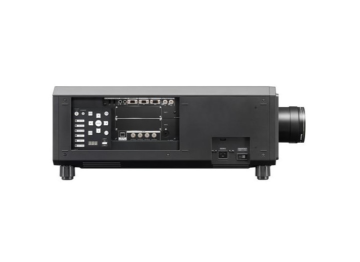

    Terminals | SDI 1 INBNC x 1: 3G/HD/SD-SDI input, Dual-link HD-SDI (Link-A), Dual-link 3G-SDI (Link 1), Quad-link HD-SDI (Link 1), Quad-link 3G-SDI (Link 1)
    Terminals | SDI 2 INBNC x 1: 3G/HD/SD-SDI input, Dual-link HD-SDI (Link-B), Dual-link 3G-SDI (Link 2), Quad-link HD-SDI (Link 2), Quad-link 3G-SDI (Link 2)
    Terminals | SDI 3 INBNC x 1: 3G/HD/SD-SDI input, Dual-link HD-SDI (Link-A), Dual-link 3G-SDI (Link 1), Quad-link HD-SDI (Link 3), Quad-link 3G-SDI (Link 3)
    Terminals | SDI 4 INBNC x 1: 3G/HD/SD-SDI input, Dual-link HD-SDI (Link-B), Dual-link 3G-SDI (Link 2), Quad-link HD-SDI (Link 4), Quad-link 3G-SDI (Link 4)
    Terminals | MULTI PROJECTOR SYNC INBNC x 1
    Terminals | MULTI PROJECTOR SYNC OUTBNC x 1
    Terminals | SERIAL IND-sub 9-pin (female) x 1 for external control (RS-232C compliant)
    Terminals | SERIAL OUTD-sub 9-pin (male) x 1 for link control
    Terminals | REMOTE 1 INM3 x 1 for wired remote control, link control
    Terminals | REMOTE 1 OUTM3 x 1 for wired remote control, link control
    Terminals | REMOTE 2 IND-sub 9-pin (female) x 1 for external control (parallel)
    Terminals | LAN/DIGITAL LINKRJ-45 x 1 for network, DIGITAL LINK connection (HDBaseT™ compliant), 100Base-TX, compatible with Art-Net, PJLink™ (Class 2), Deep Color, HDCP2.2
    Terminals | DC OUTUSB Type A x 2 (for power supply DC 5V total of 2 A)
    Terminals | Expansion SlotSLOT 1 / SLOT 2 (total two terminals, vacant) for interface boards, SLOT NX compatible
    Power supplyAC 200-240 V, 50/60 Hz; AC 100-200 V, 50/60 Hz (brightness is restricted with lower voltage)
    Power consumptionTBD
    Dimensions (W x H x D) (mm)598 x 270 x 725 mm (not including protruding parts)
    Dimensions (W x H x D) (inch)23 17/32 inch x 10 5/8 inch x 28 17/32 inch (not including protruding parts)
    Weight (kg)*6Approx. 55 kg
    Weight (lbs.)*6Approx. 122 lbs
    Operating noise*3TBD
    Operating environment (℃/M)Operating temperature: 0-45 °C *6, operating humidity: 10-80 % (no condensation)
