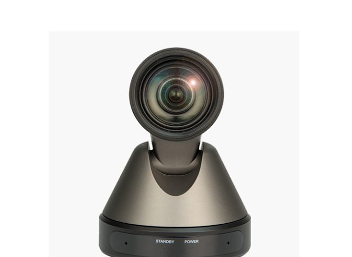

PTZ CAMERA HD PTZ Conference Camera
Model | V71H / V71S |
제조사 | VHD |
주요사양 | H.265 인코딩 지원 |
주요사양 | 1080P Full HD |
주요사양 | 72.5도 와이드 앵글 |
주요사양 | 12배 광학줌 및 16배 디지털 줌 |
주요사양 | HDMI Out / SDI Out 모델 구성 |
- PREVIOUSLive Production Switcher
- NEXTThunderbolt 3 Capture
●Ultra-high Frame Rate
The output frame rate up to 60fps in 1080P.
●Low-light
High SNR of CMOS sensor combined with 2D and 3D noise reduction algorithm, effectively reduce the noise, even under low illumination conditions, picture can still keep clean and clear.
●Remote Control
Using RS232 interface, all the parameters of the camera can be remote controlled by the high-speed communications.
Camera
Video System 1080p/60, 1080p/50, 1080i/60, 1080i/50, 1080p/30, 1080p/25, 720p/60, 720p/50, 720p/30, 720p/25
Sensor 1/2.7'', CMOS, Effective Pixel: 2.07M
Scanning Mode Progressive
Lens 12x, f3.5mm ~ 42.3mm, F1.8 ~ F2.8
Digital Zoom 16x
Minimal Illumination 0.5 Lux @ (F1.8, AGC ON)
Shutter 1/30s ~ 1/10000s
White Balance Auto, Indoor, Outdoor, One Push, Manual, Specified color temperature
Backlight Compensation Support
Digital Noise Reduction 2D&3D Digital Noise Reduction
Video S/N ≥55dB
Horizontal Angle of View 72.5° ~ 6.9°
Vertical Angle of View 44.8° ~ 3.9°
Horizontal Rotation Range ±170°
Vertical Rotation Range -30° ~ +90°
Pan Speed Range 1.7° ~ 100°/s
Tilt Speed Range 1.7° ~ 69.9°/s
H & V Flip Support
Image Freeze Support
Number of Preset 255
Preset Accuracy 0.1°
Input Voltage DC 12V
Current Consumption 1.0A (Max)
Power Consumption 12W (Max)
Size 144 mm x 144 mm x 167mm
Net Weight 1.25 Kg
Digital Zoom 16x
Video S/N ≥55dB
H & V Flip Support
Net Weight 1.25 Kg

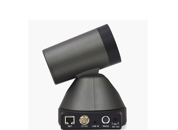

Input/Output Interface
HD Interface 1xHDMI: Version 1.3
Network Interface 1xRJ45: 10M/100M Ethernet Interface
Audio Interface 1-ch: 3.5mm Audio Interface, Line In
Communication Interface 1xRS232 In: 8pin Min DIN, Max Distance: 30m, Protocol: VISCA/Pelco-D/Pelco-P
Power Jack JEITA type (DC IN 12V)
