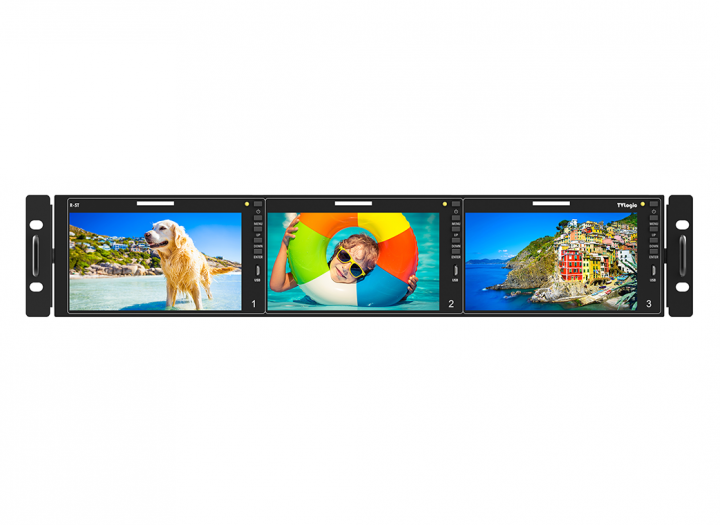

    MONITOR MultiChannel LCD Rack Monitor
    Model R-5T
    제조사 티브이로직(TVLogic)
    주요사양 3개의 5.5인치 화면을 갖춘 멀티채널 모니터
    주요사양 Waveform/Vectorscope, Focus Assist, Luma(Y’) Zone Check, Range Error, UMD, Time Code Display, Audio Level Meter 등 다양한 기능 제공
    주요사양 H/V Delay, Key Lock 기능 지원
    주요사양 Full HD 해상도와 12G/6G/3G-SDI 입, 출력, HDMI 입력을 지원
    주요사양 Pixel Mapping Modes for SD/HD 기능
    R-5T

    Display Spec.
     Size 5.5"
     Resolution 1920 X 1080 (16:9)
     Pixe Pitch 0.0213(W) x 0.0639(H)
     Color Depth 16.7M
     Viewing Angle 160°(H) / 160°(V)
     Luminance 500cd/m2
     Contrast Ratio 1,000:1
     Display Area 122.7(H) × 69.0(V) mm
    Input
     2 X BNC 3G-SDI A/B Channel Input
     1 X HDMI  HDMI Input
    Output
     2 X BNC  HD SDI A/B Channel Output
    Audio
     Audio Out -
    FPGA Functions
     1:1 Pixel Mapping Modes for SD/HD,  3G-SDI Level A/B,  Audio Level Meter Display,  Blue Only,  Focus Assist,  H/V Delay,  H/V Flip,  Key Lock,  Luma(Y') Zone Check,  Marker,  Mono,  Range Error,  Time Code Display,  UMD,  User Aspect,  Various Scan Modes,  Waveform/Vector,  Zoom
    Closed Caption
    Calibration
     TVLogic Color Calibration Utility, 3D LUT & Adjustable Gamma, 3rd Party 3D LUT Import
    Other Functions
     REMOTE  GPI (RJ45)
     USB  Firmware update by USB memory stick
     Ethernet  Ethernet Control support
     Conversion   SDI-to-SDI,
