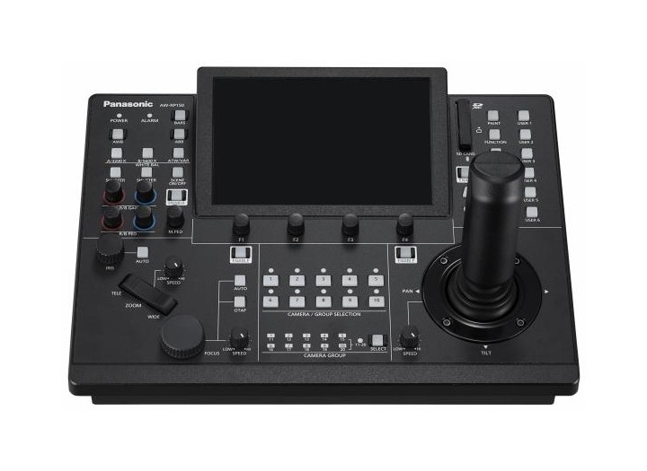

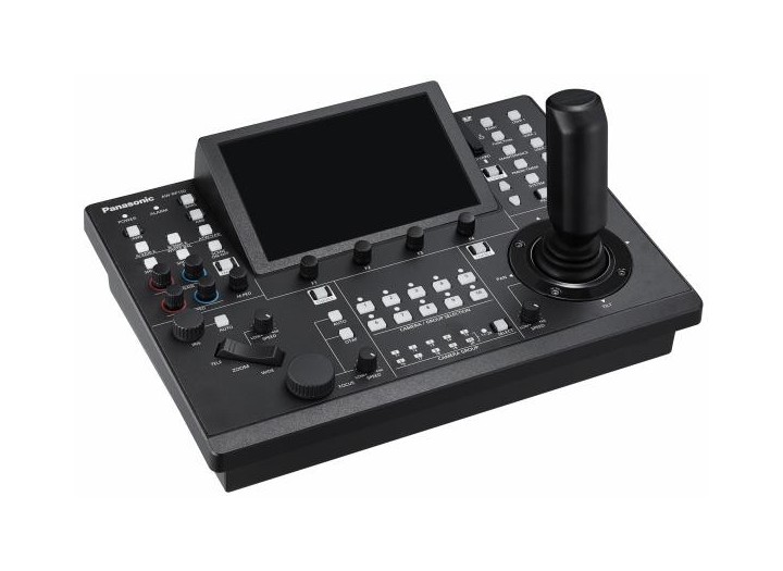

주요사양 | New joystick for one-handed operation |
주요사양 | Simplified PTZ camera presets and tracing memory |
주요사양 | Intuitive design elements based on direct feedback from everyday robotic camera operators |

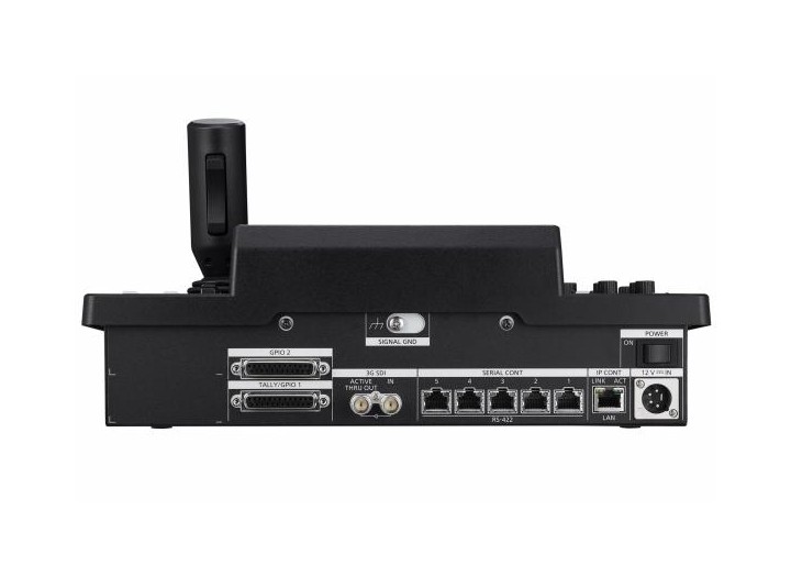

주요사양 | 3G-SDI Active Through Output, 5 x RS-422, LAN PoE+, 2 x GPIOs |
주요사양 | Large touchscreen for easy usability |

Input/Output Connector | - |
INPUT | DC 12 V IN XLR 4-pin 3G-SDI IN SMPTE292 / 75 Ω (BNC x 1) Supported formats: 1080/59.94p*2, 1080/50p*2, 1080/59.94i, 1080/50i, 1080/23.98p, 1080/25p, 1080/23.98PsF, 1080/25PsF |
OUTPUT | ACTIVE THRU OUT SMPTE292 / 75 Ω (BNC x 1) |
INPUT/OUTPUT | IP CONT: ======== 100BASE-TX ---------- PoE+ input ---------- Connection cable: LAN cable, max. 100 m (328 ft) ・When connecting the unit via a switching hub: Straight cable or a cross cable (category 5 cable), STP (Shielded Twisted Pair) cable recommended ・When connecting the unit directly: Crossover cable (category 5 cable), STP (Shielded Twisted Pair) cable recommended ================ SERIAL CONT (RJ-45): ======== RS-422 (control signals for remote cameras), TALLY OUT ---------- Connecting cable: Straight cable (category 5e or better shielded cable), max. 1000 m (3280 ft) ---------- TALLY OUT: Open collector output (negative logic) Maximum voltage resistance DC 24 V, Maximum current 50 mA ================ TALLY/GPIO 1 ======== D-sub 25-pin, female, inch thread ---------- TALLY IN : 10 inputs (for receiving photocoupler signals) ---------- GPI : 6 inputs (for receiving photocoupler signals) GPIO : 5 inputs (for receiving photocoupler signals) or 5 outputs (open collector outputs, negative logic) ・Input/output switched with menu settings ================ GPIO 2 ======== D-sub 25-pin, female, inch thread ---------- GPI : 10 inputs (for receiving photocoupler signals) GPIO : 10 inputs (for receiving photocoupler signals) or 10 outputs (open collector outputs, negative logic) ・Input/output switched with menu settings Reserve connectors: 2 connectors (For future expansion feature) |
LCD Display | 7-inch Touch Panel GUI Monitor (WVGA (800×480) ) |

No. of Camera Selection Buttons | 10 |

No. of User Assignable Buttons | 6 + up to 10 on the LCD menu |
Pan / Tilt Speed Adjustment | 7 levels |
Tally LED display color | green / red |
