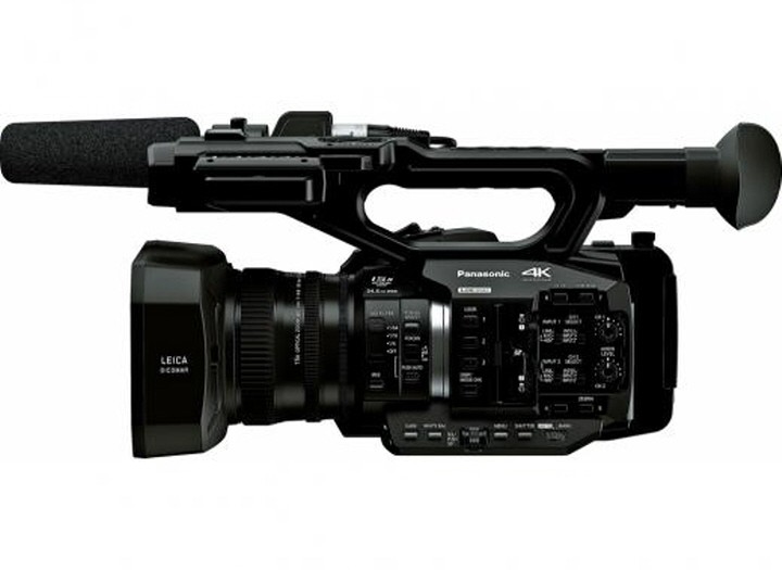

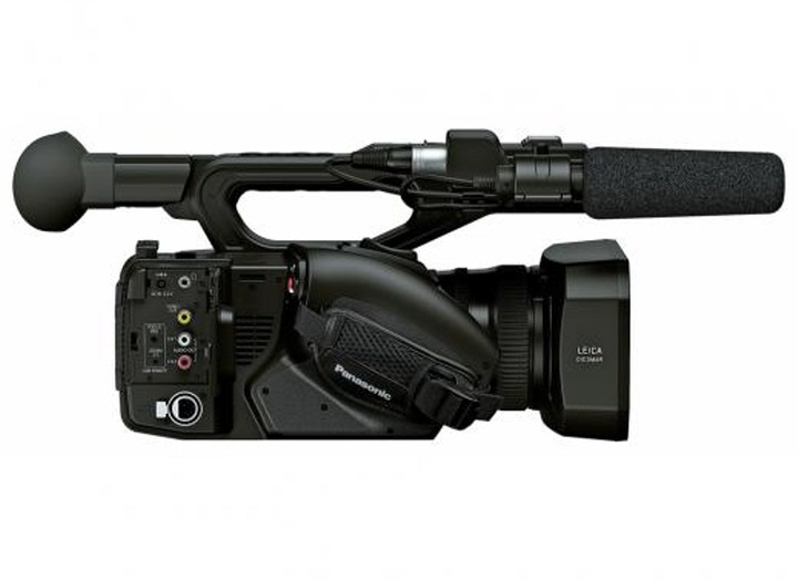

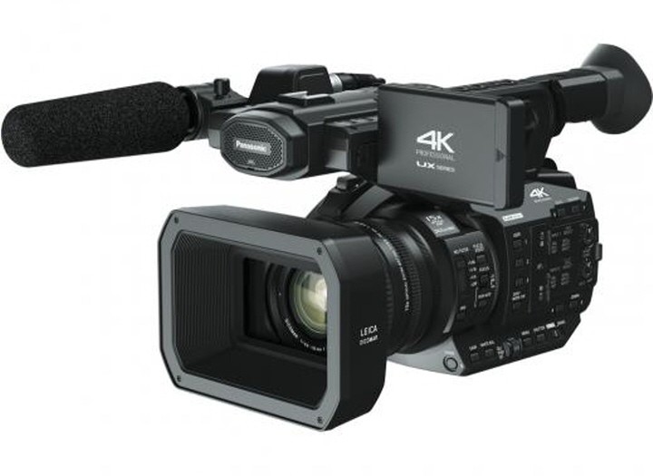

    CAMERA 4K/HD Handheld Camcorder
    Model AG-UX90
    주요사양 Dual SD Card Slots
    주요사양 15x Optical Zoom with O.I.S.
    주요사양 24.5 mm Integrated Wide Lens
