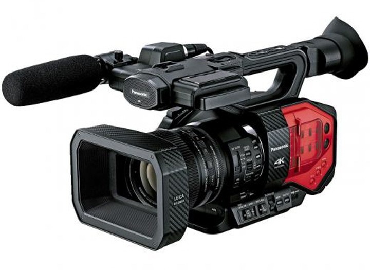

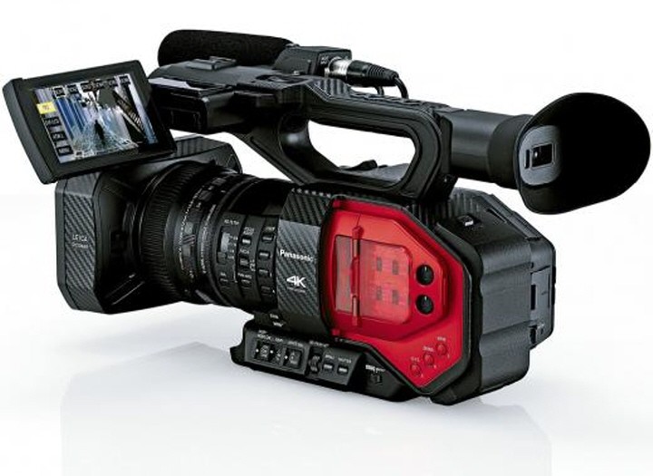

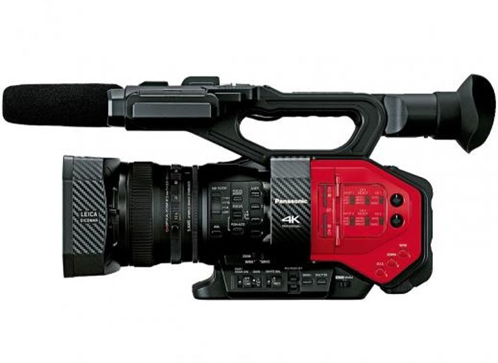

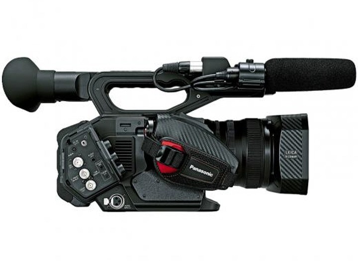

    CAMERA 4K/HD Handheld Camcorder
    Model AG-DVX200
    Lens 4/3-type large format, 4K/60p camcorder to feature an integrated zoom lens
    Frame Full-HD (1920 x 1080) from 2-120fps
    WeightApprox. 2.7 kg (5.95 lb) (body only, excluding lens hood, battery, and accessories)
    Approx. 3.1 kg (6.84 lb) (including lens hood, battery, and eye cup)
    PowerDC 7.2 V (when the battery is used)
    DC 12 V (when the AC adaptor is used)
    Operating temperature0 °C to 40 °C (32 °F to 104 °F)
    Power consumption21.7 W
    Operating humidity10 % RH to 80 % RH (no condensation)
    LENSOptical image stabilizer lens, optical 13x motorized zoom
    F2.8 to F4.5 (f=12.8 mm to 167 mm)
    35 mm equivalent:
    FHD: 28.0 mm to 365.3 mm
    UHD 59.94p/50.00p: 37.2 mm to 485.1 mm
    UHD 29.97p/25.00p: 30.6 mm to 398.7 mm
    4K 24p: 29.5 mm to 384.9 mm
    General-
    ND filterOFF, 1/4, 1/16, 1/64
    Shutter SpeedWhen [SYSTEM MODE] = 59.94 Hz
    • 60i/60p mode: 1/60 sec., 1/100 sec., 1/120 sec., 1/180 sec.,
    1/250 sec., 1/350 sec., 1/500 sec., 1/750 sec., 1/1000 sec.,
    1/1500 sec.,1/2000 sec.,1/3000 sec., 1/4000 sec.,1/8000 sec.
    • 30p mode: 1/30 sec.,1/50 sec.,1/60 sec., 1/100 sec., 1/120 sec.,
    1/180 sec., 1/250 sec., 1/350 sec., 1/500 sec., 1/750 sec.,
    1/1000 sec., 1/1500 sec., 1/2000 sec., 1/3000 sec.,1/4000 sec.,
    1/8000 sec.
    • 24p mode: 1/24 sec., 1/48 sec., 1/50 sec., 1/60 sec., 1/100 sec.,
    1/120 sec., 1/180 sec., 1/250 sec., 1/350 sec., 1/500 sec.,
    1/750 sec., 1/1000 sec., 1/1500 sec., 1/2000 sec., 1/3000 sec.,
    1/4000 sec., 1/8000 sec.
    When [SYSTEM MODE] = 50.00 Hz
    • 50i/50p mode: 1/50 sec., 1/60 sec., 1/100 sec., 1/125 sec.,
    • 25p mode: 1/25 sec., 1/50 sec., 1/60 sec., 1/100 sec.,
    1/125 sec., 1/180 sec., 1/250 sec., 1/350 sec., 1/500 sec.,
    Slow Shutter SpeedWhen [SYSTEM MODE] = 59.94 Hz
    • 60i/60p mode: 1/2 sec., 1/4 sec., 1/8 sec., 1/15 sec., 1/30 sec.
    • 30p mode: 1/2 sec., 1/4 sec., 1/8 sec., 1/15 sec.
    • 24p mode: 1/2 sec., 1/3 sec., 1/6 sec., 1/12 sec.
    • 50i/50p mode: 1/2 sec., 1/3 sec., 1/6 sec., 1/12 sec., 1/25 sec.
    • 25p mode: 1/2 sec., 1/3 sec., 1/6 sec., 1/12 sec.
    Recording MediaSDHC memory card (4 GB to 32 GB),
    SDXC memory card (48 GB to 128 GB), UHS-I supported
    *An SD memory card with a capacity of UHS Speed Class 3 (U3)
    is required to shoot videos with a bit rate of 100 Mbps or higher.
    An SDXC memory card with a capacity of 64 GB or more and
    UHS Speed Class 3 (U3) is required to shoot UHD 2160/59.94p/
    50.00p videos with a bit rate of 150 Mbps or higher.
    Recording FormatWhen [Dual Codec] = FHD 50 Mbps
    [Main Recorder]
    Recording mode = MOV/MP4
    •UHD/29.97p/25.00p/23.98p 100 Mbps
    [Sub Recorder]
    Recording mode = Same as the recording mode and the frame
    rate of the main recorder
    •FHD/29.97p/25.00p/23.98p 50Mbps
    When [Dual Codec] = FHD 8 Mbps
    [Main Recorder]
    •FHD/59.94p/50.00p/29.97p/25.00p/23.98p 200 Mbps
    •FHD/59.94p/50.00p 100 Mbps
    [Sub Recorder]
    •FHD/59.94p/50.00p/29.97p/25.00p/23.98p 8 Mbps
    HDMI OUTHDMI x 1
    (HDMI type A terminal, not compatible with VIERA Link)
    Output format:
    2160/59.94p/50.00p/29.97p/25.00p/24.00p/23.98p,
    1080/59.94p/50.00p/29.97p/25.00p/24.00p/23.98p/59.94i/50.00i,
    720/59.94p/50.00p, 480/59.94p, 576/50.00p
    Effective PixelsFHD (1920 x 1080): 15.49 megapixel
    UHD (3840 x 2160) 59.94p/50.00p: 8.71 megapixel
    UHD (3840 x 2160) 29.97p/25p.00: 12.89 megapixel
    4K (4096 x 2160) 24p: 13.35 megapixel
    Filter Diameter72 mm
    DIGITAL ZOOM2x/5x/10x, i.Zoom (1.0x to 1.54x, variable zoom)
    VIDEO OUTPUTBNC x 1, Composite 1.0 V [p-p], 75 Ω
    Built-in microphoneSupports stereo microphone
    AUDIO OUTPUT-
    AUDIO INPUT-
    Dimensions181 mm (W) x 216 mm (H) x 374 mm (D)
    (excluding protrusion and eye cup)
    (7-1/8 inches x 8-1/2 inches x 14-23/32 inches)
    Headroom12 dB
    Lens HoodHood with lens cover
    SensitivityWhen [HIGH SENS.] mode
    F11 (2,000 lx, 3,200 K, 89.9% reflect, 1080/59.94i)
    F12 (2,000 lx, 3,200 K, 89.9% reflect, 1080/50i)
    Recording audio signal48 kHz/16 bit, 2 CH
    Recording video signal8 bit 4:2:0
    Super Gain30 dB and 36 dB switched
    (when assigning [S.GAIN] to the USER button)
    Video input/output-
    Recording MethodMOV, MP4
    Memory Card Recorder-
    Digital Video-
    Digital Audio-
    Audio Compression FormatLPCM (MOV/MP4) Dolby Digital (AVCHD)
    Camera Unit-
    Shortest Shooting Distance (M.O.D.)Approx. 1.0 m from the front lens
    VFR Recording Frame RateWhen [SYSTEM MODE] = 59.94 Hz
    • 60p mode: 2, 15, 30, 40, 55, 58, 60, 62, 65, 75, 90, and 120 fps
    • 30p mode: 2, 15, 26, 28, 30, 32, 34, 45, 60, 75, 90, and 120 fps
    • 24p mode: 2, 12, 18, 20, 22, 24, 26, 28, 30, 36, 48, 60, 72, 84, 96, and 120 fps
    When [SYSTEM MODE] = 50 Hz
    • 50p mode: 2, 12, 25, 33, 45, 48, 50, 52, 55, 62, 75, 100, and 120 fps
    • 25p mode: 2, 12, 21, 23, 25, 27, 30, 37, 50, 62, 75, 100, and 120 fps
    Minimum Subject Illumination0.2 lx (F2.8, gain 18 dB, [1/2 sec.], [HIGH SENS.] mode)
    Recording slotSlot x 2
    System format59.94 Hz / 50 Hz
    Gain settingL/M/H selector switch
    –6 dB to 24 dB (Adjustable in 1dB steps. Negative gain values are
    available only when [EXPAND] is enabled, and the automatic
    setting can be assigned to L/M/H.)
    Synchro Scan ShutterWhen [SYSTEM MODE] = 59.94 Hz
    • 60i/60p mode: 1/60.0 sec. to 1/249.8 sec.
    • 30p mode: 1/30.0 sec. to 1/249.8 sec.
    • 24p mode: 1/24.0 sec. to 1/249.6 sec.
    • 50i/50p mode: 1/50.0 sec. to 1/250.0 sec.
    • 25p mode: 1/25.0 sec. to 1/250.0 sec.
    Pickup Devices4/3-type MOS solid state image sensor
    Color Temperature SettingATW, ATW LOCK, Ach, Bch,
    preset 3200 K/preset 5600 K/VAR (2000 K to 15000 K)
    Shutter Open Angle5.0 deg to 180.0 deg to 360.0 deg
    (in 0.5 deg steps, angle display)
    IR FilterIncorporates the ON/OFF control function
    Motion Picture RecordingRecording Format: MOV, MP4, AVCHD
    Recording Mode: *Please see the Video record mode table.
    Still picture recordingJPEG (DCF/Exif2.2) supported
    8.8M: 4096 x 2160 (17:9), 8.3M: 3840 x 2160 (16:9),
    2.1M: 1920 x 1080 (16:9), 0.2M: 640 x 360 (16:9),
    0.3M: 640 x 480 (4:3)
    Video Signal for External Output8 bit 4:2:2/10 bit 4:2:2 (switchable menu)
    *Output of UHD/59.94p/50.00p becomes 8 bit 4:2:0. When 10 bit
    4:2:2 is selected, recording is not possible with the main unit.
    Dual Codec-
    Video Compression Format (Dual Codec)MPEG-4 AVC/H.264 High Profile
    Audio Compression Format (Dual Codec)LPCM
    Audio Input1/Audio Input2XLR x 2, 3-pin
    Input high impedance, LINE/MIC/MIC+48 V (switchable SW)
    LINE: 4 dBu/0 dBu (switchable menu)
    MIC: –40 dBu/–50 dBu/–60 dBu (menu)
    Headphone3.5 mm diameter stereo mini jack x 1
    DC INDC 12 V (11.4 V to 12.6 V), EIAJ type 4
    LCD monitor4.3 type HD color monitor, Approx. 2,760,000 dots
    Speaker20 mm diameter, round x 1
    TC PRESET IN/OUTBNC x 1,
    Used as the input and output terminals
    Input: 1.0 V to 4.0 V [p-p], 10 kΩ
    Output: 2.0 V ±0.5 V [p-p], low impedance
    Included accessoriesBattery (VW-VBD58), Battery charger, AC adaptor, Shoulder strap, Microphone holder,
    Screw for microphone holder (12 mm), AC cable x 2, Eye cup, Lens hood,
    INPUT terminal cap, CD-ROM (operating instructions)
    Audio OUT3.5 mm diameter stereo mini jack x 1, Output level: 600 Ω, 316 mV
    Cam Remote2.5 mm diameter super mini jack x1 (ZOOM, S/S)
    3.5 mm diameter mini jack x1 (FOCUS, IRIS)
    OTHER INPUT/OUTPUT-
    View Finder0.39 type OLED (organic EL display)
    Approx. 2,360,000 dots, video display area: approx. 1,770,000 dots
    SDI OUT (Audio Output)2 CH (LPCM) switchable gain: 0 dB/–6 dB/–12 dB
    HDMI OUT (Audio Output)2 CH (LPCM)
    USB (Host)Type A connector, 9-pin, bus power supported
    In Recording mode; USB2.0 compatible (5 V, 0.5 A)
    In Playback mode; USB 3.0 compatible (5 V, 0.9 A), used for
    external media device connection
    *External media device with a capacity of 32 GB or below or a
    capacity above 2 TB cannot be used
    USB (Device)Micro-B connector, 10-pin, USB 3.0,
    Mass storage function (read only)
    Monitor/Viewfinder-
