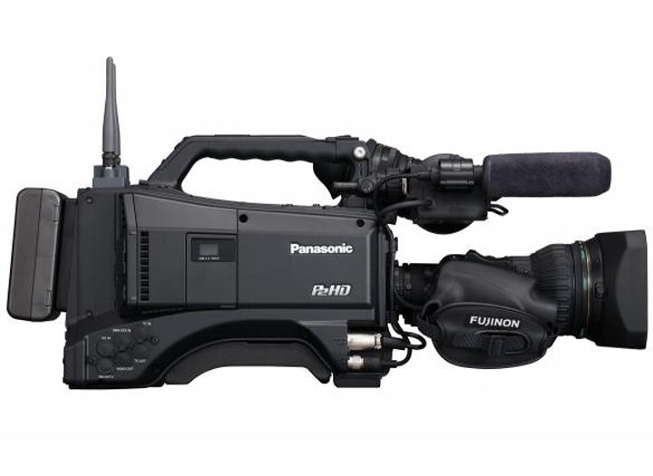

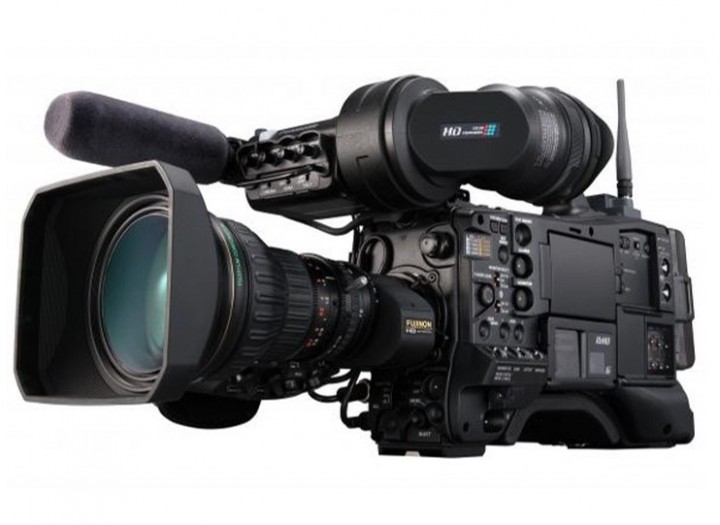

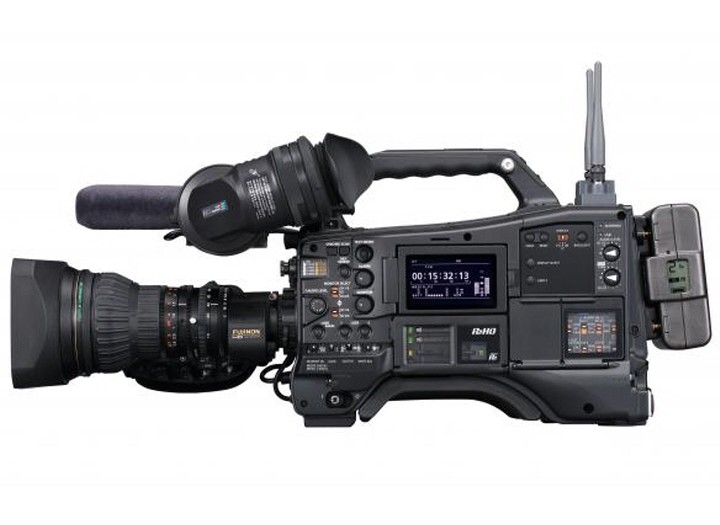

    CAMERA HDR Shoulder ENG Camera
    Model AJ-PX5100
    주요사양 Offers a streaming function compatible with RTMP, in addition to RTSP, and is P2 Cast and P2 Streaming Server compatible
    주요사양 1080/60p recording and 3G-SDI output
    주요사양 AVC-Intra or AVC-LongG high-quality images and dual codec recording of AVC-Proxy
    주요사양 Supports HDR image acquisition and outputs SDR while acquiring HDR
    General-
    Power supplyDC 12V (11.0V to 17.0V)
    Power consumption29W
    (body only, 1080/59.94i, AVC-Intra100 standard recording status, LCD ON)
    70W
    (with all optional accessories connected and maximum power supplied from each output terminal)
    Operating temperature0°C to 40°C (32°F to 104°F)
    Operating humidity10 % to 85 % (relative humidity)
    Storage Temperature-20°C to 60 °C (-4°F to 140°F)
    WeightApprox. 3.4 kg (7.5 lbs.)
    (body only, excluding the battery and accessories)
    Dimensions147 mm (W) x 267 mm (H) x 342 mm (D)
    (5-25/32 inches x 10-1/2 inches x 13-15/32 inches)
    Body only, excluding protrusion
    CAMERA SECTION-
    Pickup Devices2/3-type, 2.2 million pixels, MOS x 3
    Lens Mount2/3-type bayonet
    CC FilterA: 3200 K, B: 4300 K, C: 5600 K, D: 6300 K
    ND filterCLEAR, 1/4, /16, 1/64
    Gain settingNORMAL mode:
    -3 dB, 0 dB, 3 dB, 6 dB, 9 dB, 12 dB, 15 dB, 18 dB, 21 dB, 24 dB, 27 dB, 30 dB
    HIGH SENS mode:
    -6 dB, -3 dB, 0 dB, 3 dB, 6 dB, 9 dB, 12 dB, 15 dB, 18 dB, 21 dB, 24 dB, 27 dB, 30 dB
    Digital Super Gain (DS.GAIN)Selectable from 6 dB, 10 dB, 12 dB, 15 dB, 20 dB, 24 dB, 28 dB, 34 dB
    Super Gain (S.GAIN)Selectable from 30 dB, 36 dB, 42 dB
    Shutter Speed(Preset)[59.94 Hz]
    60i/60p mode: 1/100 sec., 1/120 sec., 1/250 sec., 1/500 sec., 1/1000 sec., 1/2000 sec., HALF
    30p mode: 1/100 sec., 1/120 sec., 1/250 sec., 1/500 sec., 1/1000 sec., 1/2000 sec., HALF
    24p mode: 1/100 sec., 1/120 sec., 1/250 sec., 1/500 sec., 1/1000 sec., 1/2000 sec., HALF
    180.0 deg, 172.8 deg, 144.0 deg, 120.0 deg, 90.0 deg, 45.0 deg
    [50 Hz]
    50i/50p mode: 1/60 sec., 1/120 sec., 1/250 sec., 1/500 sec., 1/1000 sec., 1/2000 sec., HALF
    25p mode: 1/60 sec., 1/120 sec., 1/250 sec., 1/500 sec., 1/1000 sec., 1/2000 sec., HALF
    Shutter Speed(Synchro Scan)60i/60p mode: 1/60.1 sec. to 1/7200 sec.
    30p mode: 1/30.1 sec. to 1/3600 sec.
    24p mode: 1/24.1 sec. to 1/2880 sec.
    50i/50p mode: 1/50.1 sec. to 1/6000 sec.
    25p mode: 1/25.1 sec. to 1/3000 sec.
    Shutter Open AngleConfigurable between 3 deg and 359.5 deg (in 0.5 deg steps)
    SensitivityNORMAL mode:
    F9 (2000 lx, 3200 K, 89.9 % reflection, 1080/59.94i)
    F10 (2000 lx, 3200 K, 89.9 % reflection, 1080/50i)
    HIGH SENS mode:
    F12 (2000 lx, 3200 K, 89.9 % reflection, 1080/59.94i)
    F13 (2000 lx, 3200 K, 89.9 % reflection, 1080/50i)
    Minimum Subject IlluminationApprox. 0.004 lx
    (F1.4, +42 dB (S.GAIN), +34 dB (DS.GAIN))
    Image S/N62 dB (standard)
    System format1080/59.94p, 1080/59.94i, 1080/23.98PsF, 720/59.94p, 480/59.94i, 1080/50p, 80/50i, 720/50p, 576/50i
    Recording FormatsAVC-Intra200/AVC-Intra100/AVC-Intra50/AVC-LongG50/AVC-LongG25/AVC-LongG12/DVCPRO HD/DVCPRO50/DVCPRO/DV formats switchable
    Recording video signal1080/59.94p, 1080/59.94i, 1080/29.97pN, 1080/23.98pN, 720/59.94p, 720/29.97pN, 720/23.98pN, 480/59.94i, 1080/50p, 1080/50i, 1080/25pN, 720/50p, 720/25pN, 576/50i
    Video input/output-
    SDI INBNC x 1
    HD SDI: 3 G: 0.8 V [p-p], 75 Ω
    1.5 G: 0.8 V [p-p], 75 Ω
    SD SDI: 0.8 V [p-p], 75 Ω
    Switch the menu to use as
    terminal/return video input terminal
    terminal
    SDI OUT1BNC x 1
    HD SDI: 3 G: 0.8 V [p-p], 75 Ω,
    SD SDI: 0.8 V [p-p], 75 Ω,
    SDI OUT2BNC x 1
    VIDEO OUTBNC x 1
    Composite: 1.0 V [p-p], 75 Ω
    HDMI OUTHDMI x 1 (HDMI type A terminal, not compatible with VIERA Link)
    Audio Input/Output-
    AUDIO IN (CH1/CH2)XLR x 2, 3-pin, LINE/MIC/MIC +48 V switchable type
    LINE: 4 dBu (-3 dBu/0 dBu/4 dBu selectable menu)
    MIC: -60 dBu (-60 dBu/-50 dBu selectable menu)
    MIC+48 V: Phantom +48 V supported, -60 dBu
    MIC InXLR x 1, 5-pin
    Phantom +48 V (selectable menu),
    -40 dBu (-50 dBu/-40 dBu selectable menu)
    Wireless Slot25-pin, D-SUB, -40 dBu, 2 CH supported
    AUDIO OUT (CH1/CH2)XLR x 1, 5-pin, equilibrium low impedance
    (CH1/CH2) 4 dBu (-3 dBu/0 dBu/4 dBu selectable menu)
    PHONS OutStere o mini jack x 2
    Speaker20 mm diameter, round x 1
    OTHER INPUT/OUTPUT-
    GENLOCK INBNC x 1, 1.0 V [p-p], 75 Ω
    TC INBNC x 1, 0.5 V [p-p] to 8 V [p-p], 10 kΩ
    TC OUTBNC x 1, 2.0 V [p-p] ±0.5 V [p-p], low impedance
    DC INXLR x 1, 4-pin, DC 12 V (DC 11.0 V to 17.0 V)
    DC OUT4-pin, DC 12 V (DC 11.0 V to 17.0 V), maximum output current 1.5 A
    REMOTE10-pin
    LENS12-pin
    VF20-pin
    LAN100BASE-TX/10BASE-T
    USB 2.0 (Device)Type B connector, 4-pin
    USB 3.0 (Host)Type A connector, 9-pin
    USB 2.0 (HOST)Type A connector, 4-pin
    LIGHT2-pin, DC 12 V (DC 11.0 V to 17.0 V), maximum output current 4.5 A
    (up to 50 W equivalent)
    LCD monitor3.5-type QHD color monitor (approx. 1560000 dots)
    Included accessoriesShoulder strap, Mount cap
