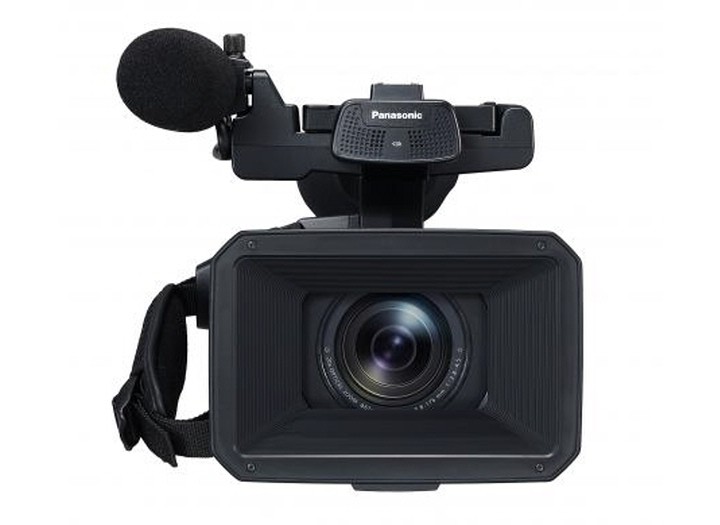

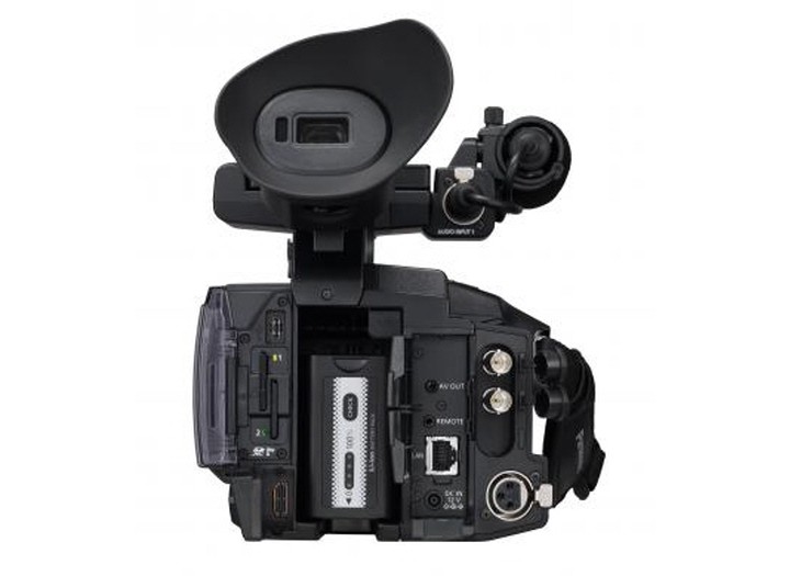

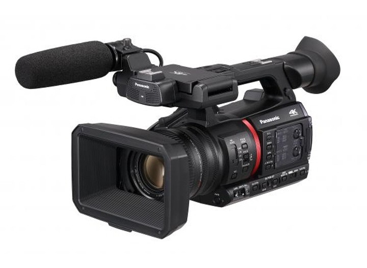

    CAMERA 4K Handheld Camcorder
    Model AG-CX350
    주요사양 New 1.0” 15M Sensor brings 2000TV-lines and F12/F13 Sensitivity.
    주요사양 Superb 4K Image with 10bit Codec
    주요사양 Supporting HLG (Hybrid Log Gamma) and SDR Monitoring
    주요사양 Industry’s Widest Class Lens with 32x Intelligent Zoom and 5-Axis Hybrid I.S.
    주요사양 HD Live Streaming to Connect Directly to Facebook and YouTube Live

    VIDEO OUTPUT-
    Video Output | SDI OUTBNC x 1, SDI REC REMOTE supported
    HD: 0.8 V [p-p], 75 Ω SD: 0.8 V [p-p], 75 Ω, Output format (4:2:2 10 bit):
    ・1920 × 1080: 59.94p, 50p, 59.94i, 50i, 29.97Psf, 25Psf, 23.98PsF
    ・1280 × 720: 59.94p, 50p
    ・720 × 480: 59.94i
    ・720 × 576: 50i
    Video Output | HDMI OUTHDMI x 1, Type A, HDMI REC REMOTE supported, VIERA Link not supported
    ・3840 × 2160: 59.94p, 50p, 29.97p, 25p, 23.98p
    ・1920 × 1080: 59.94p, 50p, 59.94i, 50i, 29.97p, 25p, 23.98p
    ・720 × 480: 59.94p
    ・720 × 576: 50p
    VIDEO OUT3.5 mm diameter mini jack, composite 1.0 V [p-p], 75 Ω
    Audio Input/Output-
    Built-in microphoneStereo microphone
    INPUT 1/2XLR (3-pin) x 2 (INPUT1, INPUT2)
    Input high impedance, LINE/MIC/MIC+48V (switchable SW)
    MIC: -40 dBu/-50 dBu/-60 dBu (switchable menu)
    LINE: +4 dBu/0 dBu (switchable menu)
    Audio Input/Output | SDI OUTLinear PCM 2 ch
    Audio Input/Output | HDMI OUTLinear PCM 2 ch
    Headphone3.5 mm diameter stereo mini jack x 1
    AV OUT3.5 mm diameter stereo mini jack x 1, Output level: 600 Ω, 316 mV
    Speaker20 mm diameter, round x 1
    OTHER INPUT/OUTPUT-
    TC IN/OUTBNC x 1,
    Used as the input and output terminals (switchable menu)
    Input: 1.0 V to 4.0 V [p-p] 10 KΩ
    Output: 2.0 V ± 0.5 V [p-p] low impedance
    2.5 mm diameter super mini jack
    REMOTE2.5 mm diameter super mini jack
    LANRJ-45: 1000BASE-T/100BASE-TX/10BASE-T
    USB 2.0 HOSTType-A, 4-pin (5 V, 0.5 A) for Wireless Module (option)
    USB 3.0 DEVICEUSB 3.1 GEN1 Type-C, USB Mass storage function
    No USB bus power function
    DC IN 12VDC 12 V EIAJ Type 4
