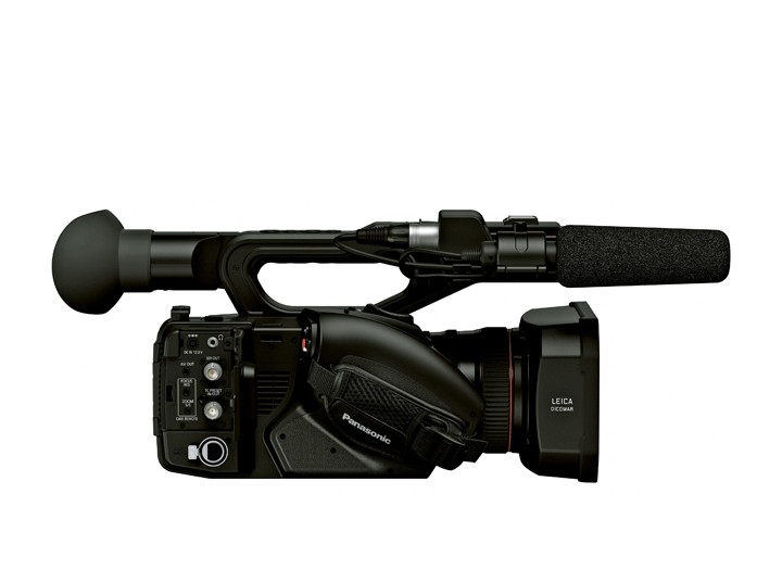

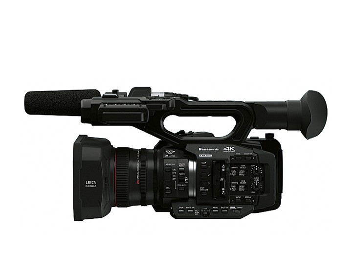

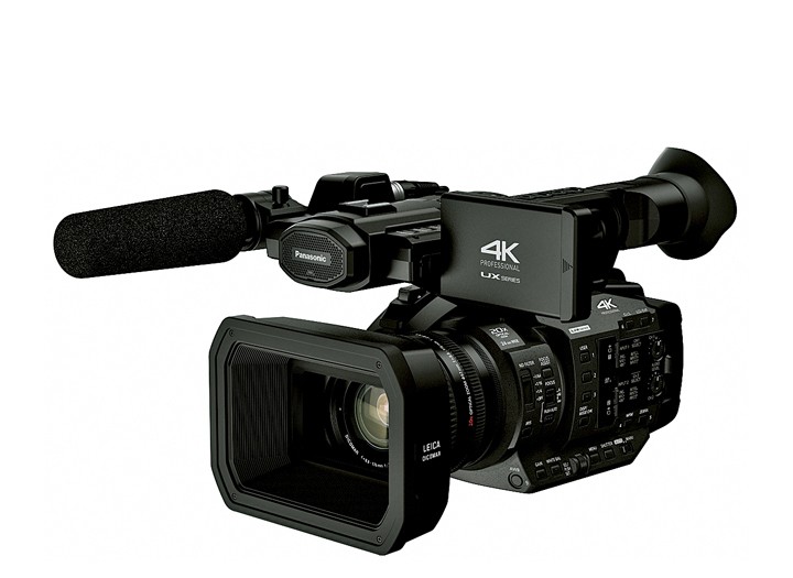

    CAMERA AG-UX180 4K Premium Professional Camcorder
    모델 AG-UX180
    주요사양 1.0
    주요사양 4K 24P, UHD 60p/50p/30p/25p/24p
    주요사양 UHD/FHD Dual Codec Recording
    주요사양 8.8 to 176mm 20x Optical Zoom with OIS
    주요사양 3 x Manual Lens Control Rings
    주요사양 Dual Codec Recording in UHD/FHD
