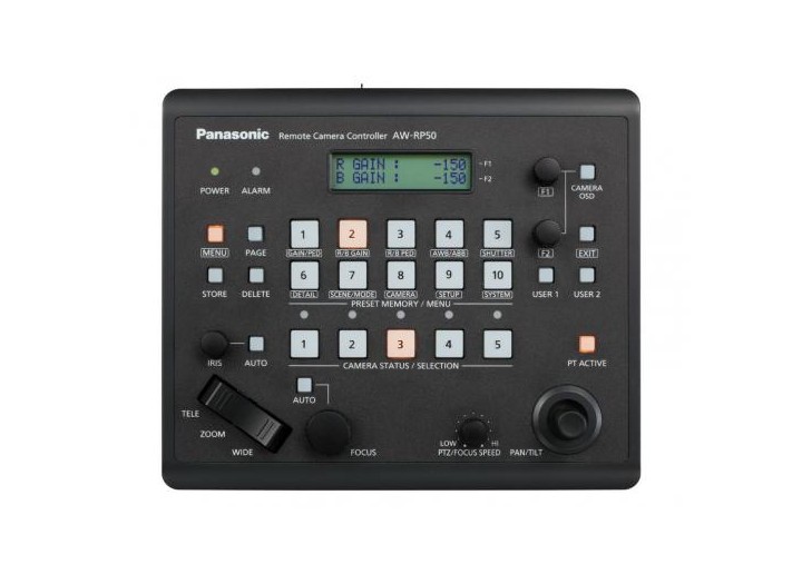

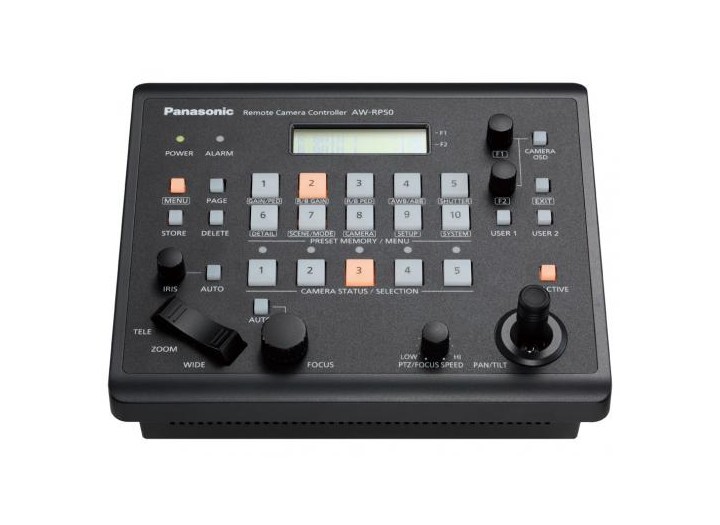

    PTZ CAMERA Remote Camera Controller
    Model AW-RP50
    주요사양 Up to 5 cameras/pan-tilt heads may be controlled via serial connection
    주요사양 Multi-control Up to 5 AW-RP50 can simultaneously control one remote camera unit
    주요사양 Up to 100 pre-set memories are available per camera
    주요사양 Up to 100 remote camera units may be controlled via IP and Ethernet hubs
    주요사양 Various settings can be configured from a PC (configuration software supplied)
    Power supplyDC 12 V ±10 % (AC adapter provided)
    Power consumption0.5 A (With DC1 2V)
    WeightApprox. 1.1 kg (Approx.2.4 lbs)
    Dimensions (W x H x D)210 mm x 67 mm x 177 mm (8-1/4 inches x 2-9/16 inches x 6-15/16 inches) (excluding protrusions)
    AccessoryAC Adaptor, Power cable

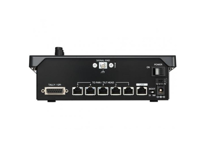

    ProtocolIPv4, RS-422 ( Panasonic AW series protocol)
    LAN10BASE-T/100BASE-TX (for IP control)RJ45 x 1
    Operating temperature0 °C to 40 °C
    Operating humidity10 % to 90 % ( no condensation)
    ConnectionIP : 1
    Adjustment functionsPan/Tilt, Zoom, Focus, Iris, Gain, Pedestal, Shutter, Detail,White Balance ( Auto, R/B Gain), Black Balance ( Auto, R/B Pedestal), Switch scene files
    Preset MemoryUp to 100 sets
    Switcher supportedAW-HS50
    LinkageCamera information display, Tally information imported, Bus material selection (AUX/PVW/PinP/KEY-F), Parameter Changes ( Pan/Tilt lever, Zoom button)
    T0 Pan/Tilt HeadRS-422 (for Serial control)/RJ45 x 5
    TALLY/GPITALLY INPUT x 5 channels GPI INPUT x 4 channels GPI OUTPUT x 4 channels/D-sub 15 pin (female) x 1
