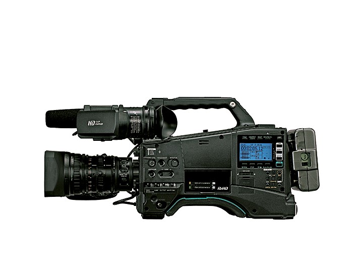

    SPECS
    Panasonic AJ-PX800 Specs
    Image Sensor3 x 2/3" 2.2MP MOS sensors
    Effective resolution: 2.2MP
    Horizontal ResolutionMinimum 1000 TV Lines at Center
    Lens Mount System2/3" Bayonet
    SensitivityNORMAL
    1080/59.94i: F9 (2000 lx, 3200 K, 89.9% reflection)
    1080/50i: F10 (2000 lx, 3200 K, 89.9% reflection)
    HIGH SENS
    1080/59.94i: F12 (2000 lx, 3200 K, 89.9% reflection)
    1080/50i: F13 (2000 lx, 3200 K, 89.9% reflection)
    Minimum Subject IlluminationApprox. 0.22 lx (HIGH SENS MODE, F1.4, +42 dB (S.GAIN))
    S/N RatioImage
    62 dB (standard)
    Shutter Speed60i/60p mode: 1/60 (OFF), 1/100, 1/120, 1/250, 1/500, 1/1000, 1/2000
    30p mode: 1/30 (OFF), 1/50, 1/60, 1/120, 1/250, 1/500, 1/1000
    24p mode: 1/24 (OFF), 1/50, 1/60, 1/120, 1/250, 1/500, 1/1000
    50i/50p mode: 1/50 (OFF), 1/60, 1/120, 1/250, 1/500, 1/1000, 1/2000
    25p mode: 1/25 (OFF), 1/50, 1/60, 1/120, 1/250, 1/500, 1/1000
    Synchro Scan60i/60p mode: 1/60.0 to 1/250.0
    30p mode: 1/30.0 to 1/250.0
    24p mode: 1/24.0 to 1/250.0
    50i/50p mode: 1/50.0 to 1/250.0
    25p mode: 1/25.0 to 1/250.0
    Slow Shutter Speed60i/60p mode: 1/15, 1/30
    30p mode: 1/15
    24p mode: 1/12
    50i/50p mode: 1/12.5, 1/12.5
    25p mode: 1/12.5
    Shutter Opening Angle3.0 to 360.0° (in 0.° steps)
    GainNORMAL
    -3, 0, 3, 6, 9, 12, 15, 18, 21, 24, 27, 30 dB
    HIGH SENS
    -6. -3, 0, 3, 6, 9, 12, 15, 18, 21, 24, 27, 30 dB
    Super Gain
    30, 36, 42 dB
    ND FiltersClear, 1/4, 1/16, 1/64
    LCD Display4.3", 1.15MP
    Viewfinder0.45", 1.22MP
    Recording
    Recording Media2 x P2 Card
    Video CodecsMPEG-2 Long GOP (HD)
    AVCHD progressive
    H.264
    File FormatsMOV (HD/SD/Web)
    MP4 (XDCAM EX)
    MTS (AVCHD progressive)
    MXF
    Recording ModesNTSC Setting
    MPEG-2 Long GOP
    HQ Mode:
    1920 x 1080 /59.94i/29.97p/23.98p
    1440 x 1080 /59.94i
    1280 x 720 /59.94p/29.97p/23.98p
    SP Mode:
    1440 x 1080 /59.94i
    1280 x 720 /59.94p
    AVCHD
    Progressive mode (28 Mbps): 1920 x 1080 /59.94p
    HQ mode (24 Mbps): 1920 x 1080 /59.94i
    SP mode (17 Mbps): 1920 x 1080 /59.94i
    LP mode (9 Mbps): 1440 x 1080 /59.94i
    EP mode (5 Mbps): 1440 x 1080 /59.94i
    H.264 (HD)
    XHQ mode (50 Mbps): 1920 x 1080 /59.94p/59.94i/29.97p/23.98p
    UHQ mode (35 Mbps): 1920 x 1080 /59.94i/29.97p/23.98p
    H.264 (SD)
    720 x 480 /59.94
    H.264 (Web)
    HQ mode (3 Mbps): 960 x 540 /29.97p/23.98p
    LP mode (1.2 Mbps): 480 x 270 /29.97p/23.98p
    PAL Setting
    MPEG-2 Long GOP
    HQ Mode:
    1920 x 1080 /50i/25p/2p
    1440 x 1080 /50i
    1280 x 720 /50p
    SP Mode:
    1440 x 1080 /50i
    1280 x 720 /50p
    AVCHD
    Progressive mode (28 Mbps): 1920 x 1080 /50p
    HQ mode (24 Mbps): 1920 x 1080 /50i
    SP mode (17 Mbps): 1920 x 1080 /50i
    LP mode (9 Mbps): 1440 x 1080 /50i
    EP mode (5 Mbps): 1440 x 1080 /50i
    H.264 (HD)
    XHQ mode (50 Mbps): 1920 x 1080 /50p/50i/25p
    UHQ mode (35 Mbps): 1920 x 1080 /50i/25p
    H.264 (Web)
    HQ mode (3 Mbps): 960 x 540 /25p
    LP mode (1.2 Mbps): 480 x 270 /25p
    Sampling FrequencyAVC-Intra100/AVC-LongG50/AVC-LongG25/AVC-LongG12/DVCPRO HD
    Y: 74.1758 MHz, PB/PR: 37.0879 MHz (59.94 Hz)
    Y: 74.2500 MHz, PB/PR: 37.1250 MHz (50 Hz)
    DVCPRO50
    Y: 13.5 MHz, PB/PR:6.75 MHz
    DVCPRO
    Y: 13.5 MHz, PB/PR: 3.375 MHz
    Quantizing10 bit: AVC-Intra100/AVC-Intra50/AVC-LongG50/AVC-LongG25
    8 bit: AVC-LongG12/DVCPRO HD/DVCPRO50/DVCPRO/DV
    ProxyVideo Compression Format
    H.264/AVC Baseline Profile, H.264/AVC High Profile
    Audio Compression Format
    AAC-LC, Linear PCM
    Approximate Recording Times per GB
    AVC-G6 2CH MOV: Approx. 13 min
    SHQ 2CH MOV: Approx. 25 min
    HQ 2CH MOV: Approx. 78 min
    LOW 2CH MOV: Approx. 135 min
    Audio RecordingAVC-Intra100/AVC-Intra50: 48 kHz/16 bit, 4CH and 48 kHz/24 bit, 4CH switch
    AVC-LongG50/AVC-LongG25: 48 kHz/24 bit, 4CH
    AVC-LongG12/DVCPRO HD/DVCPRO50/DVCPRO/DV: 48 kHz/16 bit, 4CH
    HeadroomAudio: 18 dB/20 dB (switchable with menu)
    Interface
    Inputs/OutputsVideo
    Genlock In
    1 x BNC (1.0 V [p-p], 75 Ω)
    Timecode In/Out Switchable
    In: 1 x BNC (0.5 V [p-p] to 8 V [p-p], 10 kΩ)
    Out: 2.0 ±0.5 V [p-p], Low impedance
    SDI In/Out
    SD/HD-SDI: 1 x BNC 0.8 V [p-p], 75 Ω (Input is an Option and not included)
    HDMI
    Out: 1 x HDMI type A terminal (not compatible with VIERA Link)
    Monitor Out
    Switchable to SD/HD-SDI/analog compsite on Smart UI
    1.5 G HD-SDI: 0.8 V [p-p], 75 Ω
    SD SDI: 0.8 V [p-p], 75 Ω
    Composite: 1.0 V [p-p], 75 Ω
    Audio
    In: 2 x 3-pin XLR (Line / Mic switch selectable) +48 V supported (selectable menu) −40 dBu/−50 dBu/−60 dBu (selectable menu)
    Out: 2 x RCA Jack (channel 1, channel 2, Output level: 600 Ω, 316 mV)
    Wireless
    In: 25 pin, D-SUB, −40 dBu, 2CH supported
    Headphones
    1 x 3.5 mm stereo mini jack
    Speaker
    1 x Round 20 mm diameter
    DC
    In: 1 x 4-pin XLR DC 12 V (DC 11.0 V to 17.0 V)
    Out: 1 x 4-pin XLR DC 12 V (DC 11.0 V to 17.0 V), maximum output current 1.5 A
    Remote
    10-pin
    Lens
    12-pin
    VF
    20-pin
    LAN
    1 x RJ-45 100BASE-TX/10BASE-T
    USB
    USB2.0 (host): Type A connector, 4 pin
    USB2.0 (device): Type B connector, 4 pin
    USB2.0 (sub host): Type A connector, 4 pin (exclusively for wireless module AJ-WM30)
    General
    Operating Temperature32 to 104°F (0 to 40°C)
    Operating Humidity35 to 80%
    Storage Temperature14 to 122°F (-20 to 50°C)
    Storage HumidityUnder 85%
    Power12 VDC (10.5 to 17V)
    Power ConsumptionApprox. 28 W
    Dimension L x W x H20.5 x 9.1 x 9.5" (521.0 x 231.0 x 242.3 mm)
    WeightWithout Battery: Approx. 8.9 lb (4.0 kg)
    With Battery: Approx. 10.6 lb (4.8 kg)
