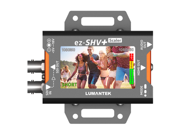

    ETC CONVERTER WITH DISPLAY
    Model ez-SHV+
    제조사 루먼텍(Lumantek)
    주요사양 Analog Audio(Stereo) 출력을 지원
    주요사양 2.7inch TFT-LCD를 통해 입력 영상 Display
    주요사양 입력 Eye Pattern 측정, 입출력 해상도 Display, 대략적인 입력 케이블 길이를 측정
    주요사양 Input SDI 1개, Output HDMI 1
    주요사양 SDI to HDMI with Scaler Converter
    Data Input
    SDI Video Input: SD/HD/3G-SDI (BNC 75Ω) x1
    Video Formats
    - 720x480i@59.94/60
    - 720x576i@50
    - 1280x720p@50/59.94/60
     - 1920x1080i@50/59.94/60
    - 1920x1080p@23.94/24/25/29.97/30
    - 1920x1080p@50/59.94/60 (3G-SDI Level-B not supported)
    Data Output
    SDI LOOP Output: SD/HD/3G-SDI (BNC 75Ω) x1
    Audio Output: Stereo Jack x1HDMI
    Video Output: SD/HD/3G(HDMI Type A) x1
    Video Formats:- 720x480i@59.94 (DIP SW : 1111)
    - 720x576i@50 (DIP SW : 0111)
    - 1280x720p@50 (DIP SW : 1011)
    - 1280x720p@59.94 (DIP SW : 0011)
    - 1280x720p@60 (DIP SW : 1101)
    - 1920x1080i@50 (DIP SW : 0101)
    - 1920x1080i@59.94 (DIP SW : 1001)
    - 1920x1080i@60 (DIP SW : 0001)
    - 1920x1080p@23.98 (DIP SW : 1110)
    - 1920x1080p@24 (DIP SW : 0110)
    - 1920x1080p@25 (DIP SW : 1010)
    - 1920x1080p@29.97 (DIP SW : 0010)
    - 1920x1080p@30 (DIP SW : 1100)
    - 1920x1080p@50 (DIP SW : 0100)
    - 1920x1080p@59.94 (DIP SW : 1000)
    - 1920x1080p@60 (DIP SW : 0000)
    Connections
    Power : DC Power Input (DC Jack) x1
    DIP Switch : (6 Pole) x1 Video In/Out Resolution,Video Output Ratio, LCD Brightness
    MODE : (Push Switch) x1 LCD ON/OFF, MenuSelection
    Display
    2.7 inch TFT LCD : Input Video Display, Input SDIEye Pattern,In/Output Video Resolution Display,Input Cable Length
    Electrical
    Power Input: DC +5V to +18V
    Power Consumption: 3W(max.)
    Operation Temperature: 0~45℃
    Physical
    Dimension: 86.3x57.2x26.6 (include connector)
    Weight: 0.3 kg(typ.)
