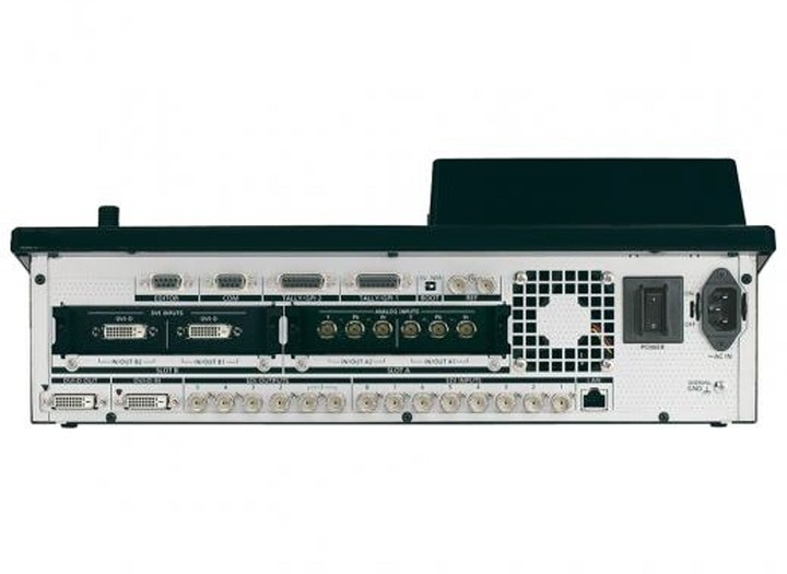

    Video Terminal-
    Video Outputs (10 signal lines, maximum)Standard SDI: 5 signal lines BNC x 6 (SDI OUTPUT 1 to SDI OUTPUT 5 x 1 line each,
    2 distributed outputs for SDI OUTPUT 1 only)
    Standard DVI-D: 1 signal line DVI-D x 1
    Optional: Up to 4 additional lines (OUT A1, OUT A2, OUT B1, OUT B2) (Up to two option boards can be installed in the two input/output slots.)
    • PGM, PVW, AUX1 to AUX4, MV (MULTI_VIEW), CLN, KEYOUT and MEM PVW can be assigned to SDI OUTPUT 1 to SDI OUTPUT 5, DVI-D, OUT, OUT A1, OUT A2, OUT B1 and OUT B2.

    Video Inputs (13 signal lines, maximum)Standard SDI: 8 signal lines BNC x 8 (SDI INPUT 1 to SDI INPUT 8)
    • The up-converter function can be used for the SDI INPUT 5 to SDI INPUT 8 connectors.
    Optional: Up to 4 additional signal lines (IN A1, IN A2, IN B1, IN B2) (Up to two option boards can be installed in the two input/output slots.)

    LANRJ-45 x 1
    10BASE-T/100BASE-TX (For IP control)

    EDITORD-sub, 9-pin, female
    Used to control an editor

    COMD-sub, 9-pin, female
    Used to control an external device
    RS-422 control connector

    Reference Input/OutputIn gen-lock mode: Black burst or Tri-level Sync input signals (with loop-through)
    In internal sync mode: Black burst output signals x 2

    TALLY/GPI 1, TALLY/GPI 2D-sub, 15-pin, female ( x 2)
    Input: 8 inputs, general-purpose, photocoupler sensing
    Output: 19 outputs; selected from R/G tally, general-purpose
    Alarm: 1 output, open collector output (negative logic)
