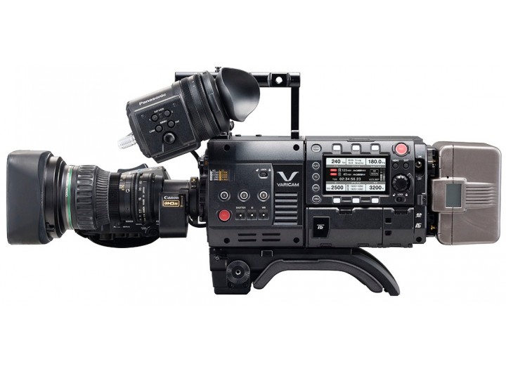

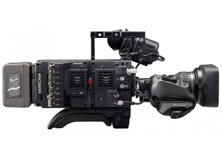

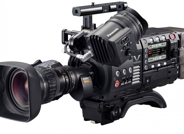

    CAMERA VariCam HS Specifications
    General Combination of AU-V23HS1G and AU-VREC1G
    Camera Module AU-V23HS1G
    Recording Module AU-VREC1G
    General (Combination of AU-V23HS1G and AU-VREC1G)
    PowerDC 12 V(11.0 V – 17.0 V)
    Power Consumption60 W (Body only)
    90 W (with all optional accessories connected and maximum power supplied
    from each output terminal)
    Operating Temperature0°C to 40°C
    Operating Humidity10% to 85% (relative humidity)
    Storage Temperature−20°C to 60°C
    WeightApprox. 4.5 kg (Excluding protrusion)
    Dimensions (W x H x D)179 mm × 230.5 mm × 347 mm
    (7-1/16inches x 9-1/16inches x 13 -21/32inches) (Body only, excluding protrusion)
    Camera Module (AU-V23HS1G)
    Pickup Device2/3-type 2.2 million pixels, MOS × 3
    Lens Mount2/3-type bayonet
    Optical filterCC filter A: 3200 K, B: 4300 K, C: 5600 K, D: 0.3ND
    ND filter 1: CLEAR, 2: 0.6ND, 3: 1.2ND, 4: 1.8ND
    Gain Settings[ISO] mode: ISO 2500 to 12800
    [dB] mode : 0 to 18 dB (3dB step)
    Shutter speed[deg] mode: 1.0 to 360deg (0.5deg step)
    [sec] mode: 1/24 to 1/250 (when 23.98p mode)
    Sensitivity[Gamma: HD] mode:
    F9 (2000 lx, 3200 K, 89.9% reflection, 1080/59.94p)
    F10 (2000 lx, 3200 K, 89.9% reflection, 1080/50p)
    Holizontal Resolution1000 TVlines or higher (center)
    Recording Module (AU-VREC1G) When it is used with AU-V23HS1G
    Memory Card Recorder
    Recording MediaexpressP2 card, P2 card, microP2 card
    Recording Resolution1920×1080, 1280×720
    Recording FramerateMaximum 240p/200p
    System Frequency59.94p, 50p, 29.97p, 25p, 23.98p, 59.94i, 50i
    Recording FormatMain Recorder: AVC-Intra444/AVC-Intra200/AVC-Intra422/AVC-Intra100/
    ProRes422HQ/ProRes4444
    Sub Recorder: AVC-Intra422/AVC-Intra100, AVC-LongG50, AVC-LongG25
    Recording Video Signal1080/59.94p, 50p, 29.97p, 25p, 23.98p, 59.94i, 50i 720/59.94p, 50p
    Recording/Playback time (Main Codec)
    (When expressP2 card 256 GB is used)*2
    Approx. 128 min. (AVC-Intra100, VFR OFF)
    Approx. 32 min. (AVC-Intra100, VFR ON, 200 fps/240 fps)
    Approx. 60 min. (ProRes 422 HQ, VFR:ON, 60 fps)
    Approx. 110min. (ProRes 4444, VFR:OFF, 24p)
    Recording/Playback time (Sub Codec)
    (When microP2 card 64GB is used)*2
    Approx. 64 min. (AVC-Intra100, 25p/29.97p)
    Approx. 128 min. (AVC-LongG50, 25p/29.97p)
    Approx. 256 min. (AVC-LongG25, 25p/29.97p)
    Digital Video
    Quantizing10 bit
    Video Compression FormatAVC-Intra422/AVC-Intra 100: MPEG-4 AVC/H.264 Intra Profile
    AVC-LongG 50/AVC-LongG 25: MPEG-4 AVC/H.264
    ProRes 422 HQ/ProRes4444
    Digital Audio
    Recording Audio Signal48 kHz/24 bit, 4ch
    Head room 18 dB/20 dB menu switchable
    Proxy
    File FormatMOV
    Video Compression FormatH.264/AVC High Profile
    Audio Compression FormatLPCM
    Recording Time (1GB)*2Approx.25 min.
    Video Input/Output
    SDI OUTHD (1.5G)/3G SDI: 0.8 V[p-p], 75 Ω (1 set, 4 pieces)
    MON OUT1HD (1.5G)/3G SDI: 0.8 V[p-p], 75 Ω
    MON OUT2HD (1.5G)/3G SDI: 0.8 V[p-p], 75 Ω
    VF SDIHD (1.5G)/3G SDI: 0.8 V[p-p], 75 Ω
    Audio Input/Output
    AUDIO IN: (CH1/CH2)XLR x 2, 3 pin, LINE/MIC/MIC+48V/AES switchable
    MIC INXLR x 1, 5 pin
    PHONESStereo mini jack
    Speaker20 mm diameter, round x 1
    Other Input/Output
    GENLOCK INHD(1.5G)/3G-SDI: 0.8 V[p-p], 75 Ω
    TC IN/OUTBNC×1, IN/OUT switch selection
    IN: 0.5 V[p-p] to 8 V[p-p], 10 kΩ
    OUT: 2.0 ± 0.5 V[p-p], Low impedance
    DC INXLR 4 pin, DC12 V(DC11.0 V to 17.0 V)
    DC OUT/RS4 pin, DC12 V (DC11.0 V to 17.0 V),
    maximum output current 1.0 A
    DC OUT2 pin, DC12 V (DC11.0 V to 17.0 V),
    LENS12 pin
    VF14 pin
    LAN100BASE-TX/10BASE-T
    USB2.0: (device)Type B connector, 4 pin
    USB2.0: (host)Type A connector, 4 pin
    Control Panel (LCD)3.5-type QHD color monitor
    (Approx. 1.56 million dots)
