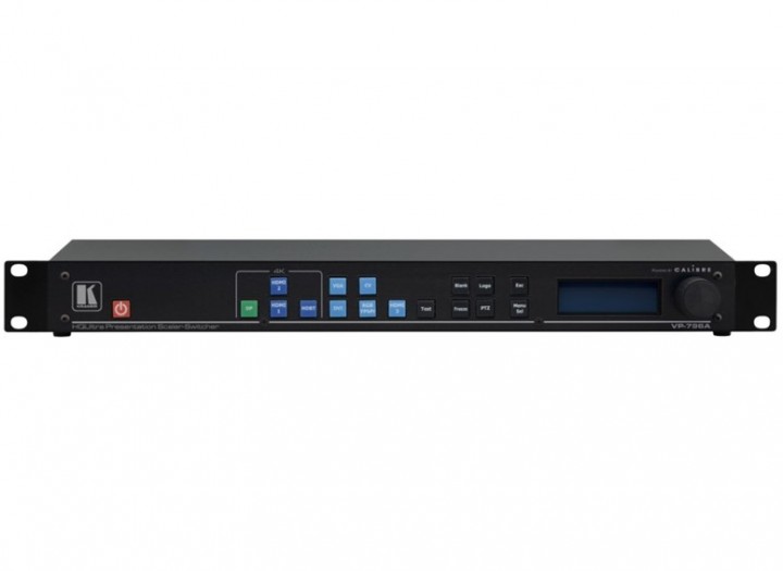

    ETC Live Event Presentation System
    Model VP-796A
    제조사 크라머(Kramer)
    주요사양 HQUltraFast 스위칭 — 스위칭 시간 약 0.25초
    주요사양 HQ Ultra 스케일링 — Low–latency, 4K UHD 지원
    주요사양 해상도 — 최대 4K@60Hz (4 2 0) UHD
    주요사양 간편한 조작 — 전편패널 조그휠 및 LCD 창을 통한 설정
    주요사양 HDCP 호환

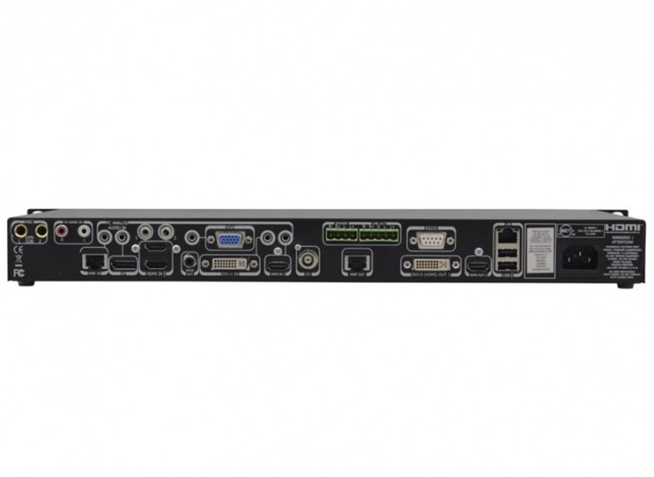

    비디오입력
    • 1 HDBT on an RJ–45 connector, 1 DisplayPort connector, 2 HDMI (4K UHD) connectors, 1 HDMI (HD) connector, 1 DVI–U (DVI/HDMI & VGA/RGBS/YPbPr), 1 VGA on a 15–pin HD connector, 1 CV on an RCA connector
    오디오입력
    • 2 microphones on 6mm mini jacks, 1 CV stereo on RCA connectors (R, L), 7 unbalanced stereo on 3.5mm jacks
    비디오출력
    • 1 HDBT on an RJ–45 connector, 1 HDMI connector, 1 DVI/HDMI on a DVI–I connector, 1 S/PDIF on an RCA connector
    오디오출력
    • Speaker on a 4–pin terminal block, line out on a 5–pin terminal block, S/PDIF on an RCA connector
    포트
    • 1 RS–232 on a 9–pin D–sub connector, 1 LAN on an RJ–45 connector, 2 USB–A connectors
